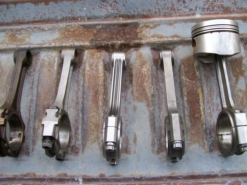

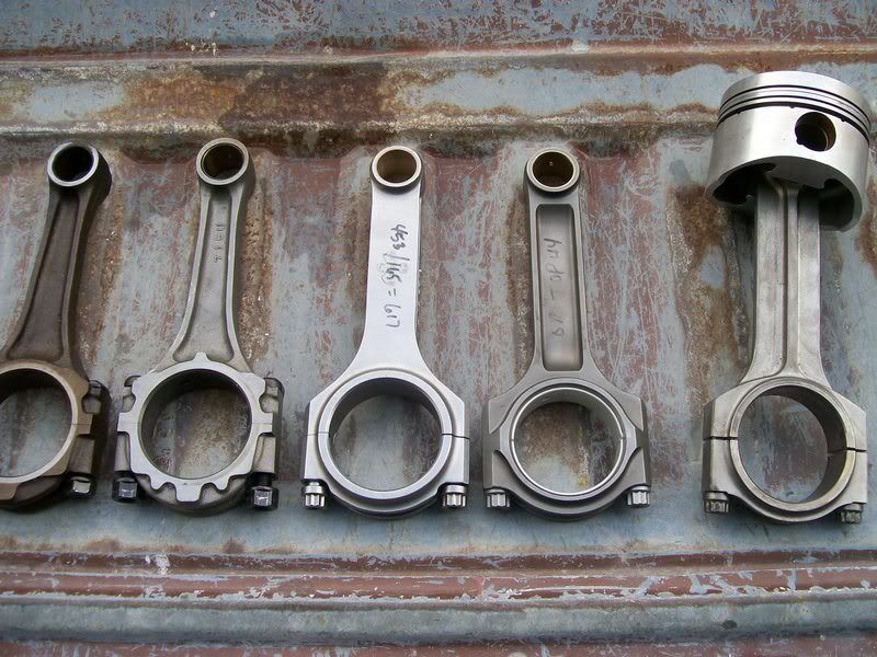

need new tires;1085766 said:
Shane, what are the end two rods? I am guessing the first two are Stock toyota, the third is Eagle H beam. one a crower? I like you pic. for referance so I am kind of interested in the end two.
