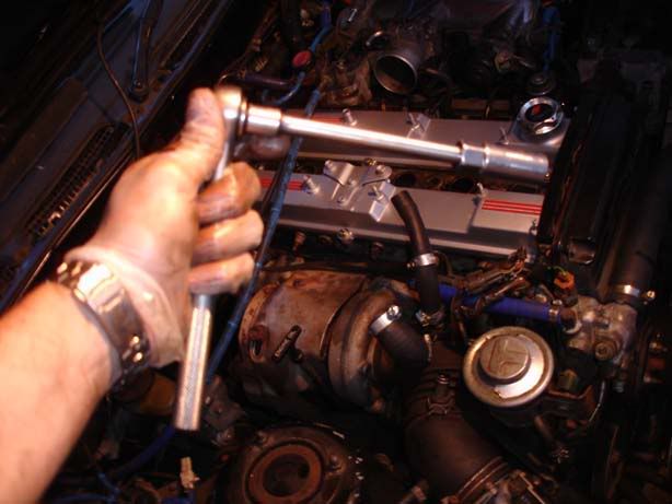

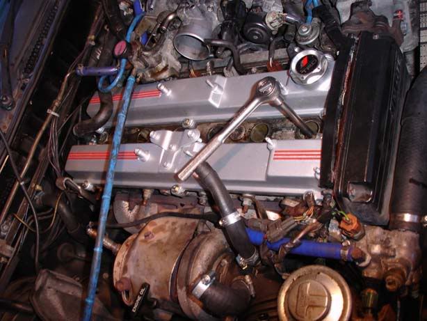

Step 2 - Get yourself an extension bar and the thin type spark plug remover (There are only two common types of plugs used and one is fatter than the other)
Step 3 - Loosten each plug completely and with draw them from the head
Step 4 - The worst thing you can do is thread the plug putting it back in. To avoid this, finger tighten each plug as shown in the picture. If it gives you any resistance try wiggling the extension bar a little as you turn it but don't apply too much force
Step 5 - Once all the plugs are finger tight, torque them up and put everything back together
