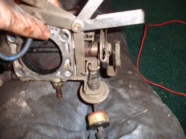

Step 3 - You should check thet the throttle stop (The little screw bit) is in contact with the throttle lever (The springy bit that gets pulled when you press the accelerator) when the accelerator is released. Note that I am moving the two apart so you can see which two bits I mean
![p1329274_2.jpg](https://www.supramania.com/images/pb_archive/p1329274_2.jpg)

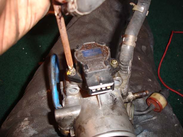

Step 4 - Disconnect the connector to the Throttle Position Sensor
![p1329274_3.jpg](https://www.supramania.com/images/pb_archive/p1329274_3.jpg)

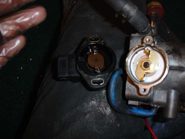

Step 5 - The 4 connections you see here for the TPS are E2, IDL, VTA and VC. You use the electrical resistance between these 4 pins to set up the sensor
![p1329274_4.jpg](https://www.supramania.com/images/pb_archive/p1329274_4.jpg)

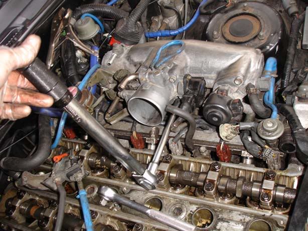

Step 7 - If you need to calibrate the throttle body then it needs to be removed from the car (you can't get to the bottom screw of the TPS without removing other components). Start by undoing the 4 bolts holding the throttle body to the inlet plenum
![p1329274_6.jpg](https://www.supramania.com/images/pb_archive/p1329274_6.jpg)

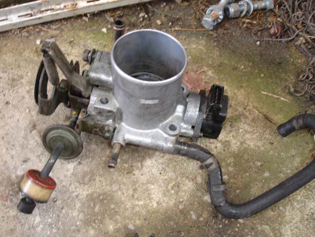

Step 10 - Remove the throttle body and take it somewhere warm to work (assuming it's thrashing it down with rain like when I did mine!)
![p1329274_10.jpg](https://www.supramania.com/images/pb_archive/p1329274_10.jpg)
