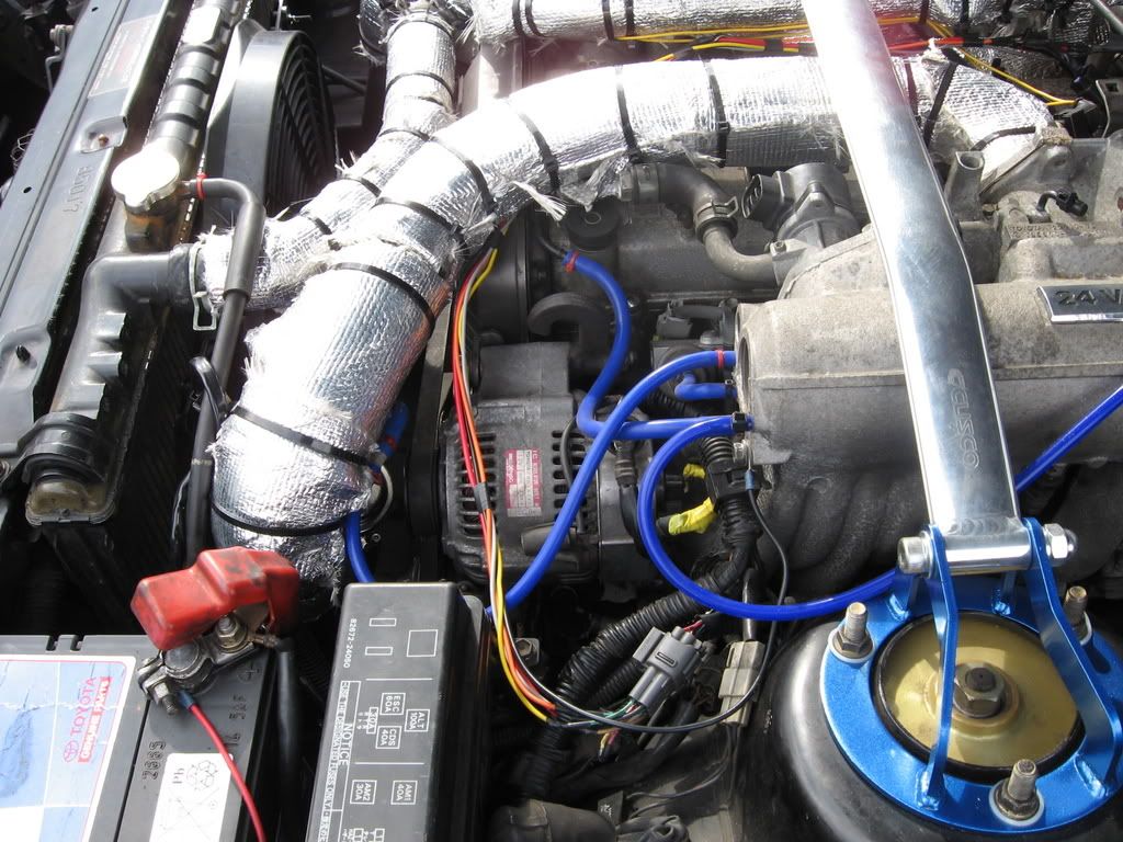

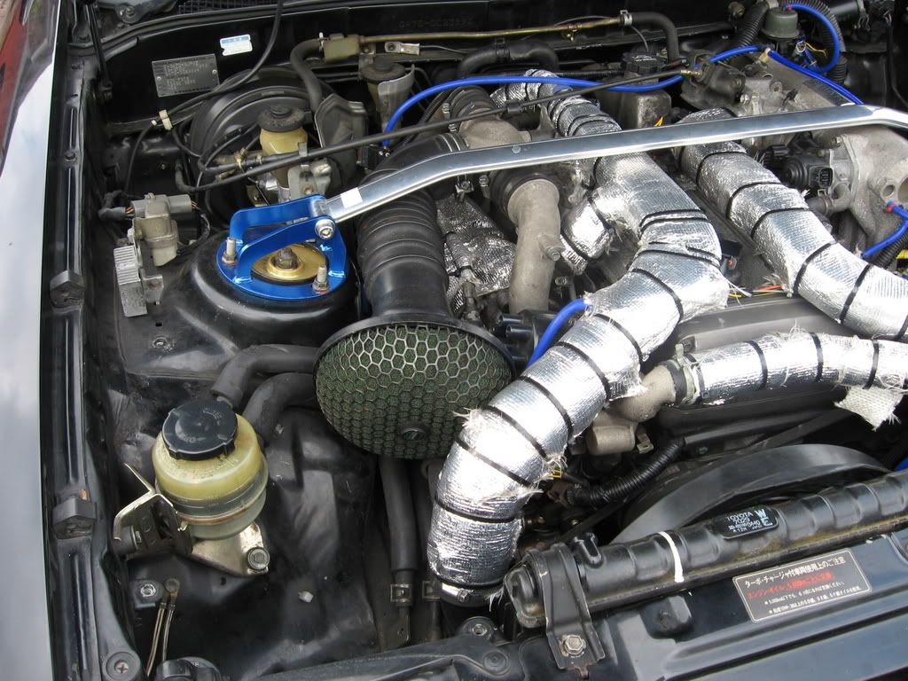

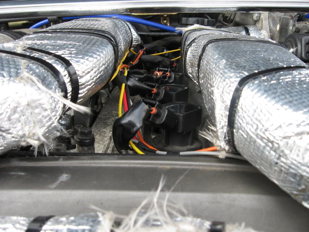

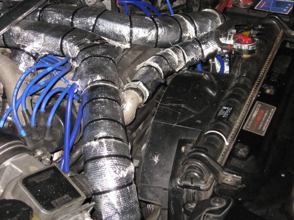

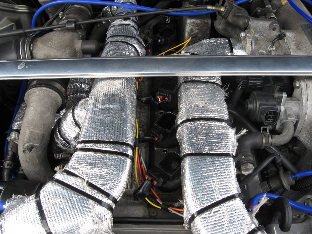

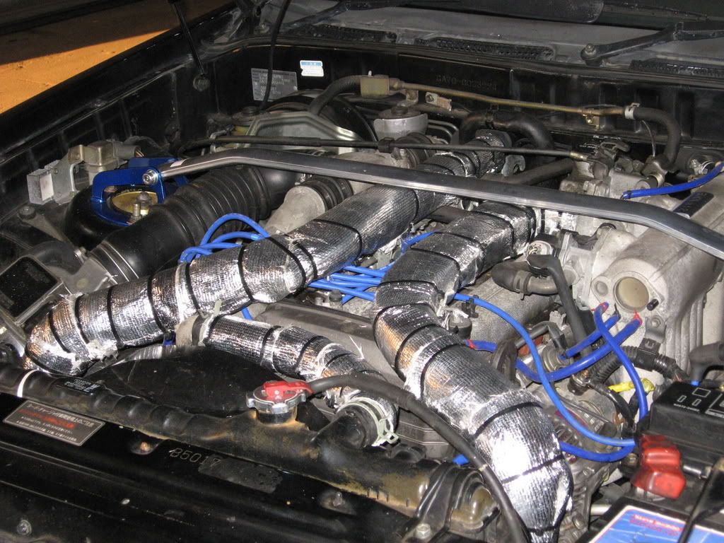

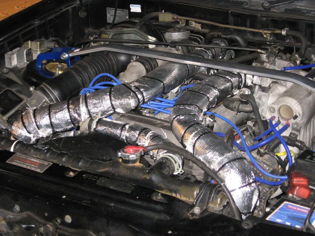

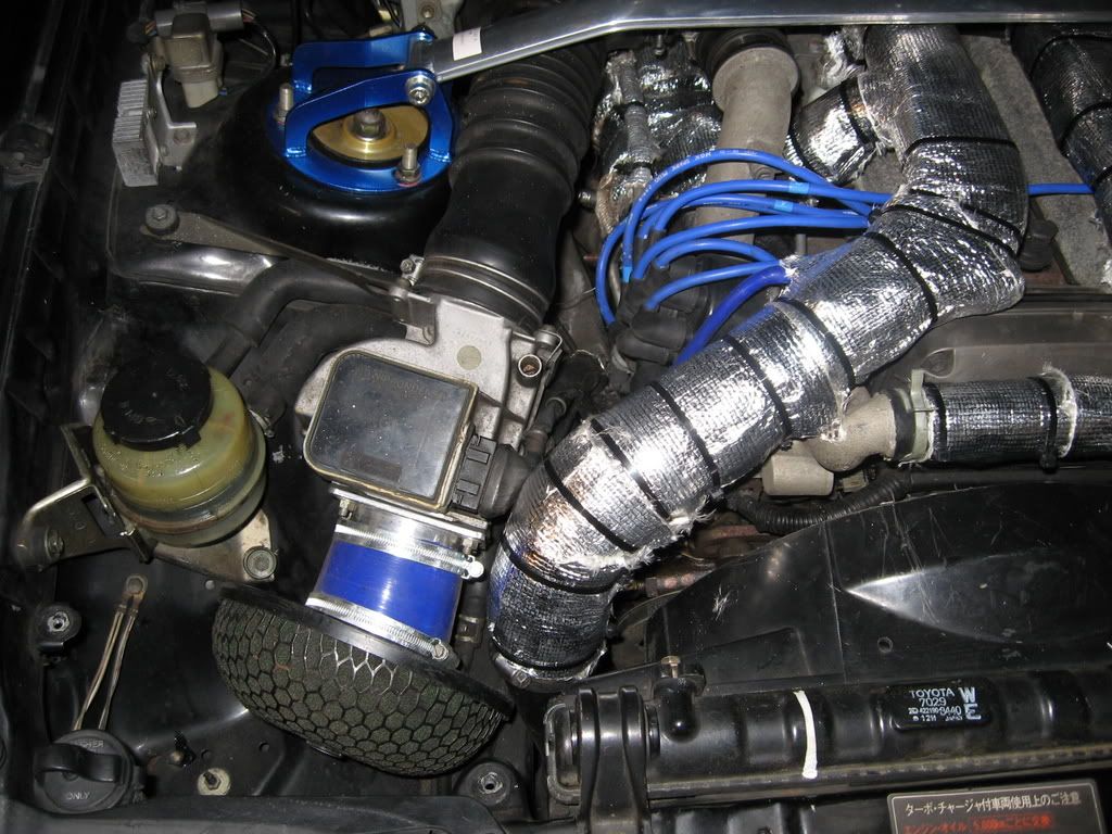

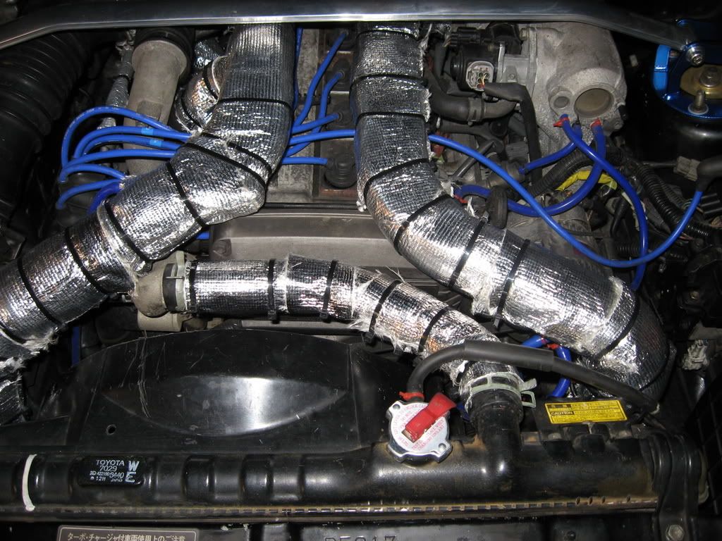

finished some more lagging today that heat wrap joe the inlet temps just keep getting lower the pick is far better again

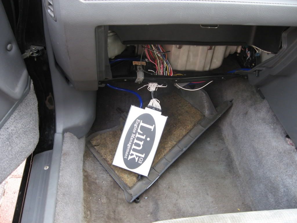

ok people had a slight change of plan here motec is for sale
why i hear you all ask
well because we have fitted a link g3 ecu instead
reasons being
well where do we start
1g-gte as i transpires is an odd ignition system
1 it has a twin arm rotor firing to 3 points in the dizzy cap
nothing to odd there you might say
this was all found out when it wouldnt fire on more than 3 by the way lol
2 we found out as wiring diagrams are limited on this engine doh that the coil has 3 inputs out puts bearing in mind that it is a single lead coil like the 7mge
this meaning instead of firing in 1 shot like a normal 7mge it fires in 2 batches of three and neither the motec or the link would run the configuration aggghhhhhhhh
so
we fitted 6 1uzz cop with combined ignitors :) and went with the link to fire in wasted spar on these as the motec only had 2 ignition out puts :(
but with a low boost of 15psi i would say we are making around 260rwhp so 300 flywheel is with no other mods done other than those listed at the beginning of this thread
pics to follow
ian feel free to tidy my punctuation and spelling mistakes up if you want lmao

Whats the weight difference between the 7m and the 1g? Also if you're making suspension parts for a 7m are you taking in the weight differential?

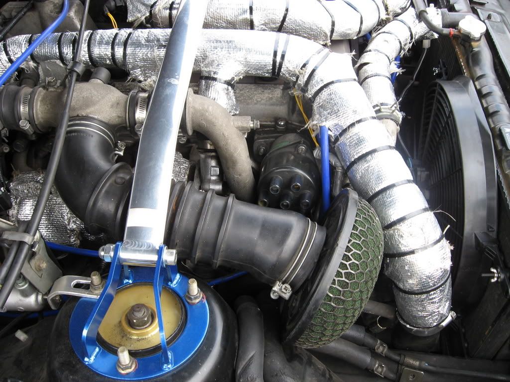

Another thing, How long do you think the rubber piping will last under all that heat wrap(lagging)?
group a supra
SPAWNING AN INTERCEPTOR
dirgle no not now it was a twin rotor dizzy firing in batches of three
now it has no dizzy at all we are just using it a a cps to run the cop ignitors :)
woundlicker
there is 1L diff 1g is 2.0
weight there is a bout a 100kg diffrerence so it has no massive effect as the chassis is the same its just a bit more nimble round the bends
the rubber piping should last longer as it is not being subjected to so much heat now

looking good, for a lil i forgot you were doin a standalone and was gonna say you left the spark plug wires off, but then i realized i was dumb and it all made sense
