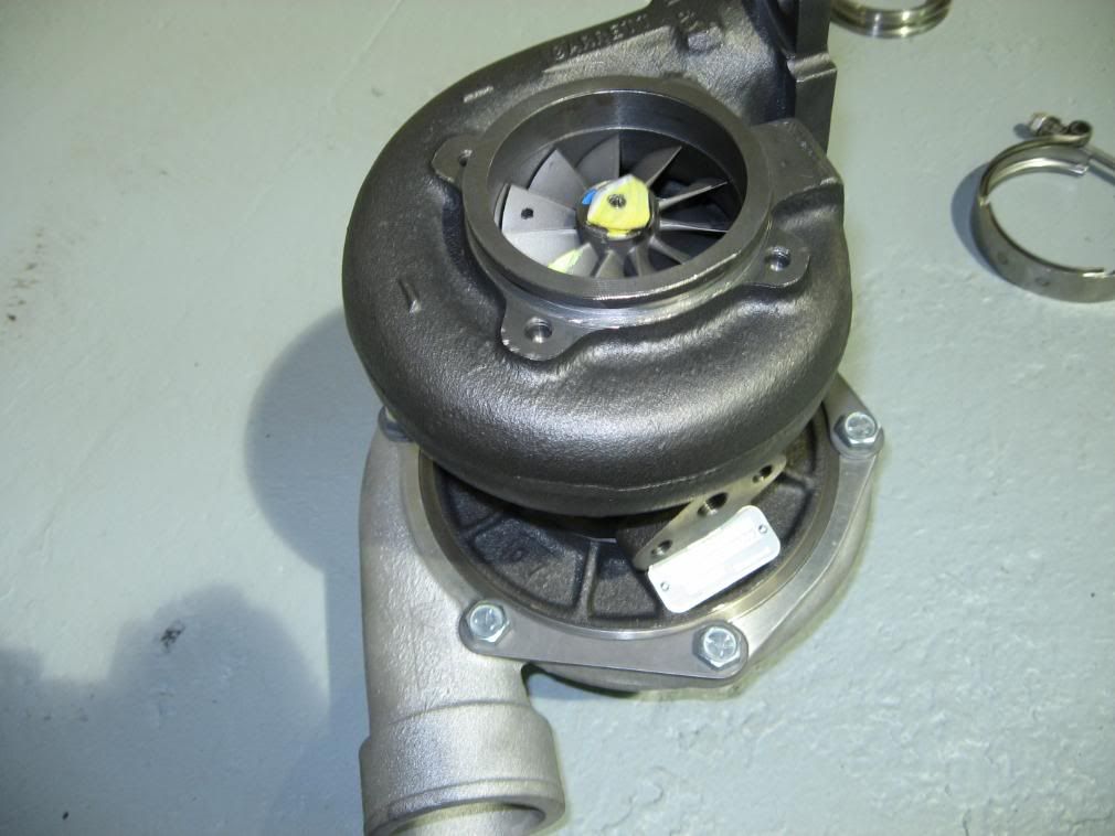

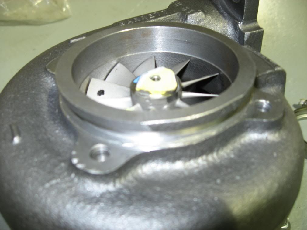

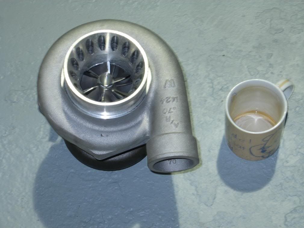

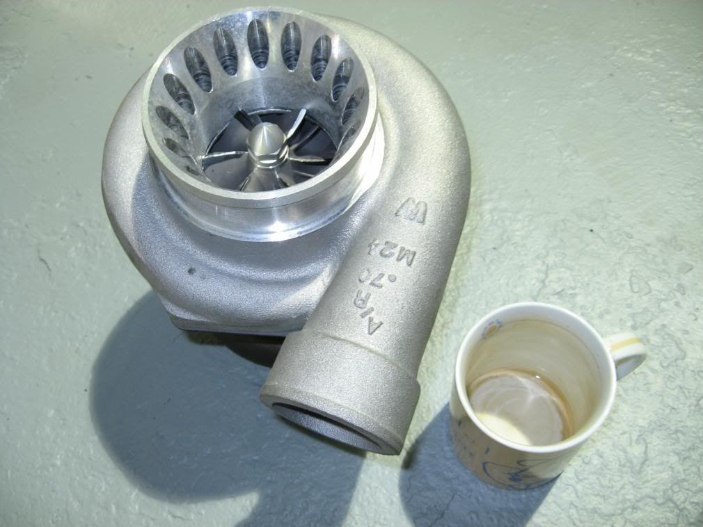

New T04Z pics with enhance punctuation for Ian.
The turbo Mug comparison

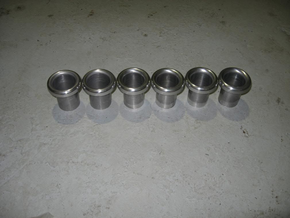

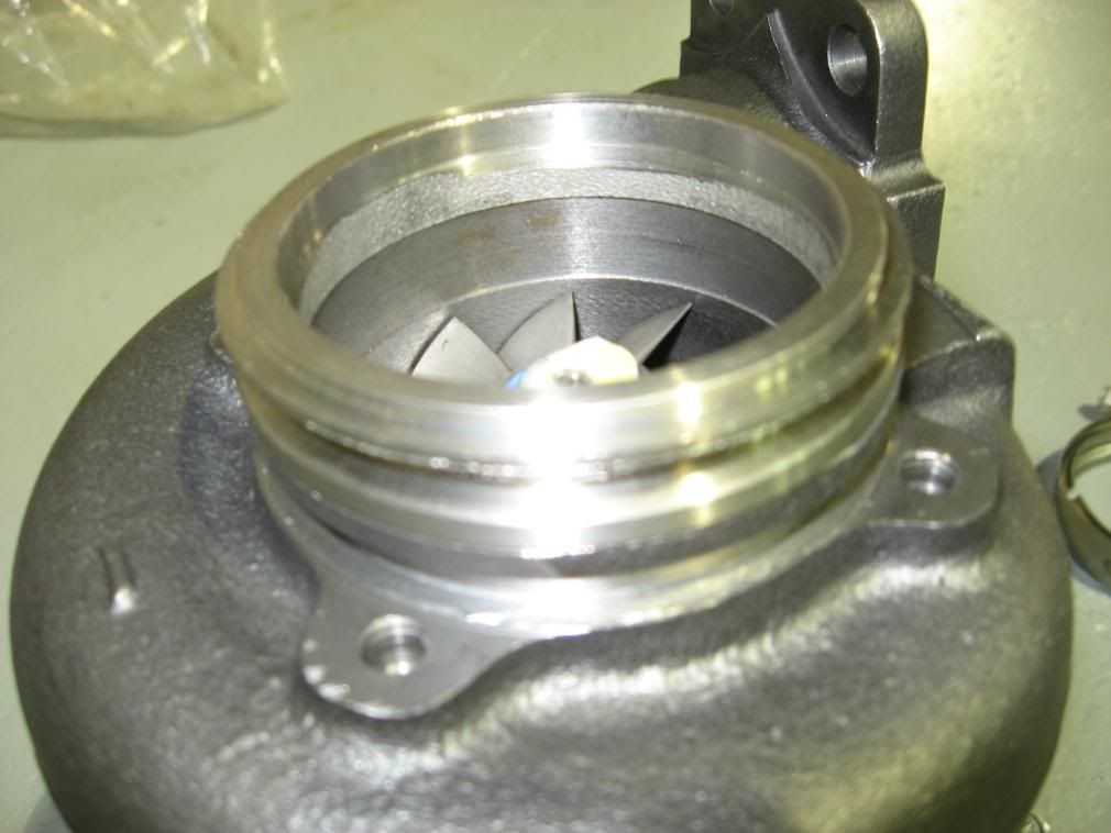

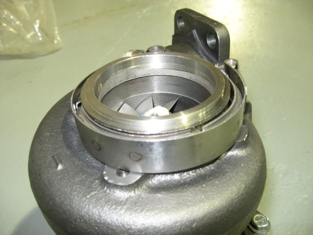

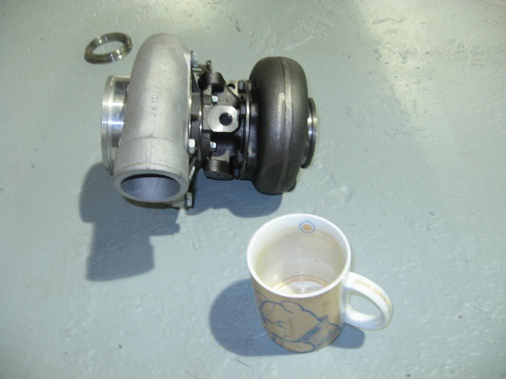

The V-band flange I have had machined into the turbo housing to save space
The super small flange that is perfect fit for welding on 316L 3" stainless tube on as it was designed to be for
The complete system now i will have no more bolts coming undone or firewall fitment i just melted my speedo cable cause i'm rhd issue's either

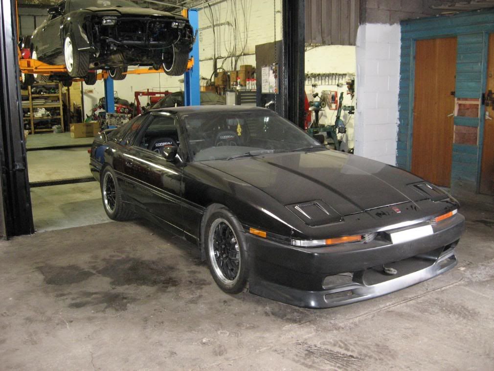

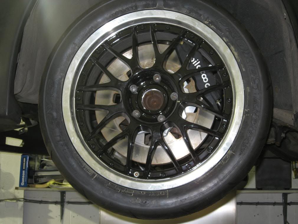

The new bumper is getting fitted at min and ive had the wheel centre's of the bbs's clour coded in 206 ooo and the stickiest toyo r888's fitted the wilwood kit is on and sorry one of my customers skylines which happily promotes my company and goes like stink its also link ecu powered
