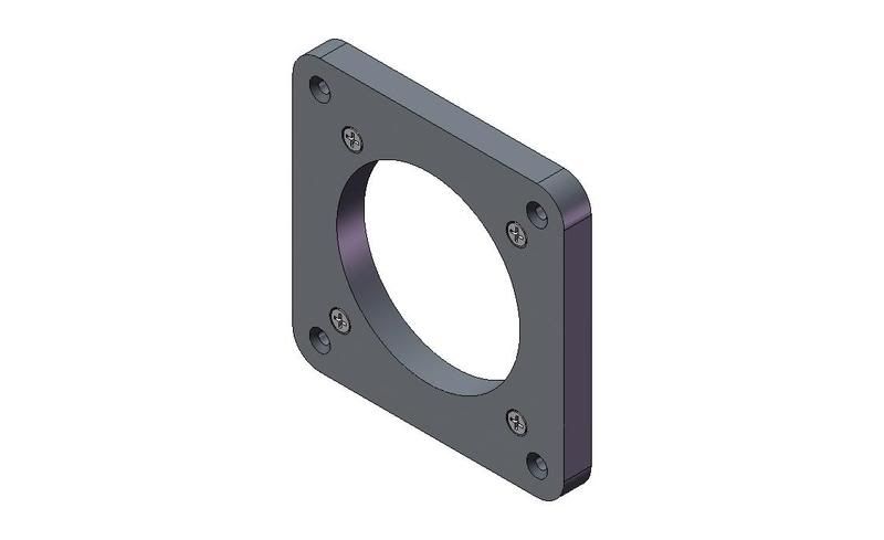

MK3Brent;1229417 said:
Computer drawing^^^
Real life, lol.

I would not make it a blank plate.
To many questions of,
How big is the Q45 mounting pattern?
How big is the LSx mounting pattern? Bolt hole size.
Q45 and stang. Call it a day.

The problem with a flange like that is a 90mm opening will break into the q56 pattern. You will also be trying to open a 90mm into a hole much smaller to it would completely defeat the purpose of the large TB.
The flange that is attached to the TB will have a 90mm opening and a stang bolt pattern. We are going to have the adapter plate pretty much as you saw in the last post. It will bolt onto the "fixed" bolt pattern and go down to Q45
It will definently not be blank. Most people do not have access to a machine shop and using hand drills is not a real good way to drill a straight hole, tap straight and deburr so the TB will sit properly

figgie;1229630 said:
Great!
That is unless you guys really want to field calls like I posted on #123 ;)
My ear is actually sore from taking calls just on basic info this week. Stang 90mm fixed flange pattern, adapter plate will be available for Q45 pattern. We know both the deminsions and if the end user wishes to make there own pattern know problem, we do not know the pattern for any TB besides the stang and Q45.

Any provisions in development to adapt the OEM TPS to the 'Stang throttle body (I'm not certain if one already exist)? There is already a Greddy adapter for the Toyo' TPS to the Q45 TB.

The TPS will be figured out when I put the mock up in my car...it will be addressed though!
