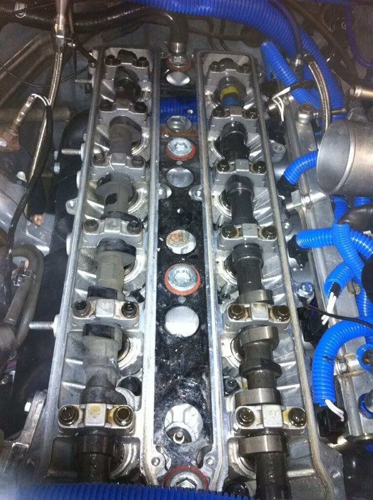

Fresh rebuilt motor, 10 mi down the road it dies.
Timing Belt had some teeth ripped off it.
Basically Exhaust cam locked up and crank ripped some teeth off the belt
Brand new 272 BC Exhuast and Intake Cams// Spring and retainers as well
The Exhaust cam is now in two peices. As you can see the exhaust side wasnt getting oil all the way down the cam.
So what are the potential cuases of this?
Thanks

I'm guessing the Cam has torn the head up pretty badly, only way to tell is pop some caps off, these heads don't have "bearings" as such so any damage pretty well junks the head... :(

Not the first BC cam to have bearing failure, probably won't be the last.
Might check to see if it even had the oil passage drilled the full length.
That would explain to oil getting to any of the other bearings, except the first one.
No matter, the head is scrap now.

wow I'm a bit stunned that it might be this...... Dimensions I can sort of understand but something so basic....

That blows. Were you able to turn the cam prior to running the engine? Id be talking to the machine shop before ripping anything apart. At least that way if it is their fault, you wont be blamed.

Yea, it was definantly turning heh... The pucks show evidence of that ;)
Success = A un oiled cam smacking things in ur engine
Their is no way machine shope could blame me for this one, Either it was assembled wrong or there is a defect in the cam. I am leaning toward machine shop but who knows.
