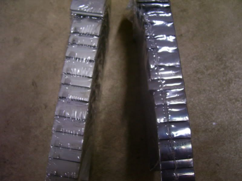

Have not seen those ACL clevites yet, but lots of fed-mog. Mostly in the undersizes. I posted a pic too a while back of how the difference between the Australian NDC mains and Japan NDC mains differ. Ever since Mahle purchased clevite they have been using mosty the coated japan ndc mains. Whats next for Clevite?

Here is the pic again of the newer NDC design from japan on the left, vrs the older style from Australia on the right.
