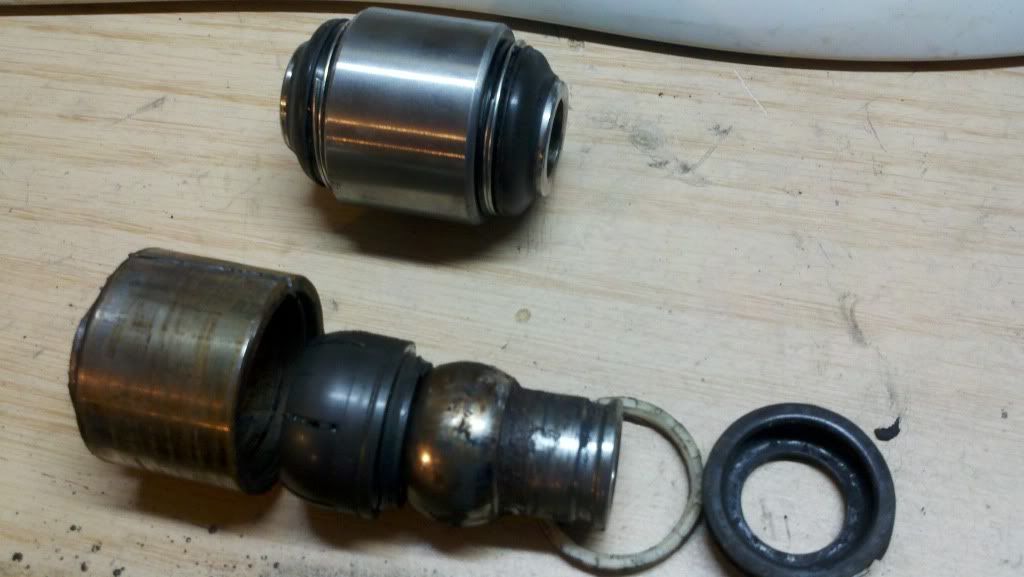

Damn- I paid almost $50 a side for the sphericals.
Here's a pic of an old vs. new rear spherical:
How can you tell if you need new bushings? The rear end of my car seems mushy and tends to wander at higher speeds, especially if there's a slight imperfection in the road.
