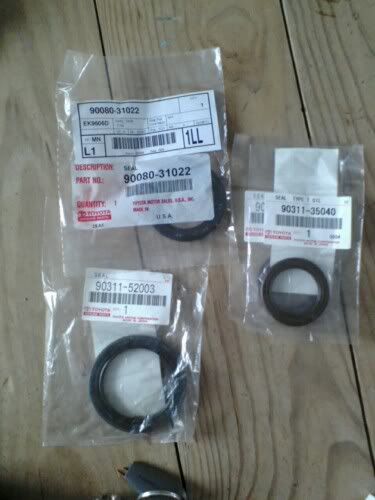

St. Cloud Toyota had all of them in stock when I had hundo pick them up for me last week ;)
2- cam
1- oil pump shaft
1- main crank
emiliorescigno
Sep 17, 2006
1,199
Woodbury, MN
92nsx;1689016 said:
Here is what you need and when your done come do mine ;)
I'll make sure to grab those seals today - I may pass on the cam seals though, the leak is lower down in the engine. I may take you up on the offer to give a hand helping with your seals - if you volunteer your garage heater when I do mine. :icon_bigg

Well, I started pulling apart the front of the engine today, and HORRORS!
The timing belt was nearly slipping of the front of the cam gears, and the timing belt idler pulley was wobbling loose, and its bolt was finger tight. The only thing holding it in place was the plastic timing belt cover. There is oil everywhere inside the timing belt area as well, so a seal here somewhere is toast. I now need to get off the crank pulley and Power Steering belt, who are putting up quite a fight!
edit: As per Chris's suggestion, I went ahead and ordered the Schley crank pulley removal tool. On hold for the next few days until it arrives, I suppose.
