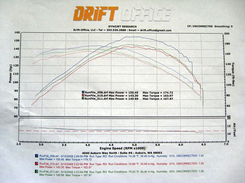

5/15/2008 - 300ish miles on engine
Dynojet
155whp 175wtq

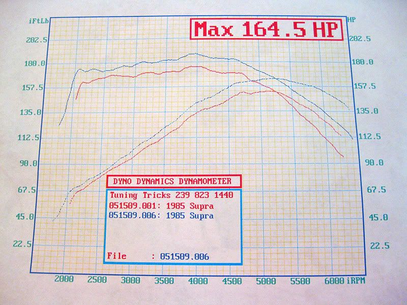

5/15/2009 - 10,000ish miles on engine, after HKS 1.2mm MHG was installed
Dyno Dynamics
152whp 175wtq
165whp 188wtq (same day, 5 runs later, AFM leaned out)

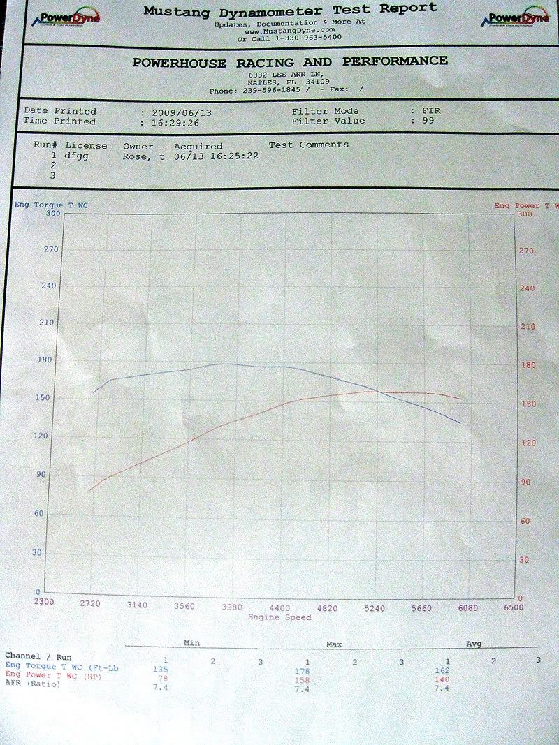

6/13/2009 - 11,000 miles on engine, no changes.
Mustang Dyno
158whp 178wtq

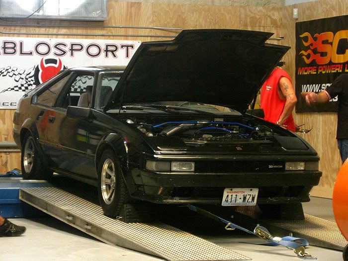

Videos from today:
http://www.youtube.com/watch?v=UfXlBppDvmU

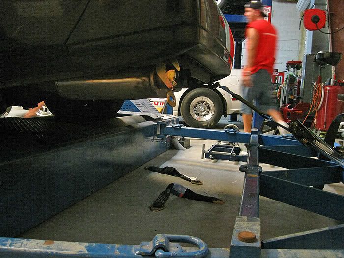

She broke a strap @ 6,000rpms, hahaha
http://www.youtube.com/watch?v=NOpqOzkJUCc
It was supposed to be $20 for one run, no a/f but I ended up getting 3 runs in bc the first guy screwed up the 1st run and let off at 5,000 and then the strap broke on the 2nd run. YAY 3 runs for $20!

Yep... the guy on the Dyno Dynamics told me his dyno was calibrated to within 1% of a Dynojet. And the Mustang dyno #s were a bit higher than what I would have expected....

oh and the Mustang dyno's weather correction factor read somewhere about 163whp and 181ft/lbs... something like that.
