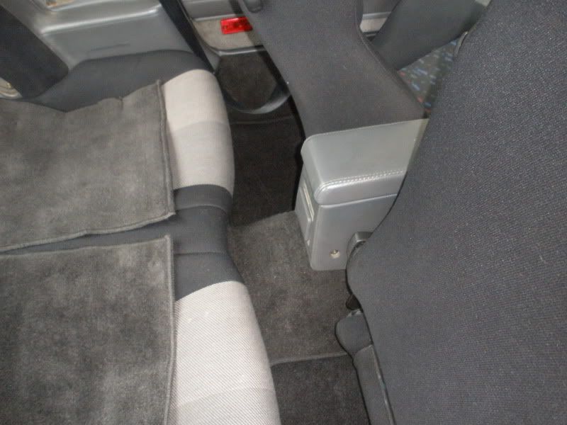

BEFORE: dirty, torn UGLY!

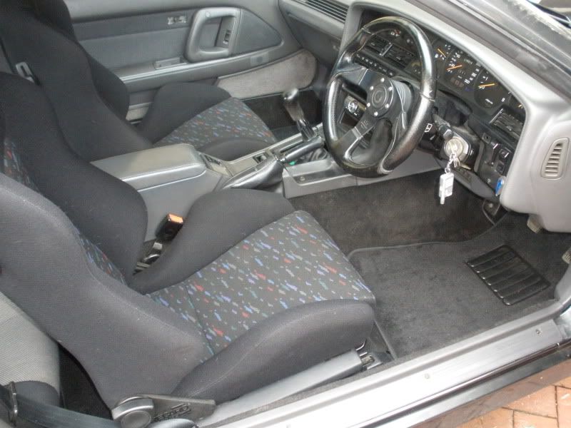

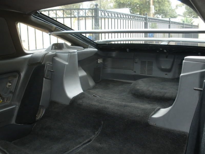

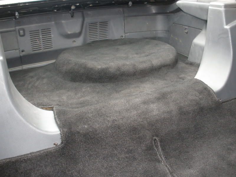

AFTER:
vacuumed the bare floor while the carpet was out and put everything back properly as i havent had a chance to do this since i got the car. feels much nicer inside now, the interior looks almost brand new. Will get some pics of it all re-assembled tomorrow!

Let's see it installed and I'll give you my honest opinion. I'm considering getting some black carpet to re-do my interior so maybe it will help me out. I want to do black seats, panel inserts, arm rest, carpet to compliment my shadow gray pieces.. I think it'll look good..
Waiting on pics! :)
