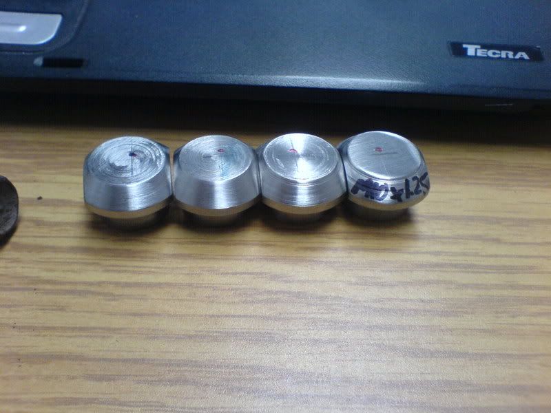

MK4 rears are a relatively cheap, easy upgrade for the rear.
(I say easy assuming you have access to a machine shop to make some simple inserts)

Adam, what inserts? I just upgraded my mk4 to mk4 tt calipers form the NA ones that come on the JDM cars.
these (plus threaded holes for the appropriate bolts)

For your interest, the previous owner of my '87 removed the ABS. I swapped in Mk4 TT rears at the same time as the Doward kit so I never noticed such a huge difference in Bias. In fact, under extreme braking, my TT rears will begin to lock before the fronts do(even with 295 rears), but the bias feels close to balanced. I will just be very careful until I either install a prop valve or get 14" fronts later on.
I picked up an old jakespeed bolt-on kit for my rears. The inserts are the little parts that the bolts go into. The rotor also needs a shim. Adampecush had these parts custom machined for his install so Eric you might have to do the same if you don't want to drill out your Mk3 hubs for the larger Mk4 bolts.
