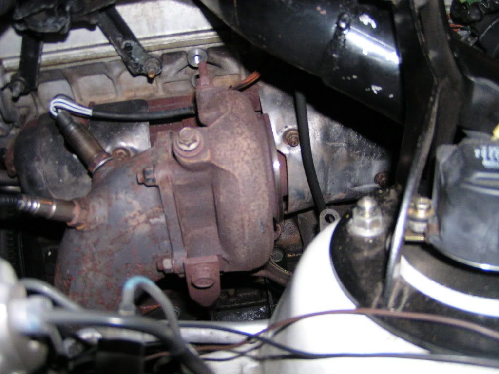

torch.
and a soft face mallet.
could use a brass hammer or brass dowel, block of wood.dead blow.
but the idea is to quickly heat the area of the v-band and heat evenly,a few taps around the out side and you will see the turbo start moving out.
although this only works' when your exhaust gasket are in good shape.
and you are replacing the inducer wheel, or the exhaust housing is good. and oil leaks N' such.
i was sending mine out to have it upgraded, they didn't need the exhaust housing. it was off with in 20 minutes start to finish. shipped the same day.
