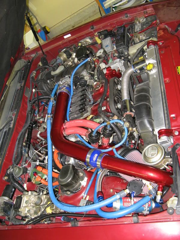

Adjuster
Under non "Boosted" conditions, the stock throttle body port draws off oil vapor and crank case blow-by gases/pressure.
It can also draw the other way, to the turbo inlet/accordian hose where there is a low pressure area as well.
Under boost, the main source to draw off the PCV is the accordian pipe fitting.
Any "Catch Can" or other device to try and remove the oil vapor from the crankcase gases should be installed between the valve covers, and the intake/accordian pipe fitting.
I used a Parker air filter. (Like you would put on a large air compressor setup, to remove any oil from the air. It flows more than I should need, and it cleans the air nearly to the point where you can breathe it.)

You can always have a machine shop take your valve cover pull the barbs and drill out the cover for -10AN fittings, and then run your own tee (also involve the tb), and follow the stock routing. Now, adjusters post, it's perfect for you (and he's making big power on what looks to be stock sized barbs). :icon_bigg
