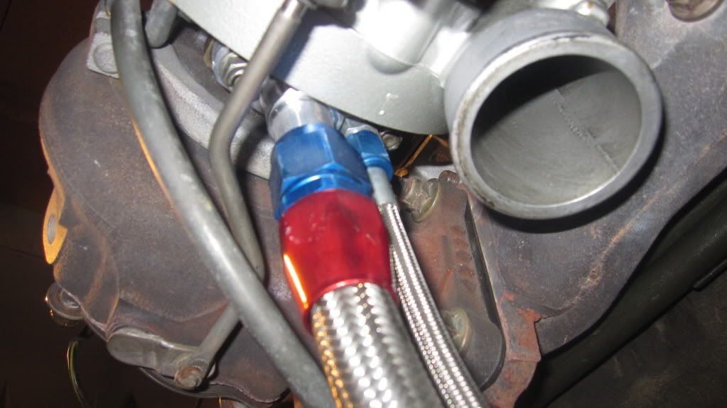

Here is how mine is setup
-10 AN Bung Tig welded into the oil pan between the crank weights to keep oil from flinging and blocking the drain (yes it is possible)
All Braided and AN fittings used, Can't get better than this
-4 AN fittings and braided line used for feed, BSPT-NPT-AN -4 used for turbo feed
Arizona performance CNC Aluminum Oil feed/drain flange with AN fittings -10 and -4
Total cost of above 175.00
