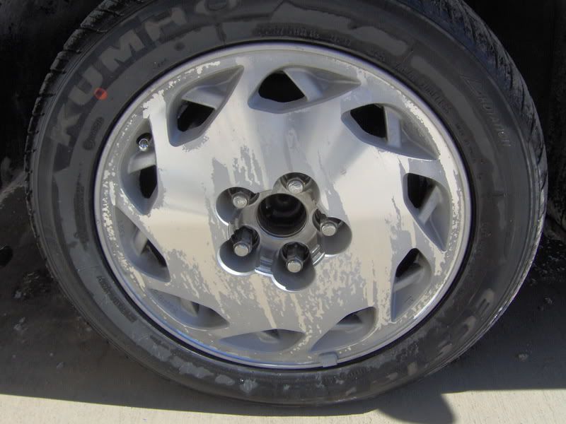

I've stripped my blades but still have some "stuff" on them I can't seem to get off. I don't know if it's primer or what. It's nowhere near as bad now as it is in the picture I've attached. I was able to get most of it with more applications of stripper but there is still some on it and no matter how much I scrub and reapply stripper it's still there. Does someone know what this is and tell me how to remedy it?

I havent done this to my saw blades yet, but I plan to this summer. You just need to buy a can or two of aerosol aircraft paint remover. Spray it on, let it sit for only a couple minutes max, then hose off. Those are instructions that I got from someone on here and his look great. I used the paint remover on my IC (someone had painted it white) and it took the paint right off back to the original brushed aluminum finish.

look at my build thread on how to do it johnathan has one to
just spray the stuff on and wait then wash it off with a hose the take a really fine grit sand paper and just start wet sanding then clean it off sand clean sand clean till it look really shiny the poilish it
