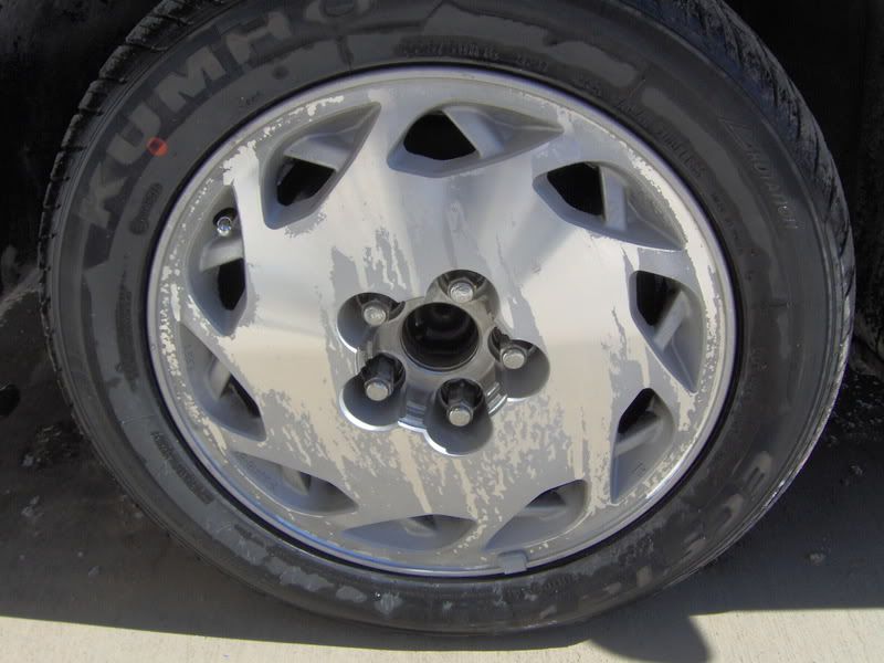

gtsfirefighter said:
I've stripped my blades but still have some "stuff" on them I can't seem to get off. I don't know if it's primer or what. It's nowhere near as bad now as it is in the picture I've attached. I was able to get most of it with more applications of stripper but there is still some on it and no matter how much I scrub and reapply stripper it's still there. Does someone know what this is and tell me how to remedy it?
you have kumho tires... looks like someone kumho'd on your saws.

When I stripped mine I found that when Toyota masked the wheel face for sand blasting of the slots they did a crappy job so I had these random sand blasted areas on the wheel face. When they come from the factory you don't see that due to the wheel face be painted. Maybe those areas that look nasty in the pics are areas that got blasted by sand due to a crappy factory masking job. Do they have the same surface roughness as the slots that are blasted? It would take some nasty chemistry to remove an amount of aluminum like that using stripper that's available in today's world. Making hideous marks yes but a large amount of material removal isn't likely.

They weren't sandblasted.
The rough finish in the slots is just rough casting.
Once the wheels were cast, Toyota would machine the face, smoothing it out, but leaving the rough surface in the slots.
From there, they would add one of 3 finishes for the US market.
1: Silver with silver cap.
2: White with white cap.
3. Slots masked and painted silver, while leaving the face machined and adding clearcoat. rare, I've only owned one set. they came on an unmodified 87 turbo, with the option listed on the window sticker.
It doesn't show up listed in the sales brochure however, but some of the pics show them.
Chrome or polished sawblades were sent out by the dealers to be stripped and either polished or plated, this still happens today. It's just something a dealer does to be able to mark up the price due to the option price being much more than it actually costs to plate the wheel.
