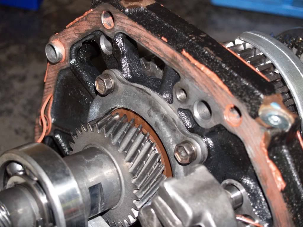

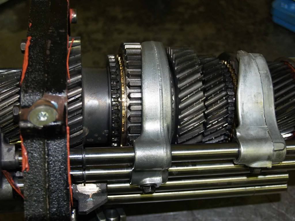

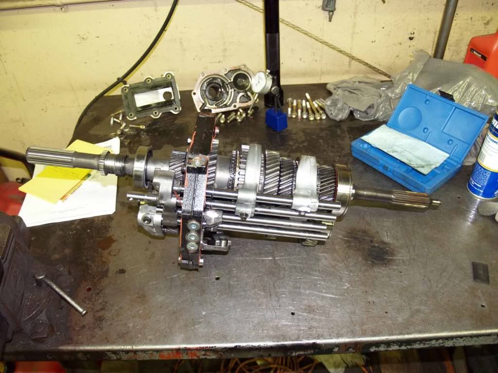

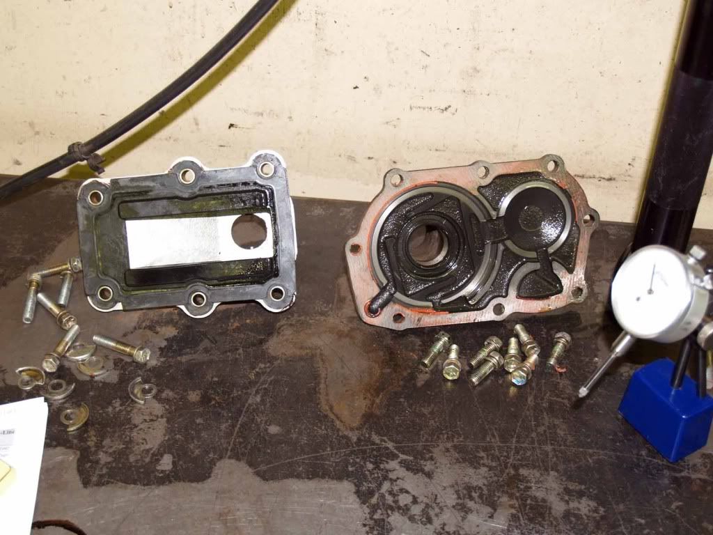

The tranny is apart. Nothing unusual for a ~140k tranny. All syncros are floppy-juh-loppy and most of the bearings and seals are worn. All clearances are within spec. Some of them are borderline; but, should fall back into spec when the new inards are in.
Here's some tranny pics.
The first one is a pic of an empty and clean gear box.
Here's the rest of it.

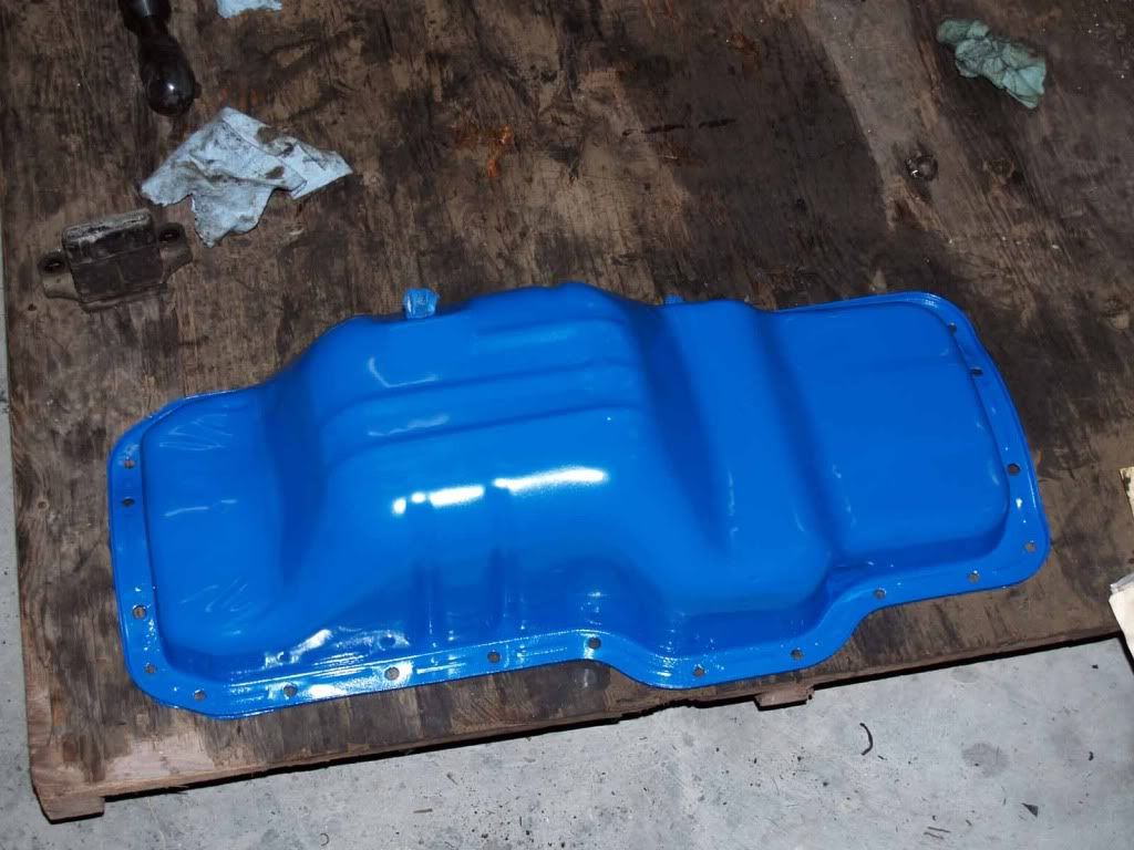

Here are the parts that have been thru the parts washer so far. Many many dirty parts to go.
Some of these will be powdercoated before reinstallation.

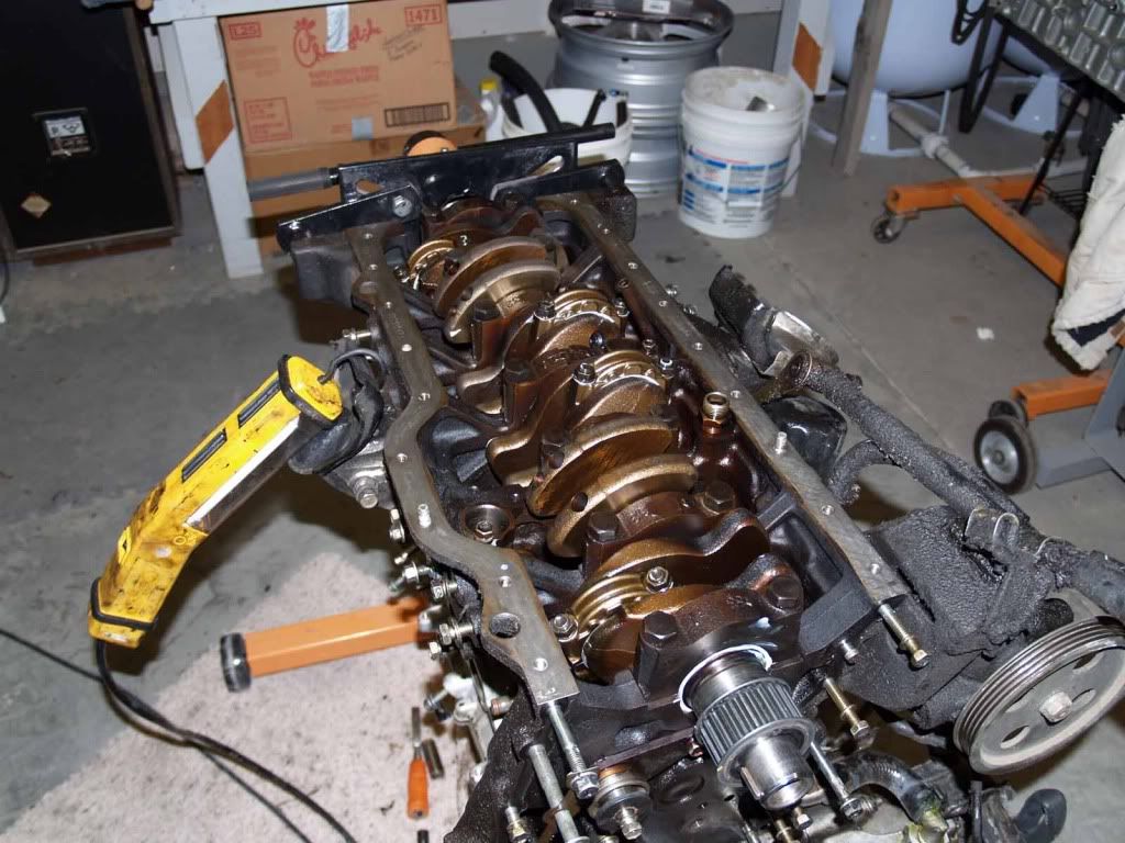

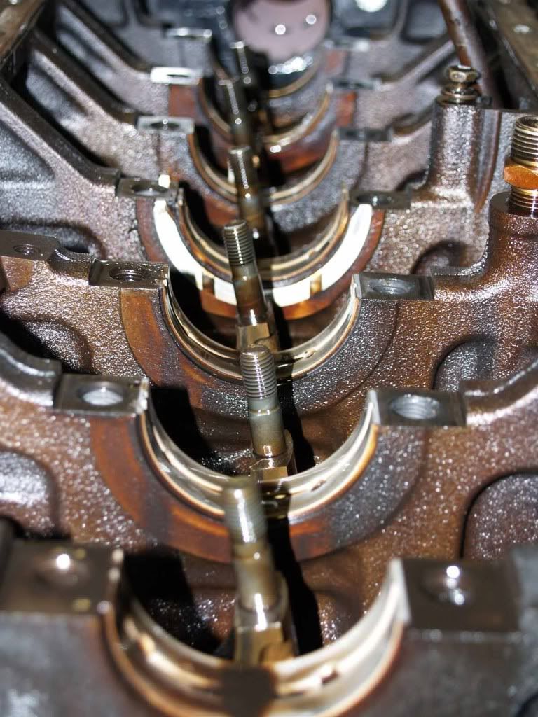

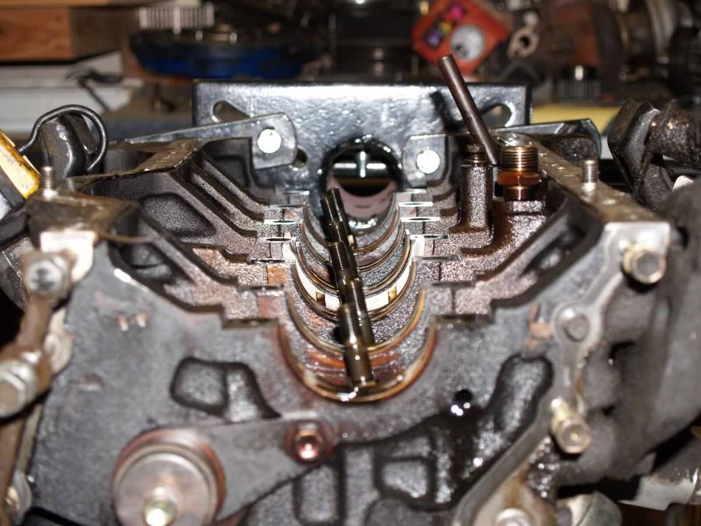

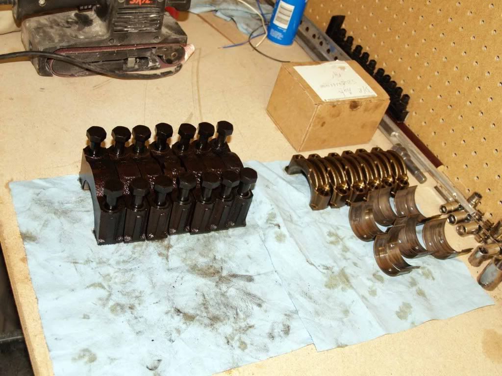

Here's a shot of the new bearings installed.
And here's the crank back in and everything all buttoned up. The assembly rotates nicely. No binding. That's a good thing! :)
