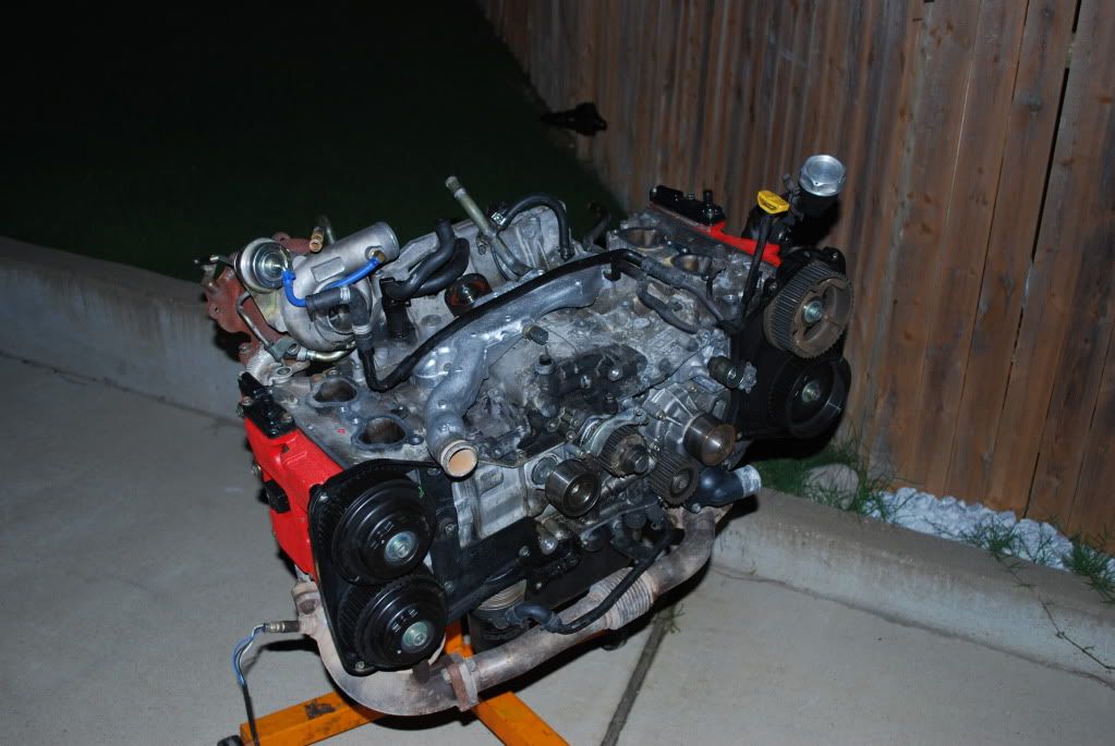

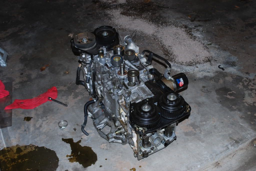

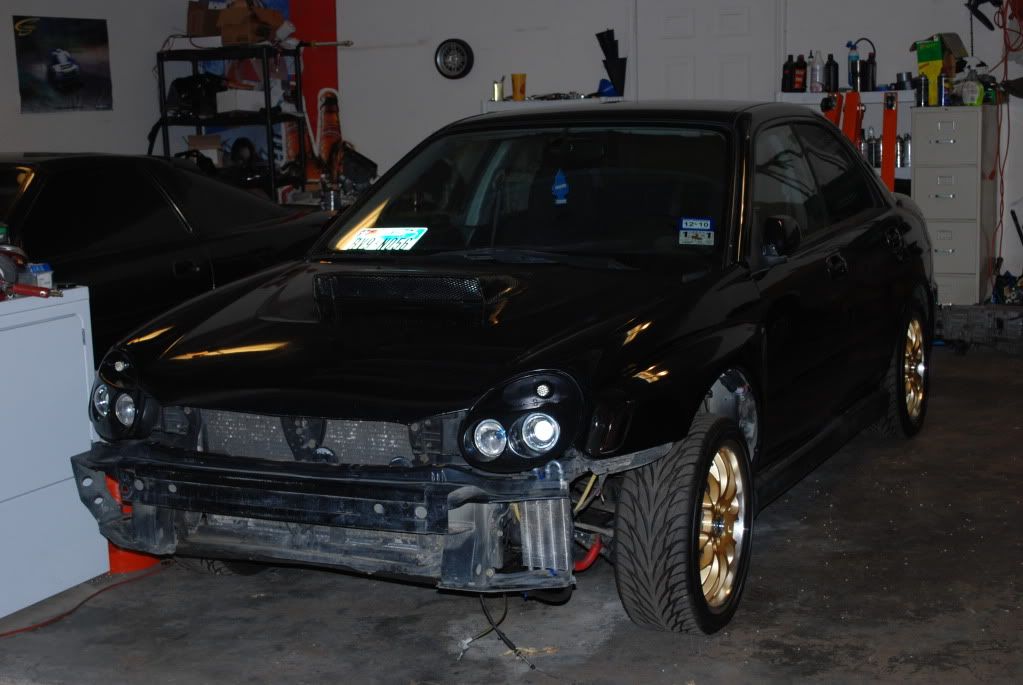

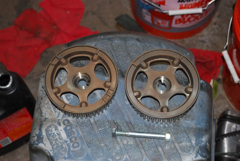

update on the car, had it running, had a big misfire, turns out the cam gear was different as well as the timing gear. but the timing belt slipped and bent some valves, so i pulled the motor and currently have the heads off the old motor at the machine shop, gonna throw that back together with all new seals, pumps, gaskets, etc

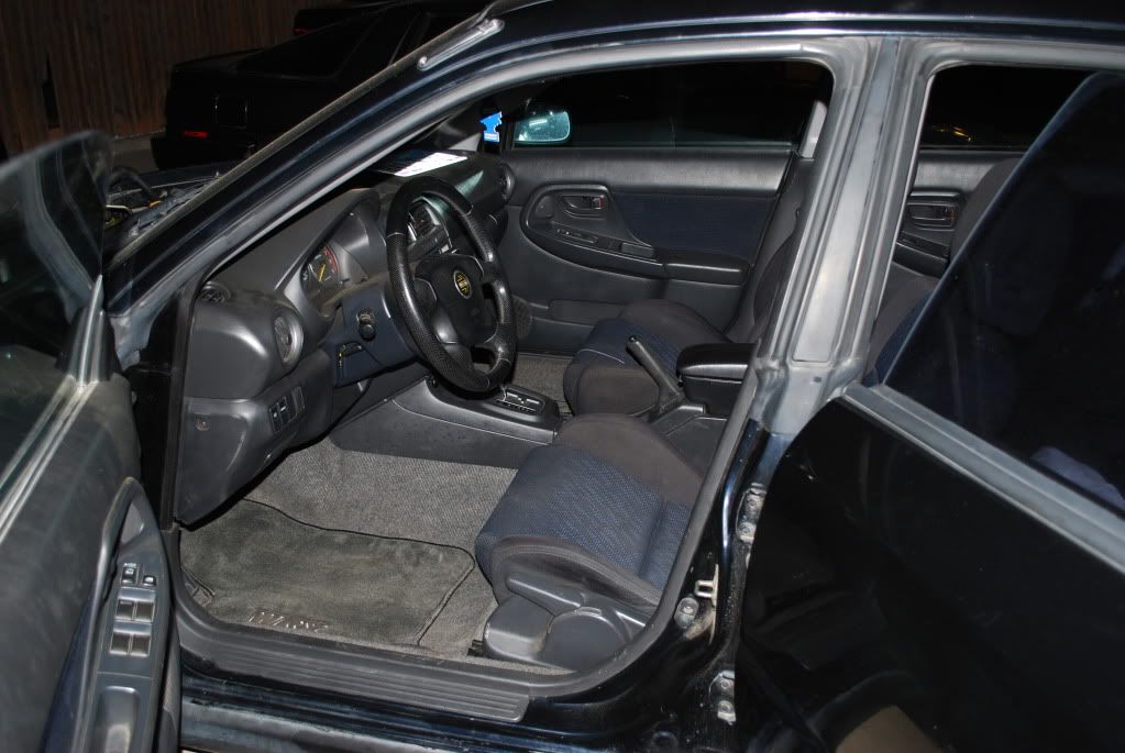

weve cleaned the interior completely (except the seats, those will be professionally steam cleaned) also ordered some factory floormats from subaru

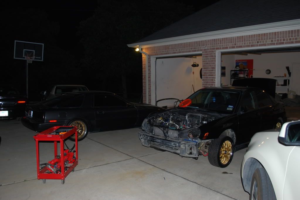

car sittin outside before pullin the motor or after pulling it, i dont remember

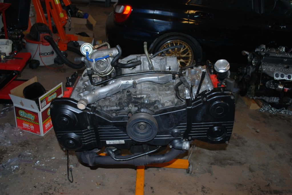

new motor and old motor

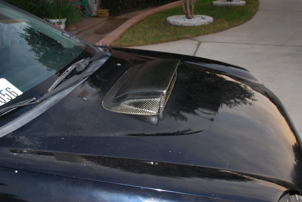

took off some cheap spray paint and found out the hood scoop is carbon-kevlar
heres the cam gear, the one on the left is the JDM, 7 pickups vs 2 on the USDM

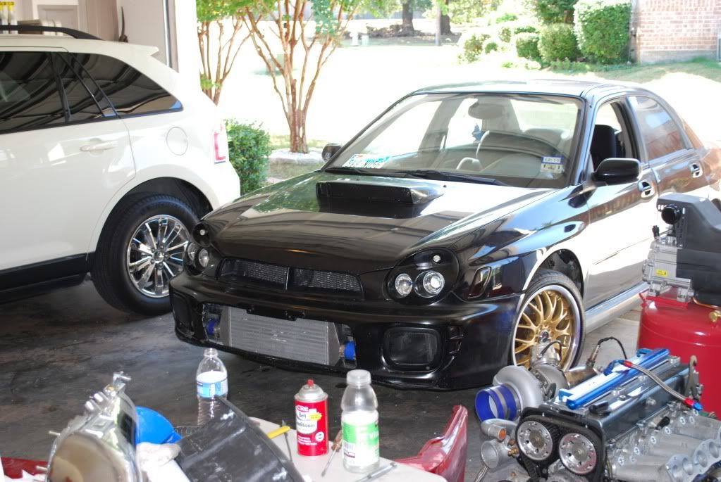

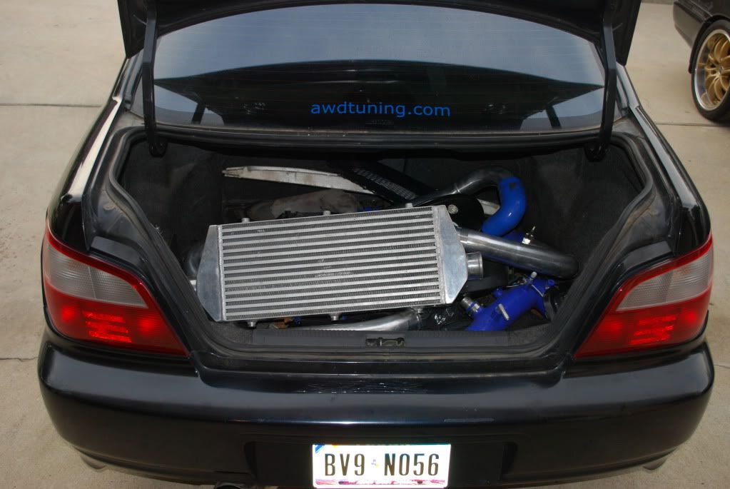

also picked up a front mount kit for it locally (lil bro wanted to know why my car got one in the bumper and his didnt)

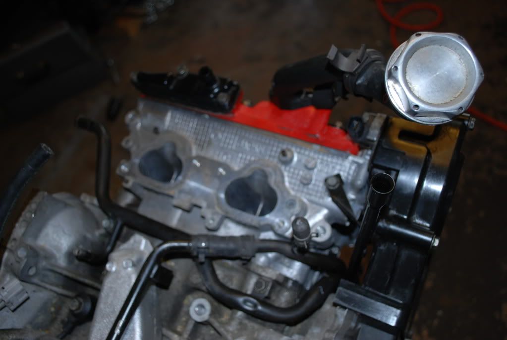

heres the motor as it sits now

Stupid interference heads... Sorry to hear that Ben. Not to go off topic, but my mind has stumbled upon the thought of what a boxer 8 would sound like...

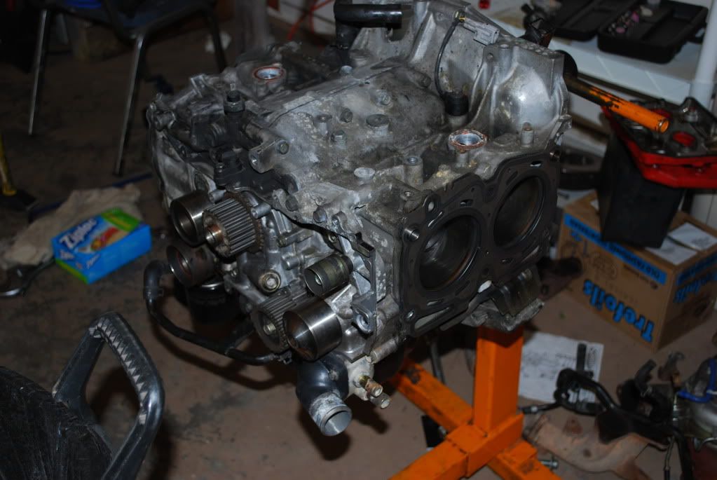

the heads are finally done, and we gave the car a good wash.

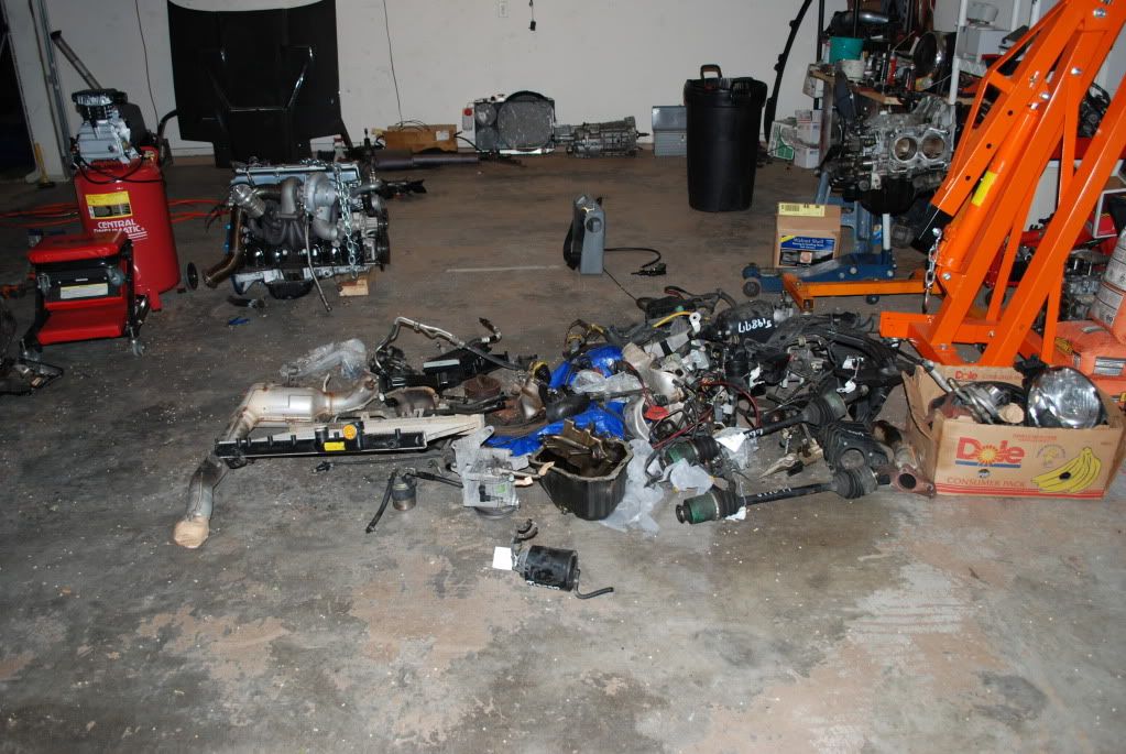

emptied out the storage locker, this is all that came with the jdm motor

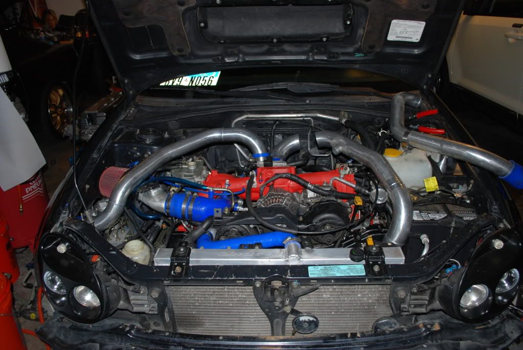

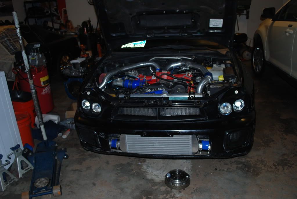

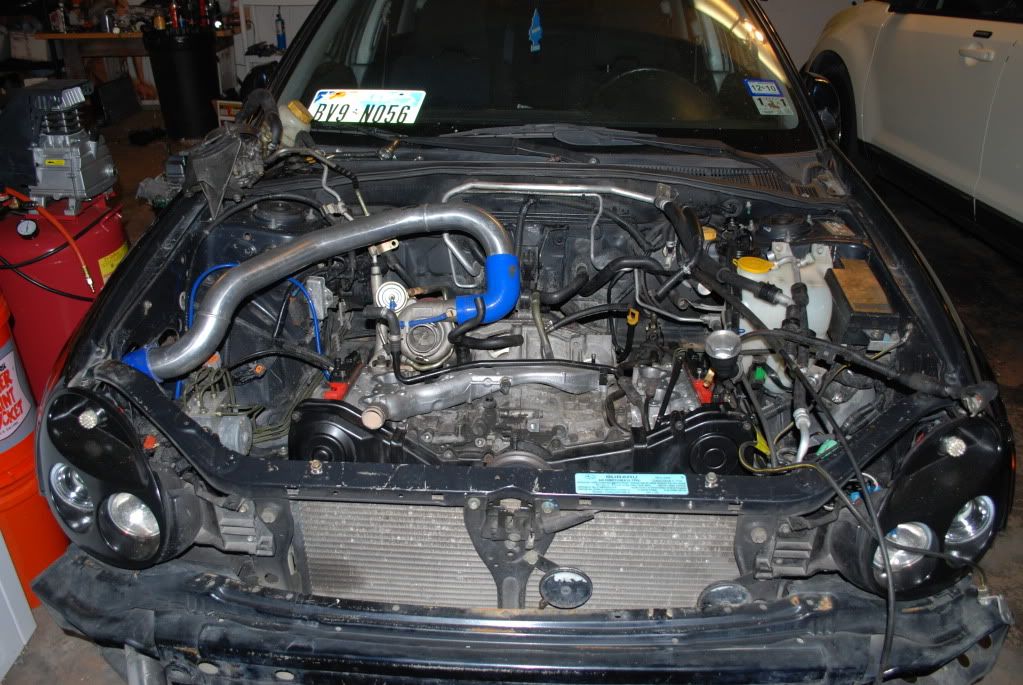

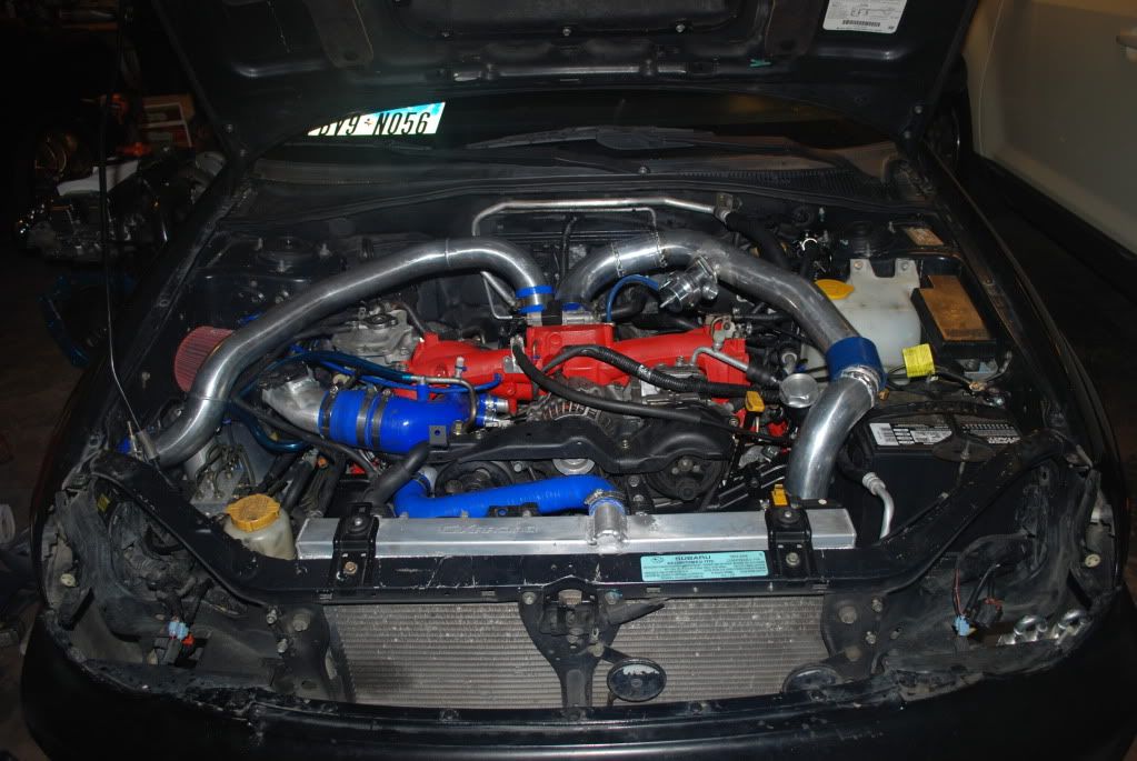

motor back in the car, mocking up the front mount piping so i can get the placement of the intercooler done

got it running today with a stock top mount, then started with the FMIC kit............which didnt fit worth a shit on the cold side. so having to modify that, then go get it welded up.

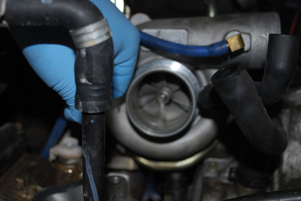

What is the stock boost controll? Does it have factory electronic controll like so many new cars do? Or is it manual control like the MA70? My youngest brother has one, I think it could use BPU upgrades if that is possible on these rides. I would do the exhaust and increase the boost to the max amount on pump gas.

The 03 i drove was on MBC since the factory EBC doesn't really keep up with RPMs in 4th and 5th after upgrades begin (bigger exhaust, divorced downpipe)
It was described as bouncing above and below the target pressure and not really settling in time before shifting.
