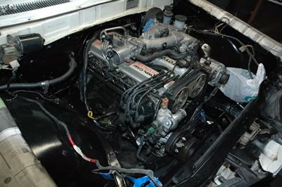

Yes progress! I have been rather busy with a wedding this weekend. A good family friend got married, and I was an usher along with my two brothers. Great food, and an open bar all weekend. It was a bunch of great people partying in one of the most swank hotels in San Francisco, the Fairmont. We where up on the 23rd floor with a view so awesome it was difficult to comprehend. Did I mention there was lots of alcohol? Oh man lots of alcohol. So yeah, now that I have recovered somewhat, back to cars.
I replaced the timing belt. That took a while. Its easy, but because its so crucial I was fussing over every step. That was part of my day.
After that I was ready for the clutch and transmission to go on. I found out the hardway that autotranny flywheel bolts are a lot shorter than the manual bolts. I was thinking that I would have to order some new ones from Toyota, then I rememberd that the guy I bought the Supra from gave me the bolts I needed. Problem was that two of them where damaged. I am so glad I still had every bolt I took off the 2M, because the flywheel bolts where identical. I am not sure what gussets I used, I had all four from the two engines all mixed up. Anyway, two of them worked and two didn't.

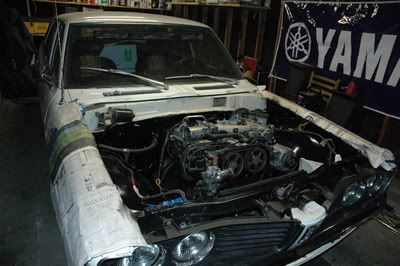

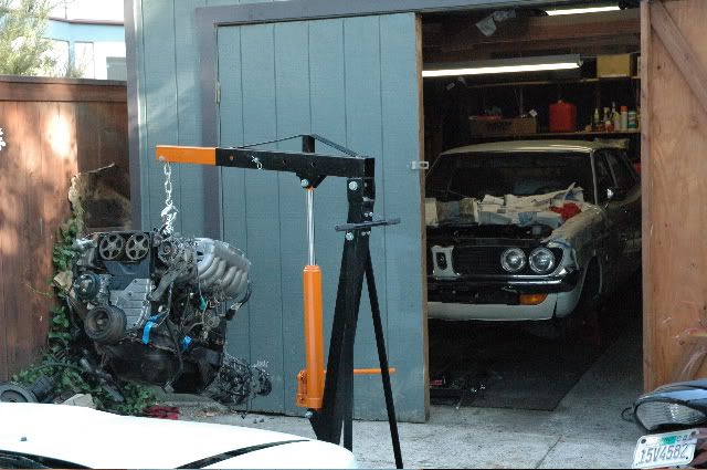

I was determined to get the engine and tranny in today. It was hard work, engines just don't seem to want to come in or out of the MX12 engine bay. Thanks to the transmission being on the engine this time around, I actually had to put wheels on the car and roll it part way out of the garage because the engine hoist boom would not clear the beams in the garage. After much sweat, tears, beer, and blood.....the engine with the transmission is finally in!!!!

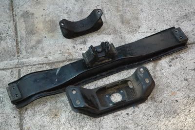

So there are some issues with the transmission. It fits fine, but the tranny mount on the W58 is pretty far off where the crossmember goes for the old transmission. Not even sure at all what I am going to do at this point. It may be possible that I use the W58 crossmember and drilling through the floor to bolt it up.

Here you can see the old transmission crossmember in the middle, along with its mount at the top. I sat the W58 mount on the old CM just to see. The W58 crossmember is at the bottom.

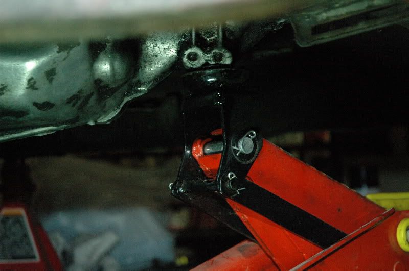

Here is the bottom of the W58 in the car. Its hard to see, but the old crossmember mount in the backround, and where the W58 mount bolts up are in pretty different places.

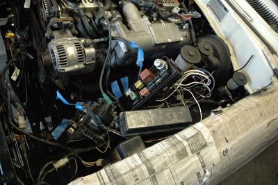

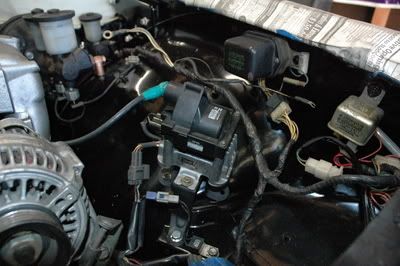

Mounted up the ignition coil gismo by using the stock bracket. I used an existing hole and drilled a new one. Easy.
Then I started with the fuse box but I forgot to bring my computer so no FSM. Needless to say I didn't get very far with that. What a mess.

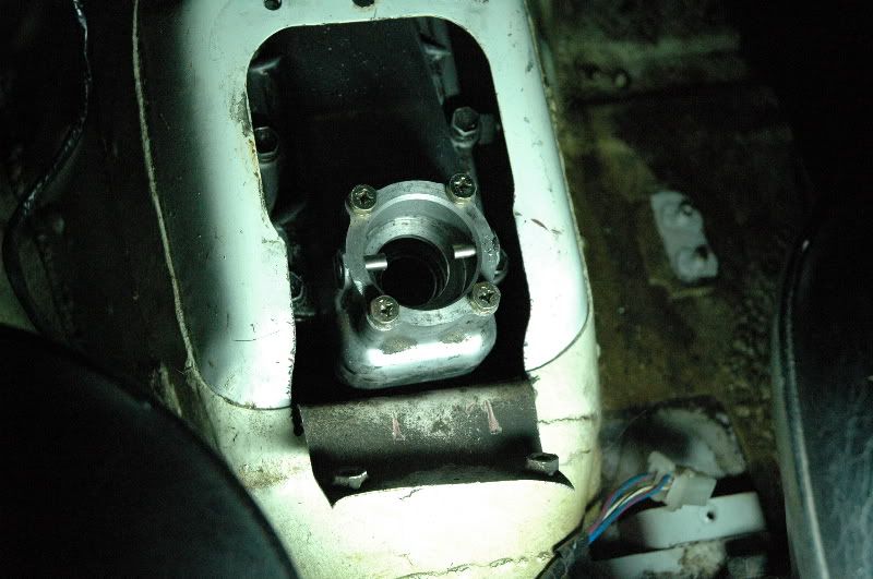

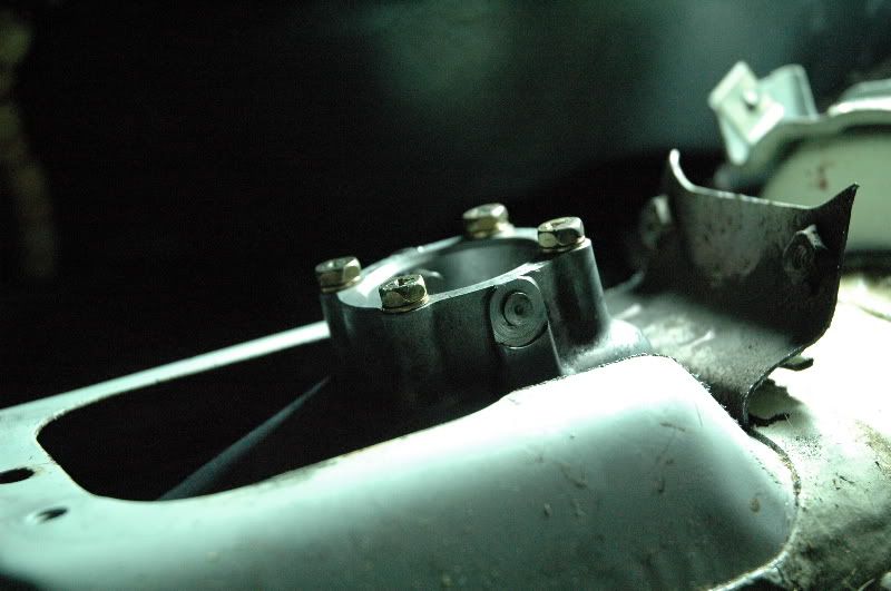

Without the FSM for wiring, I turned my attention to the transmission again. It was pretty obvious that the stock W58 tranny mount was going to be of no use what so ever. Its not long enough to bridge the tunnel. Not only that but it would be right where the e-brake cable thingy-ma-bob bolts to the tub. So what I am going to do is cut a relief into the MX12 tranny crossmember, and rest the W58 on it. That will be enough for me to drive it to a shop and have something professional fabbed up.
I had to cut into the tub to make room for the shifter. Once the tranny was able to come all the way up so that it and the engine where level, I could see that the engine actually fits even better. It leveled out gaining some room at the firewall and just looking nicer sitting in the engine bay. Ugly cut, but it will be hidden under the center console.

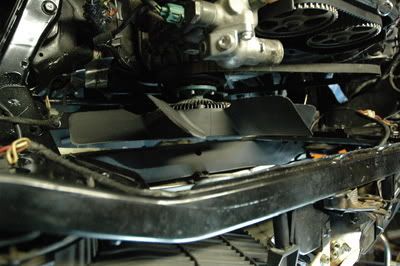

Stupidly, I left the radiator along the foot path that goes by the garage. Someone hit it ( I think with a bike ) and punched a nice hole in it. Fortunately, I have a back up plan. My brother let me have his old radiator from his 1989 240sx. He swapped an SR20DET into the car, and upgraded the radiator. It is much more slim anyway and fits well. Even though its half the width of the MX12 radiator, its longer. I don't think the overall volume is too much less. The 7M fan doesn't fit though, not enough space. Looks like I am going to have to use an electric fan.

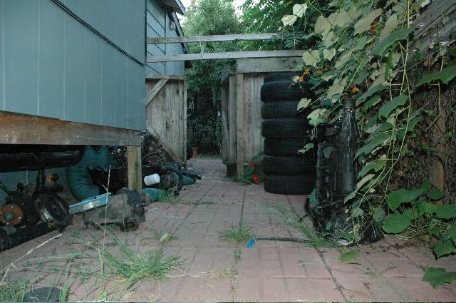

Our own private junkyard. On the side of the house there are now some 12 or so wheels with tires, 2 transmissions, 2 differentials, a disassembled engine, plus misc. driveshafts, pressure plates etc etc...... its pretty funny.

Boso: You know there are different tops available for our gearboxes don't you? (Different shifter locations)
One rule with the wiring: Don't let the magic smoke out of the electronics ;)
BosoMKII
Apr 24, 2006
497
NorCal
You don't say......
Where can I find info on this? Do you just swap the top or do I have to take apart the transmission to change things? It isn't too late for me to bend that metal back!
