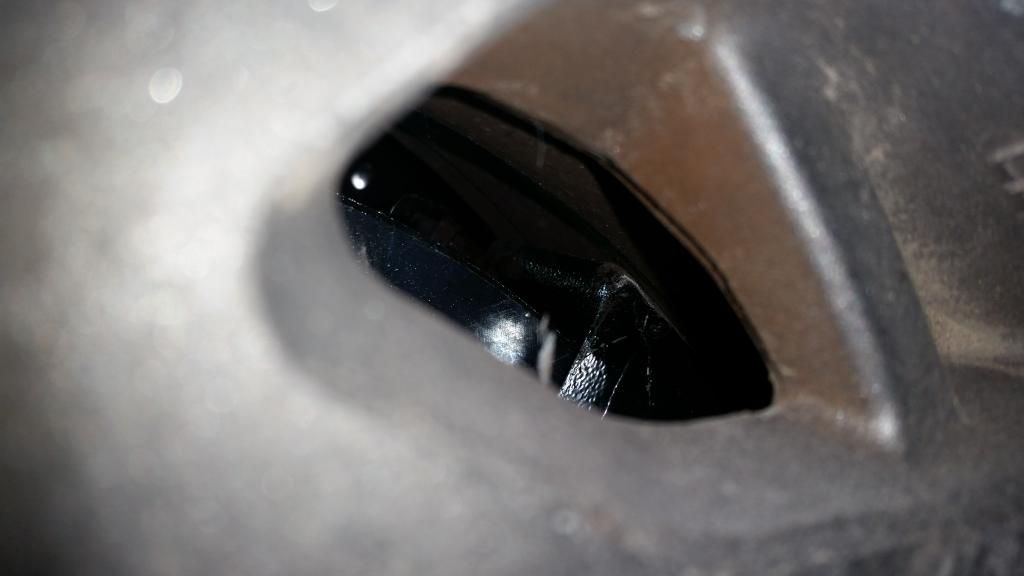

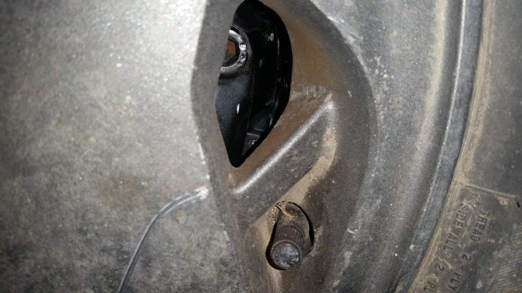

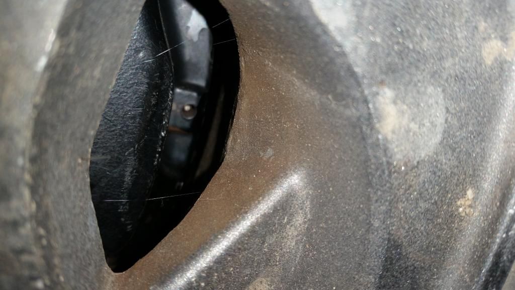

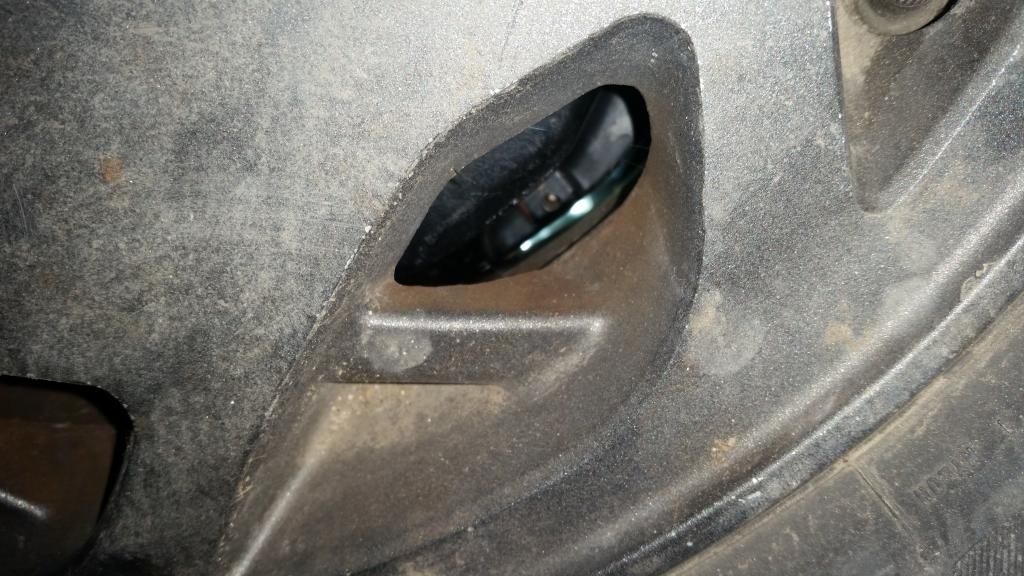

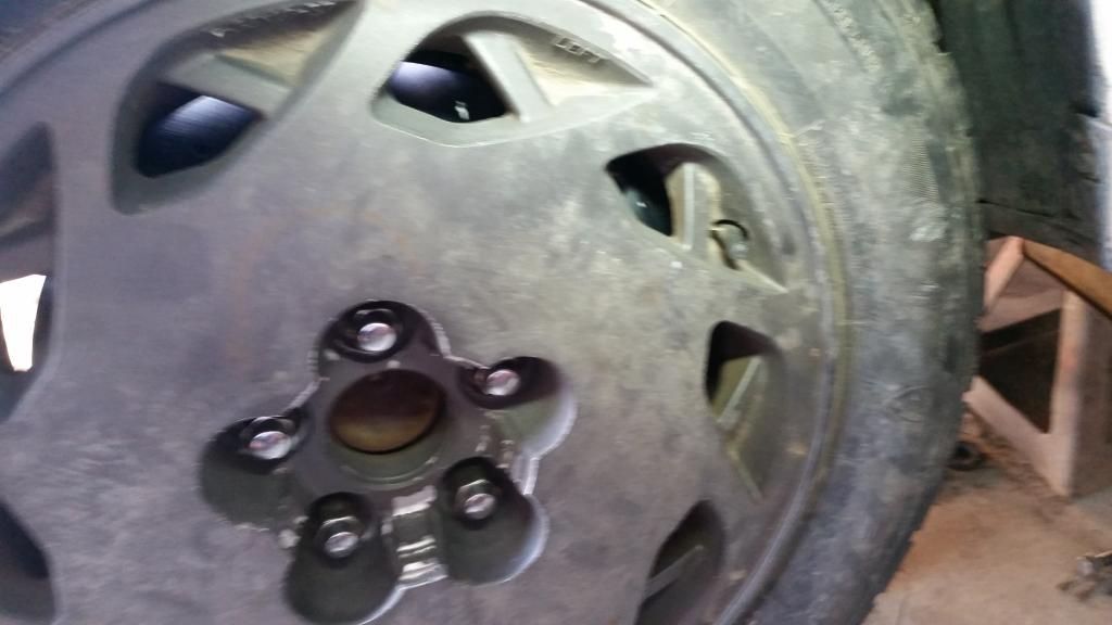

SideWinderGX;2038827 said:
That pic of the 17" RPF1 makes it seem like there's a ton of space between the caliper and the rim. Anyone have some 16" rims lying around, sawblades even?
Rim fits on there but caliper hit the inside of the rim, rim still spins but touchs caliper.
