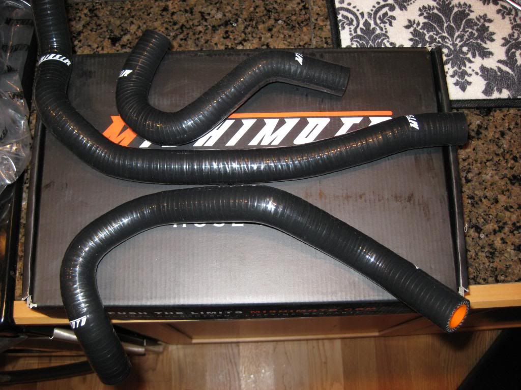

Small update, got some heater coolant hoses installed and it was pretty much what I expected. PITA, especially getting the old return hose off. I still have one hose that I want to swap for a new silicone hose that's leaking towards the rear of the engine on the passenger side. I tightened up the hose clamp that was on it and that seems to have helped, although I still have a feeling I should replace it.
Posting one pic of the hoses pre-install with a couple more to follow shortly.

Hoses look good.
I'm in the process of installing mine as well. Mine are the generic Ebay silicone full-engine set that a number of people on here have picked up.
So far, they seem to fit nice and tight, and are shaped properly to replace the originals.
