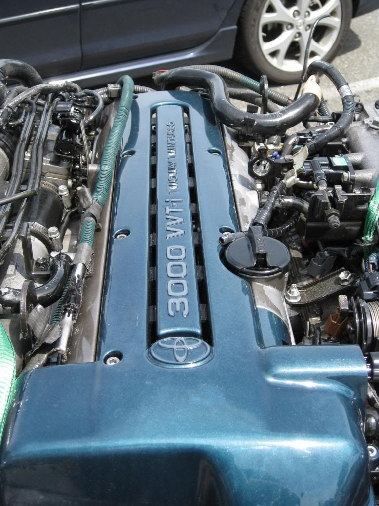

Actually I think it turned out great and I liked how "plug n play" the whole mod was. If I had to say something negative about it, that would have to be where the last coil sits on the 6th cylinder plug is directly in the way of where the throttle cable assembly sits and it was a small PITA to get both of them installed at the same time. Changing spark plugs will be a bit longer of a process due to that alone. Other than that, the mod is awesome!

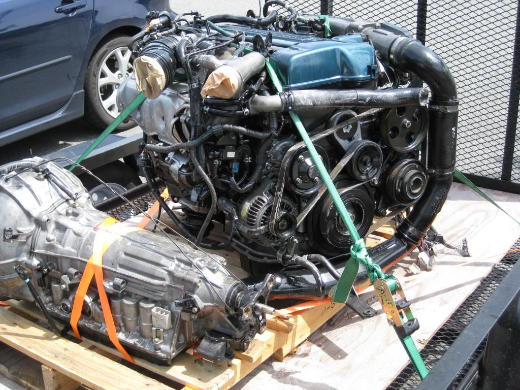

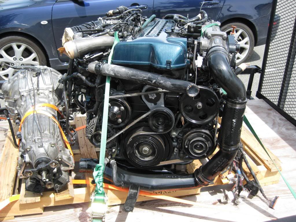

I'm pretty happy with the car as it sits now and will likely be leaving it the way it is for awhile with maybe the exception of an IC/hard piping kit but the reason for that is I recently picked up a JDM 2JZ from an import company in Lynnwood, WA for a decent price. It's the turbo version with VVT-i and my plan for it is to build it for 800 to 1k hp and put 550-600 hp injectors in it for the time being. Once I finish building the motor, I plan on dropping the subframes and doing a proper rebuild of the entire car. This will likely not be for a year or two while I amass some parts and build the 2J.
Pics when I get home today!

As promised, the porn...

Might go snap a couple more pics of the engine in it's current state (in process of being torn down) but I need a bigger breaker bar to get the crank shaft pulley bolt to budge and get it down to just the block/head.
