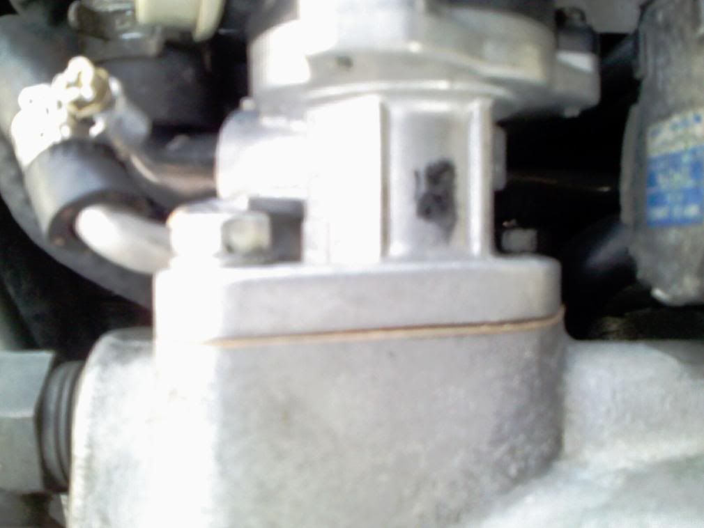

I need someone to help me trouble shoot why my 7m is not running smoothly as it should. Here's the problem when I sit and idle the rpm jumps up and down from 600 to 800 continueously. Rough idle, the TSRM says vacuum leak. I think we found it or one of them at the idle control valve on the intake tank. The gasket between these two pieces does not seal all the way tight. There is a small gap. It's a new gasket so I'm stummped but when you spray carb spray in it it idles normal and smooth. Do I need two gaskets? The one gasket doesnt look thick enough.
