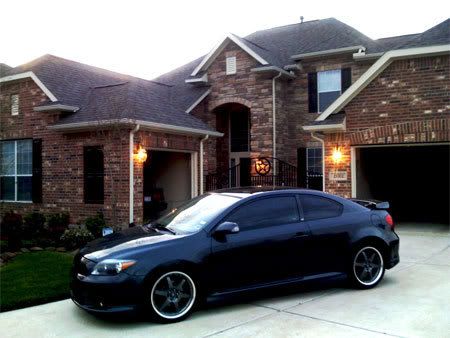

So after some unexpected problems with my DD, I'm back! And I'm ready to work!!!
Had to put new tires on again. 4th set in 29,000 miles. My alignment was WAY out of wack so it was eating through tires like butter. Needless to say, that's fixed.

Wow. Your tC was chewing them up. I just got my second set last summer, and the car has just over 40k miles.
