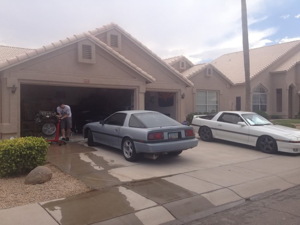

Here's my POS. Previously owned/parted out by Clint G. When I heard he was parting it out, I couldn't help but think about what happened to his old gray car RIP and I couldn't let that happen to this one so I decided to buy the shell and save it from a sure death. I picked up a 1JZ August of 2012 with the intention of putting it in my white 87 but plans changed and the motor has been sitting ever since. Now I am just trying to piece together the swap and get this thing back on the road.

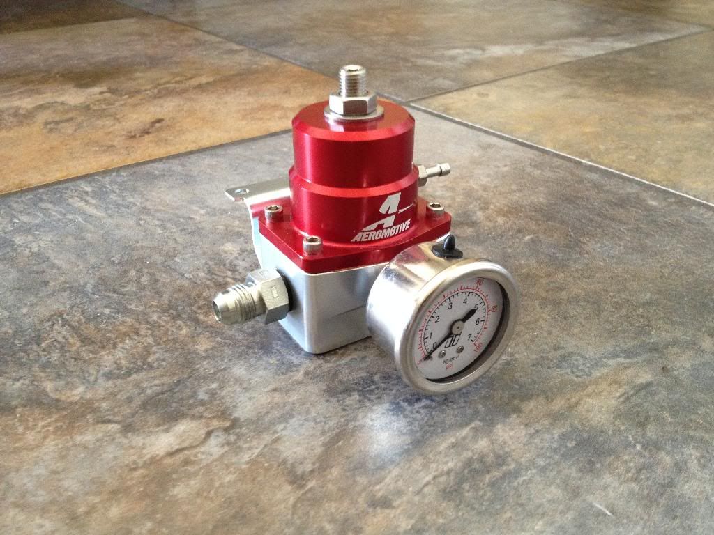

Fuel System:
Dual Walbro 255 Pumps
Aeromotive AFPR

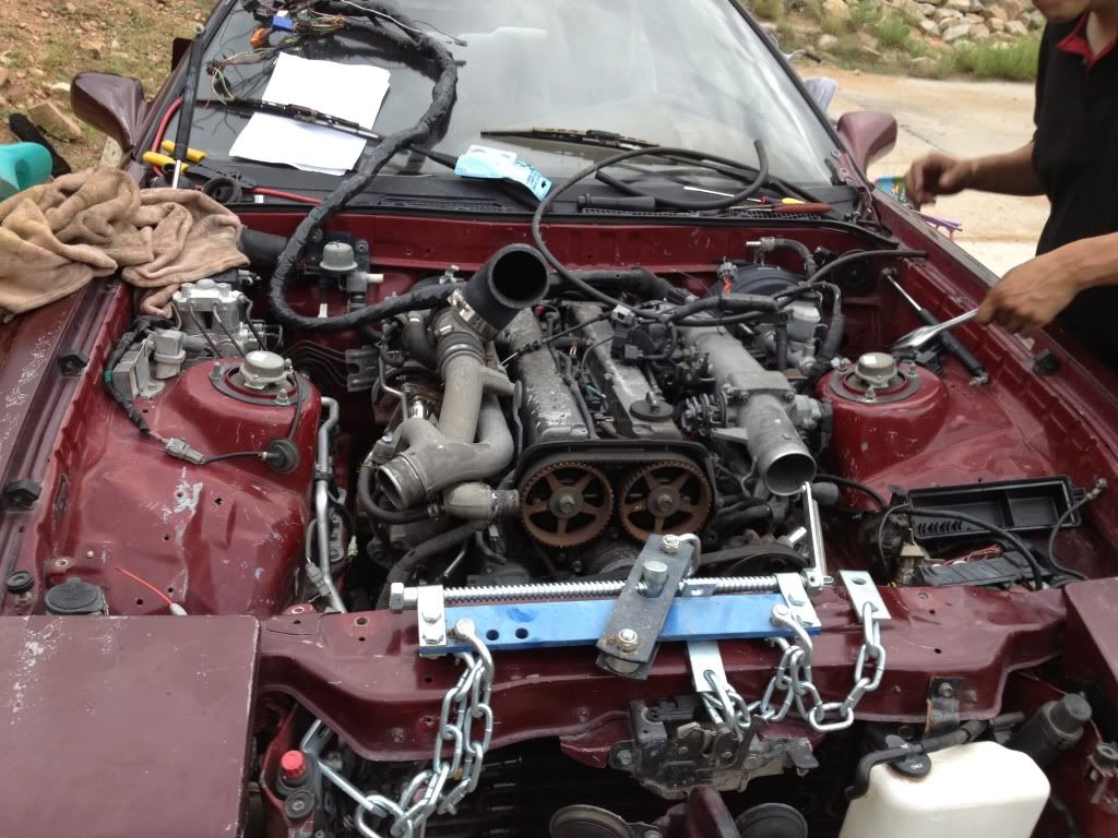

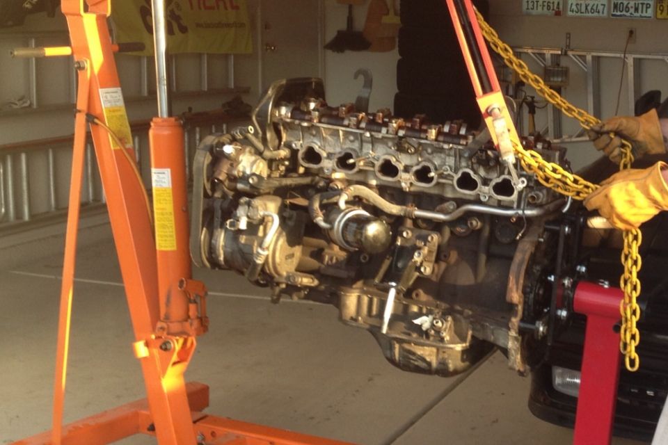

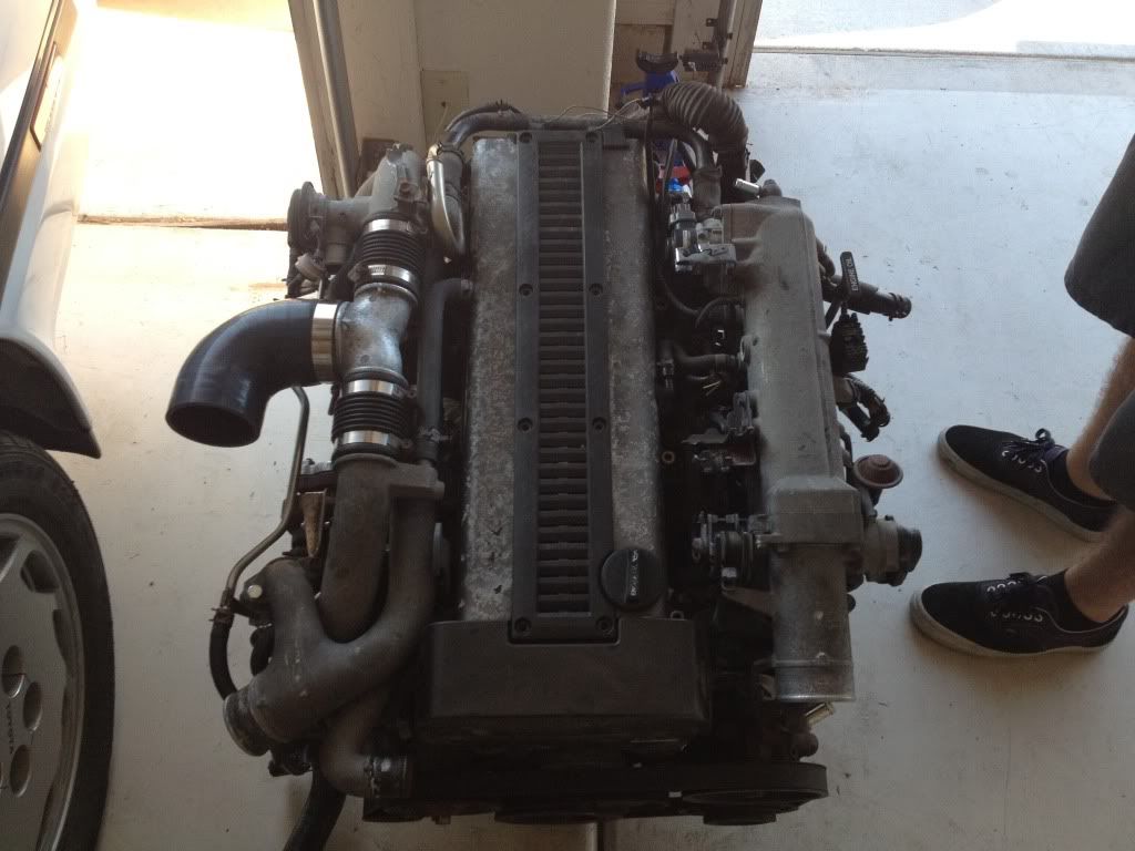

Hey guys sorry its been so long since I've posted on this but.....Update!

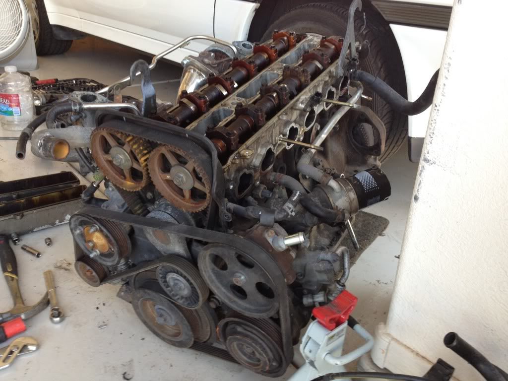

Here is when I got the motor from an owner who attempted to a 1jz swap
Tear down! Notice the nastiness :barf:

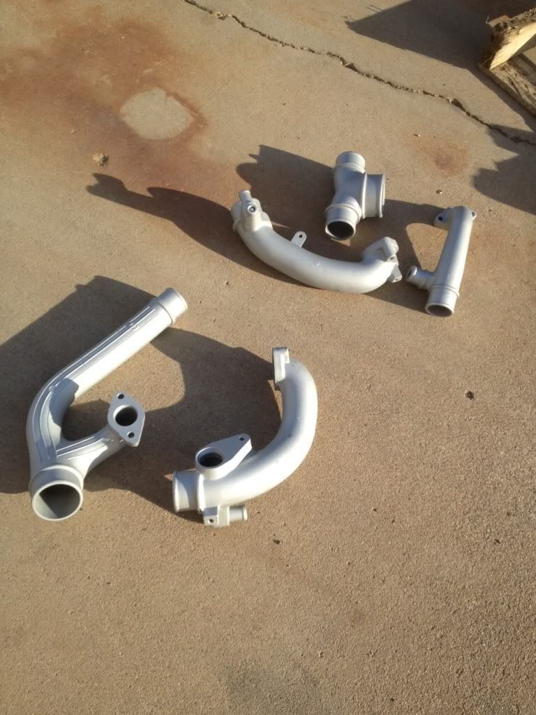

Paint :D

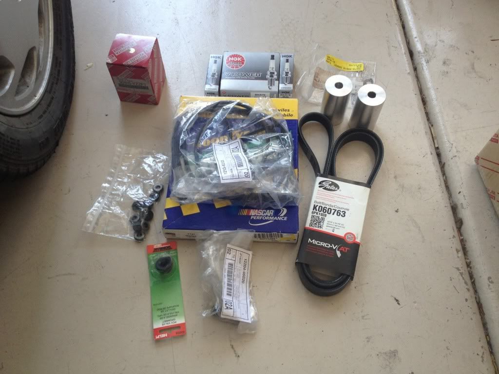

Belts/ Seals

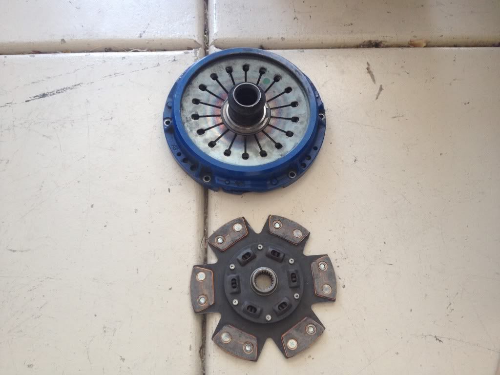

A used 6 puck...

Radiator Came in!

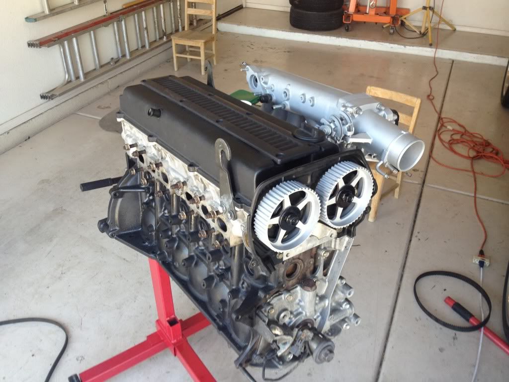

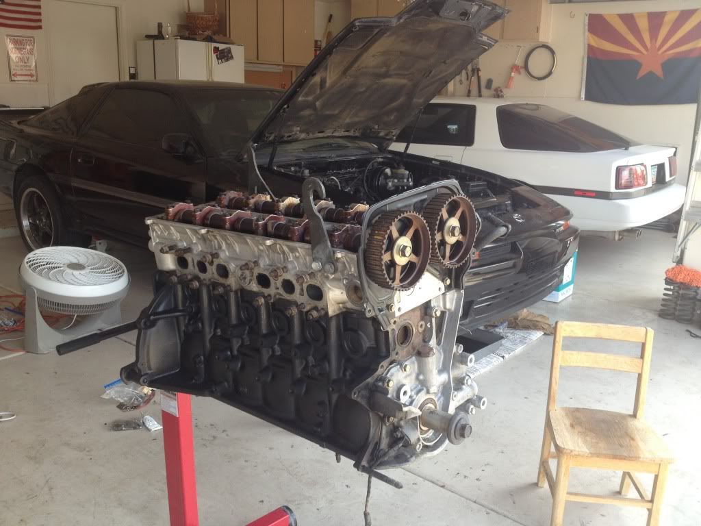

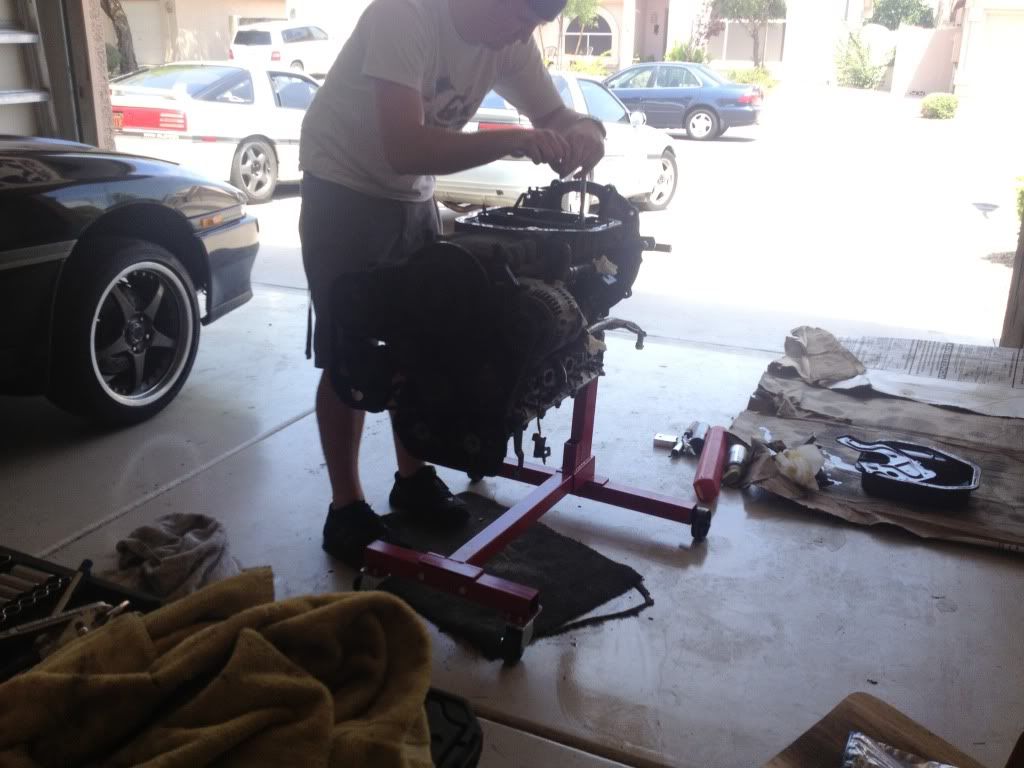

Got the motor on the stand

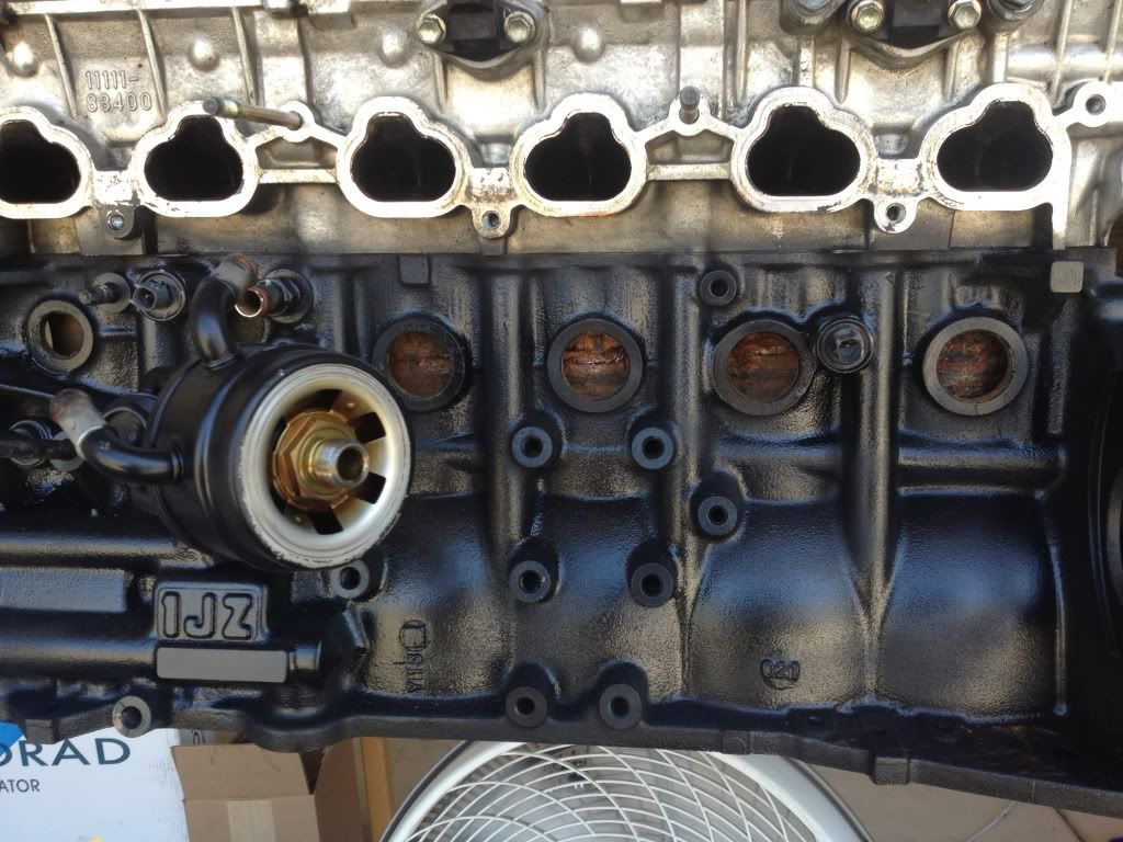

Albert came over and we tore it down to inspect the bearings and paint the block. The rod bearings looked amazing! Super happy about that
During the cleaning of the block we discovered a little problem :unsure:/>
https://www.youtube.com/watch?v=cu5FhvGiimg
Paint!

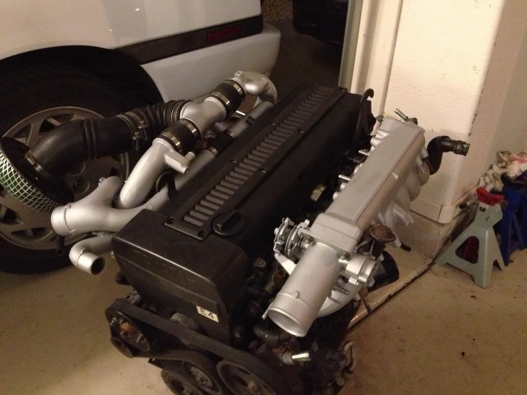

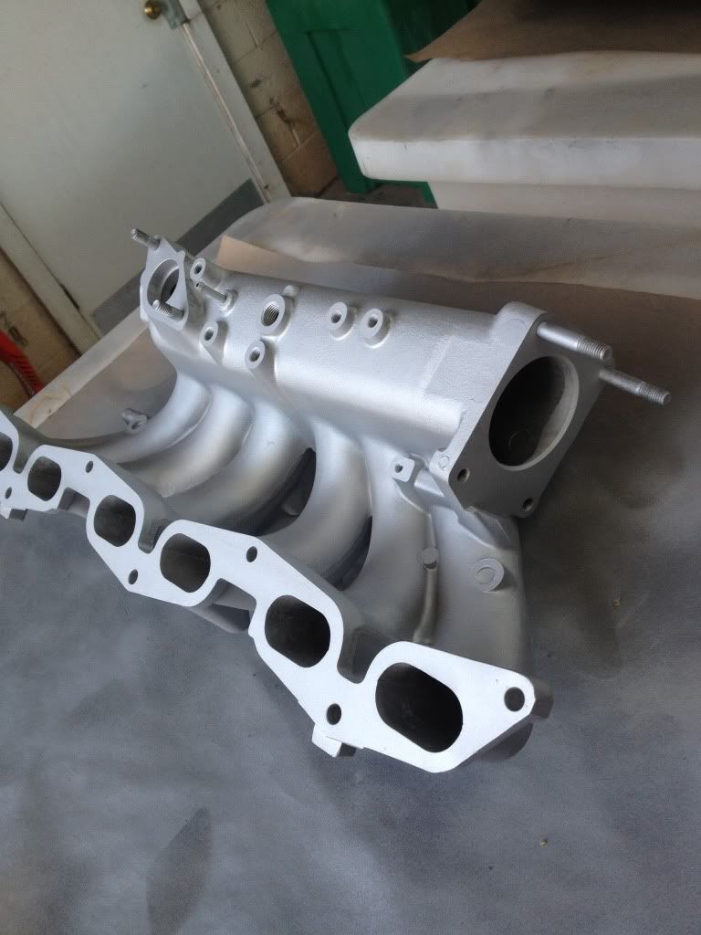

I decided to paint a few other things and mock it up. Looks so tits

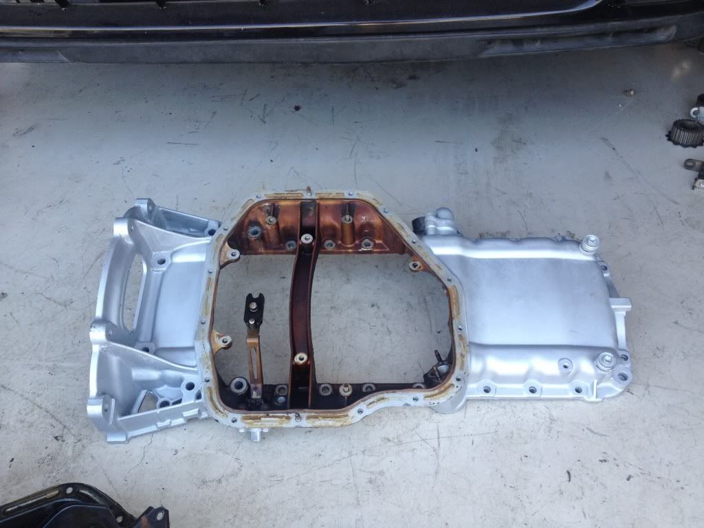

Cleaned up the upper pan.... took fooorrrrrevvvverrrrrr.
Took all the Sh*t back off, popped out the freeze plugs and replaced them

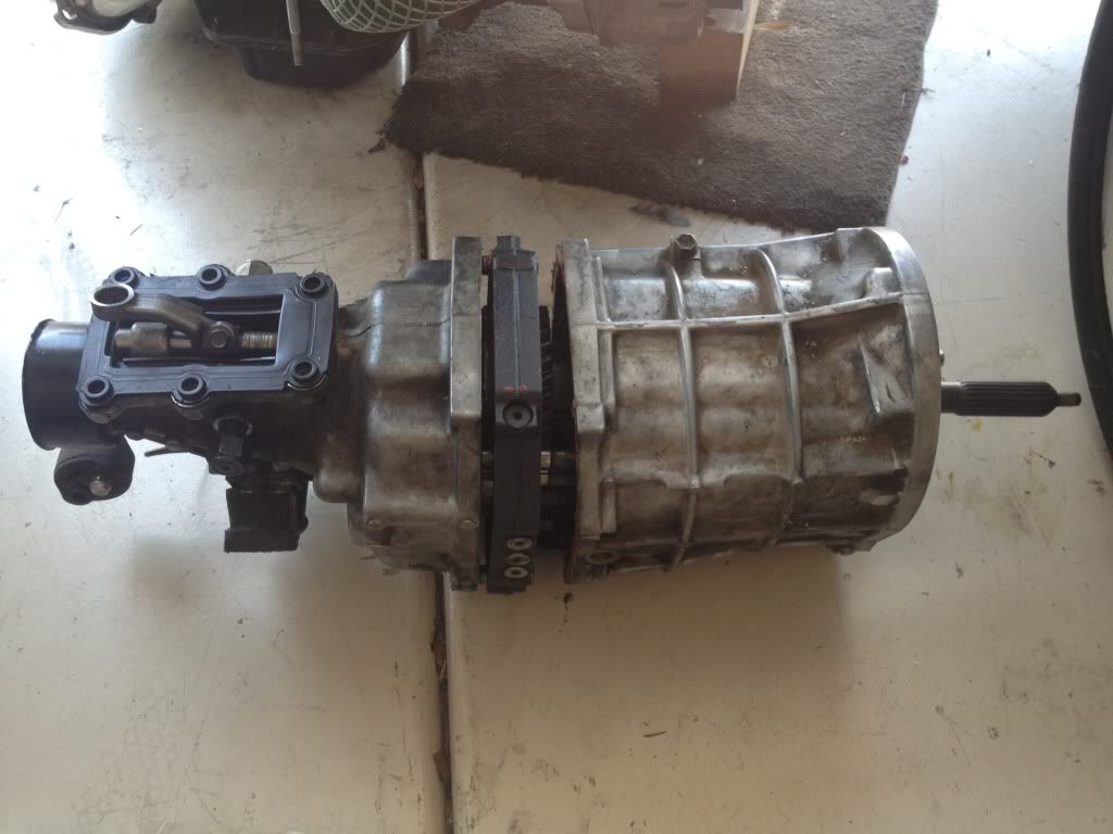

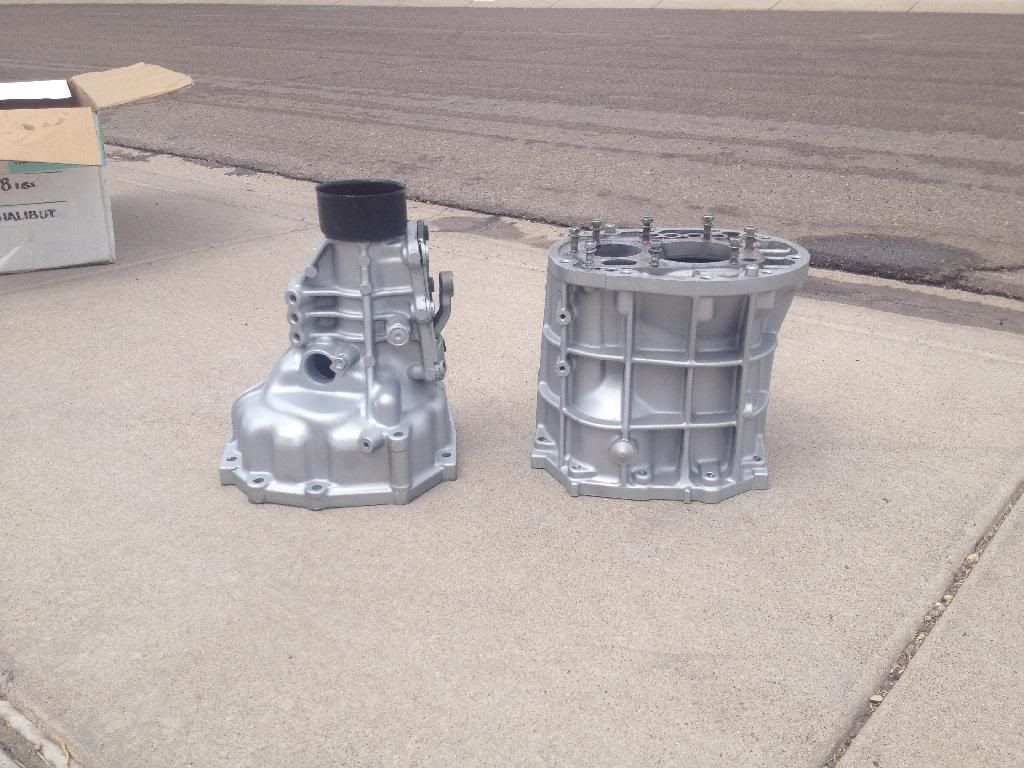

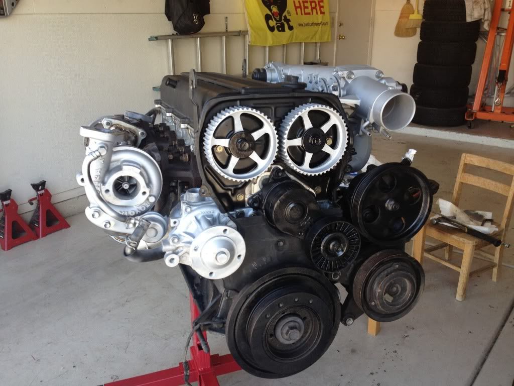

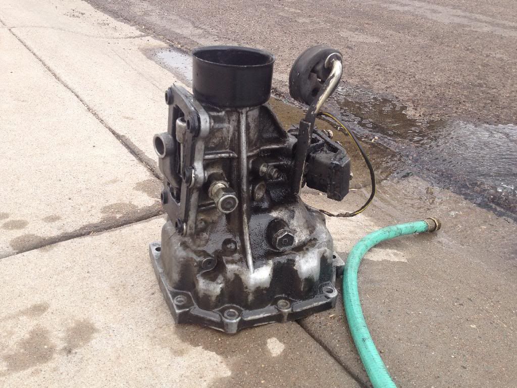

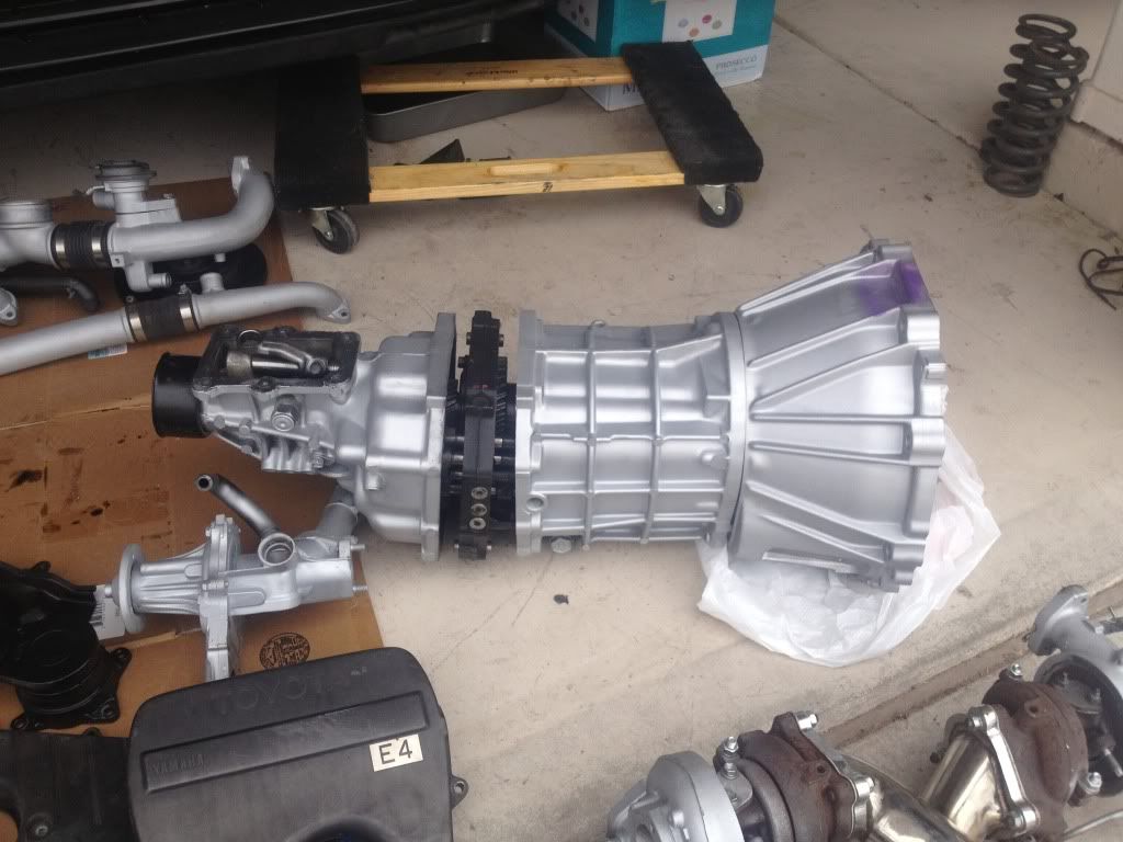

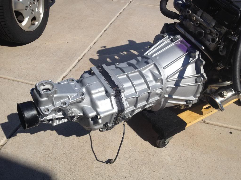

Took the casings off the R154, cleaned and painted them. Took forever! Everybody that drove by looked at me like what the hell is this guy doing.

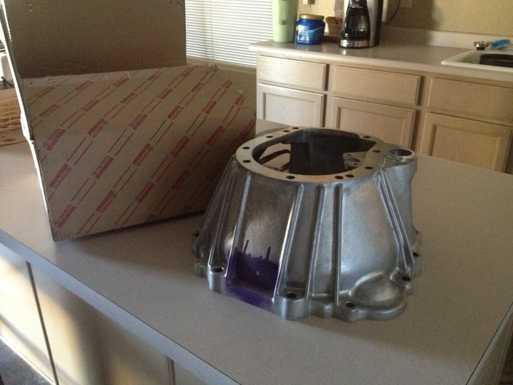

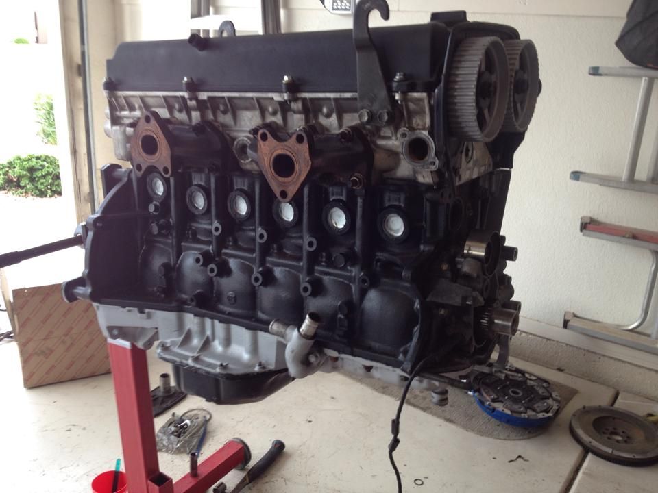

Bell housing came in so I painted it and slapped it on

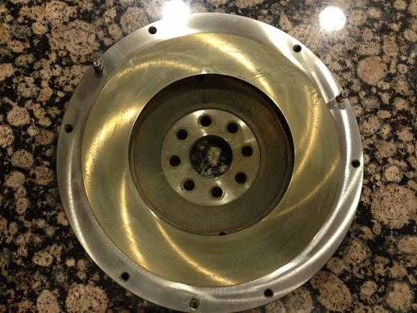

Found a flywheel on Craigslist for a decent price, got ARP flywheel bolts put it on and mounted the trans

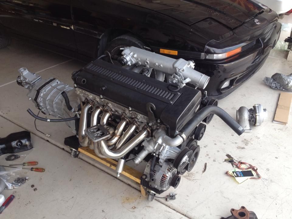

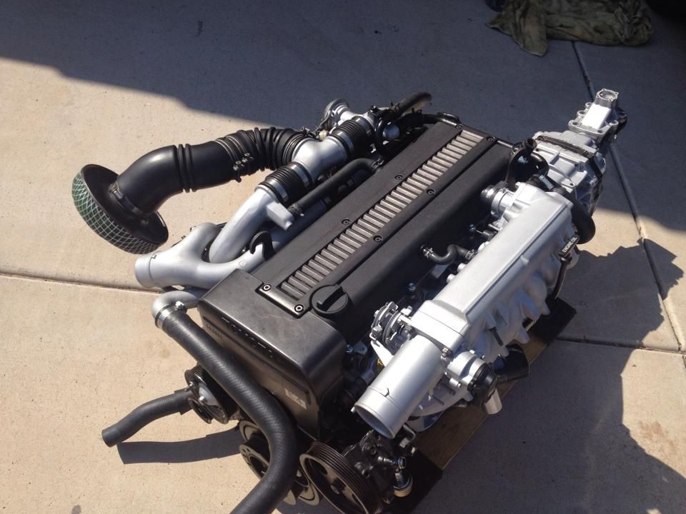

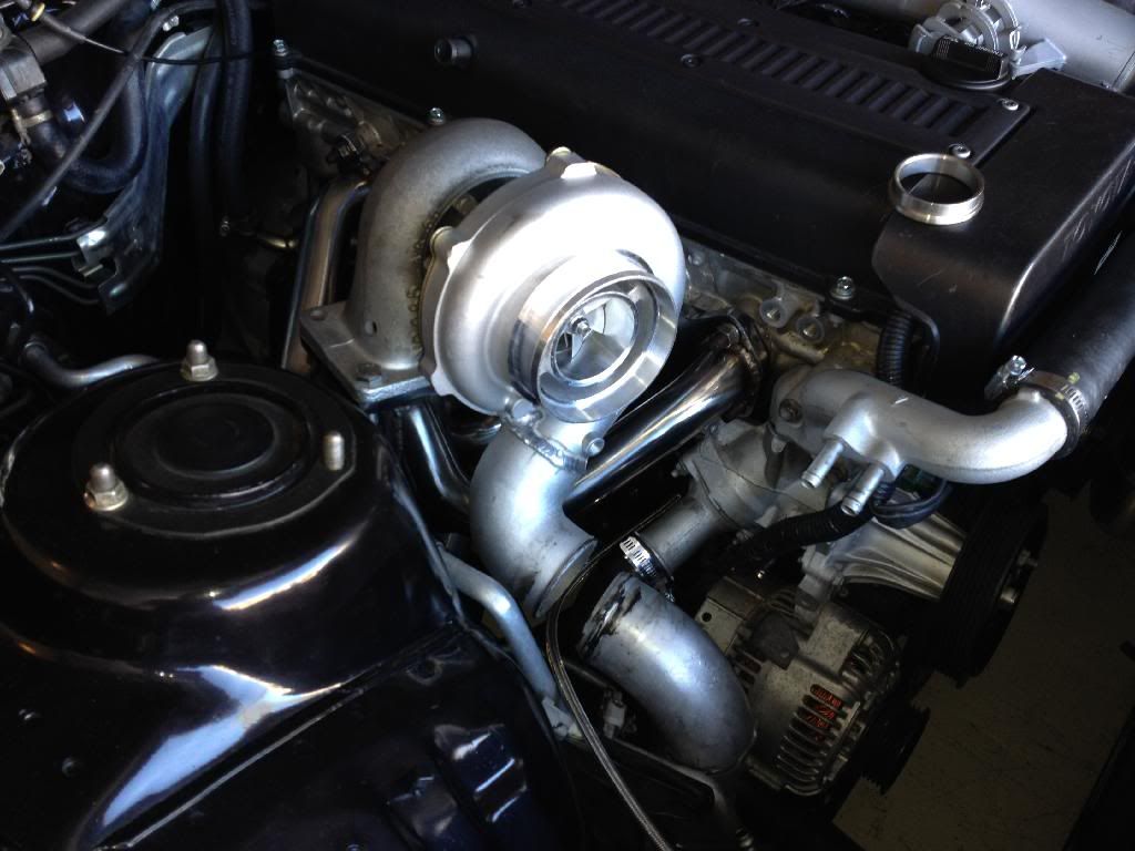

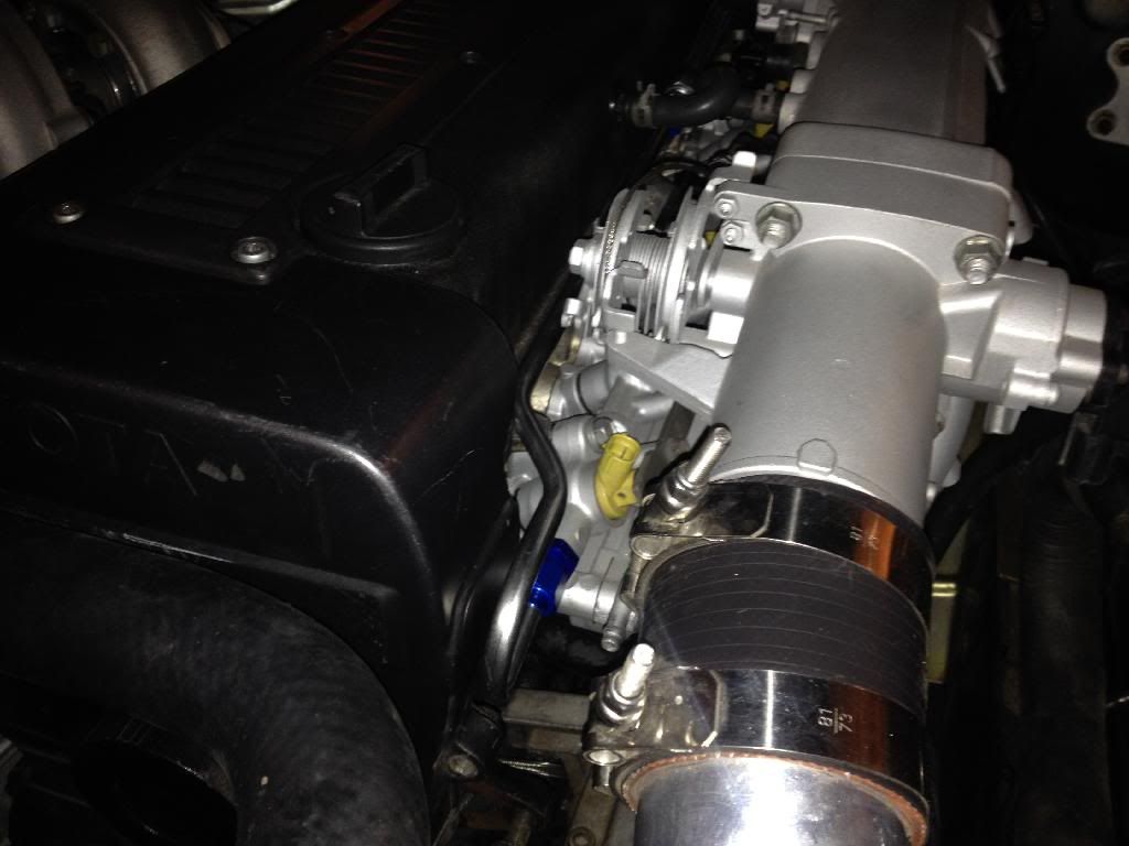

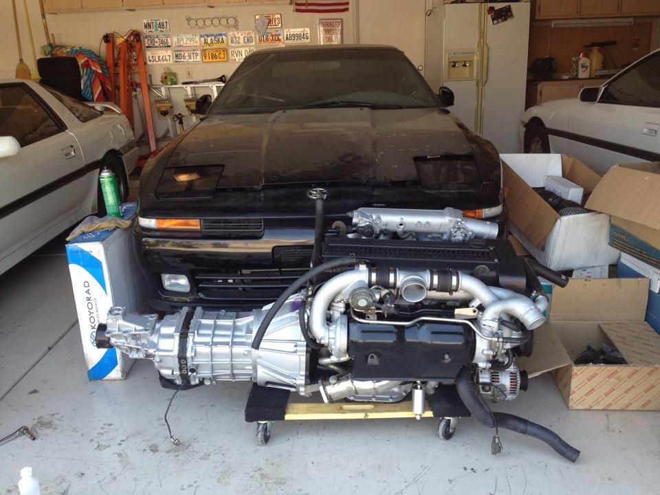

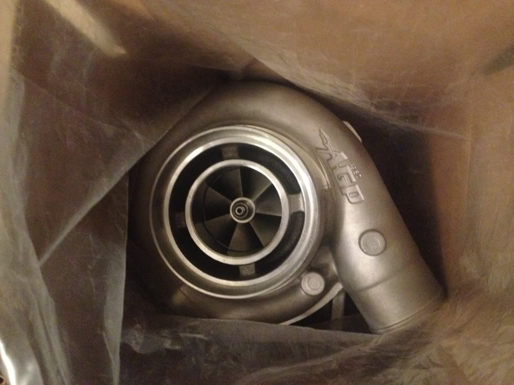

After all the work making the twins look good, Albert talked me into going single. After trading a few parts he gave me this.
Borg Warner s256, AGP 4960 Anti-surge housing 4" inlet 2" outlet, Master Power .68 A/R Exhaust housing. :wackit:

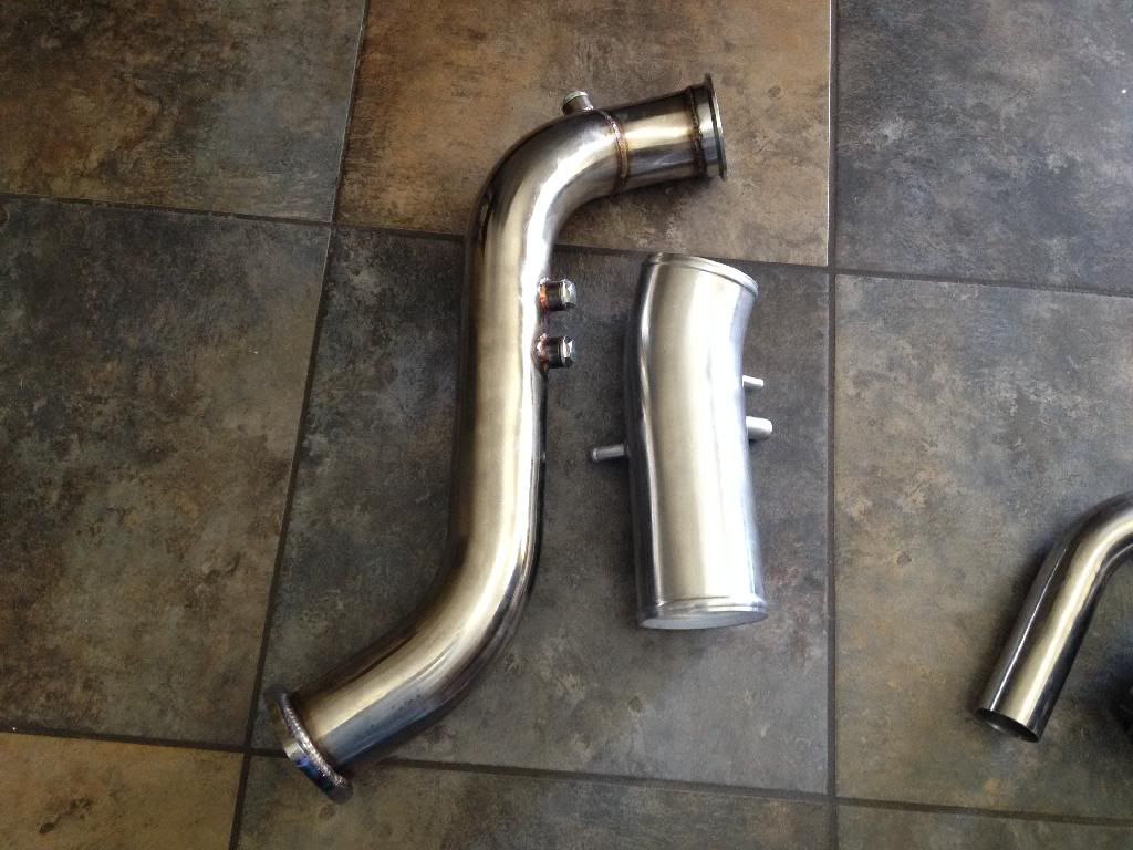

Ordered a few goodies from DM. After waiting for what seemed like forever they finally came in!

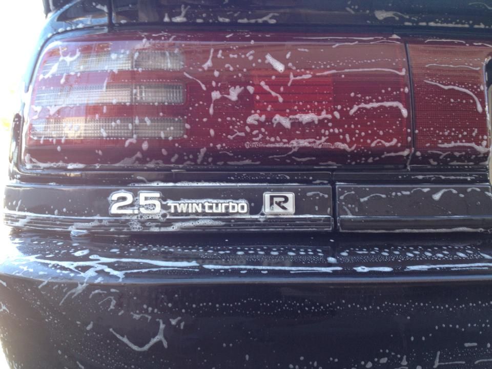

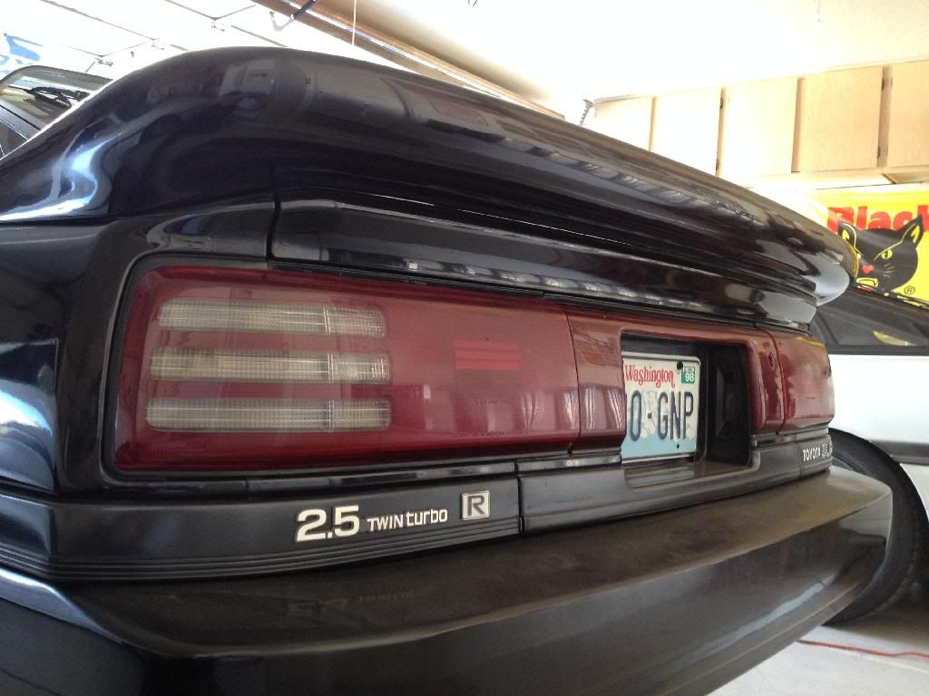

A year of bugging the hell out of my friend about his JDM tail lights finally paid off. Looks so much better with the TT-R trim than the American ones.

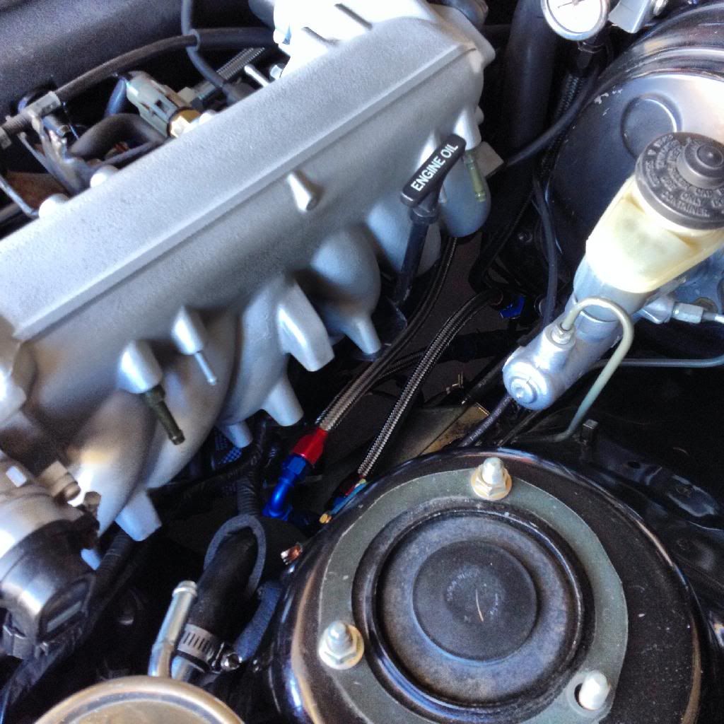

Oil line kit

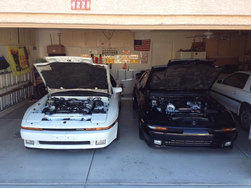

Nice car, I always saw it in your signature but never knew it was Black Ruby. That's definitely a very pretty color. Also, I like the three car garage filled with three Supras. Very Nice!

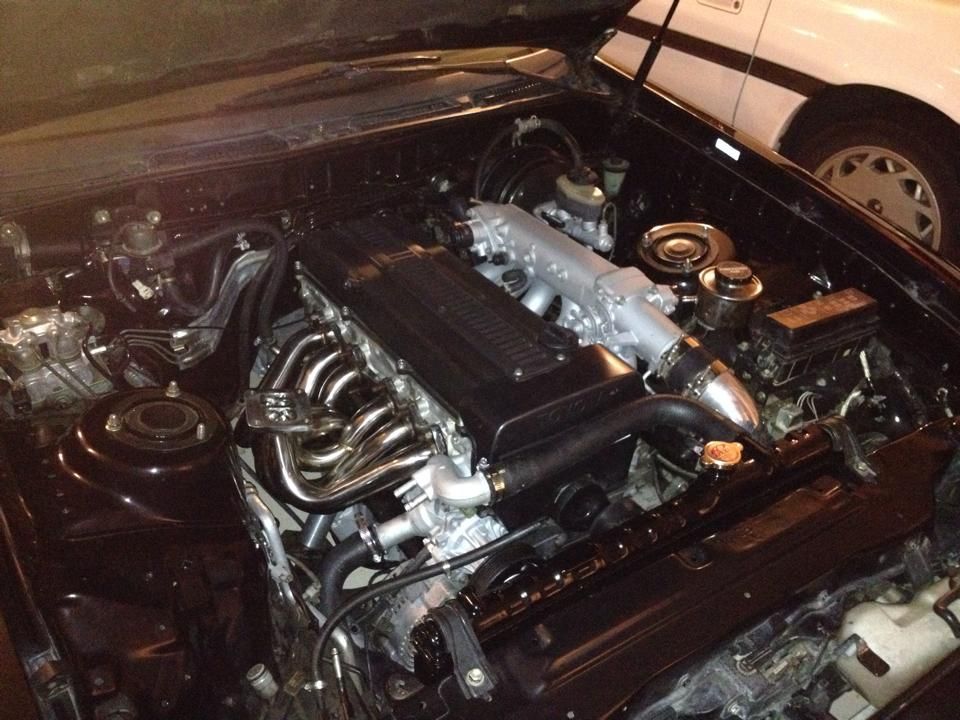

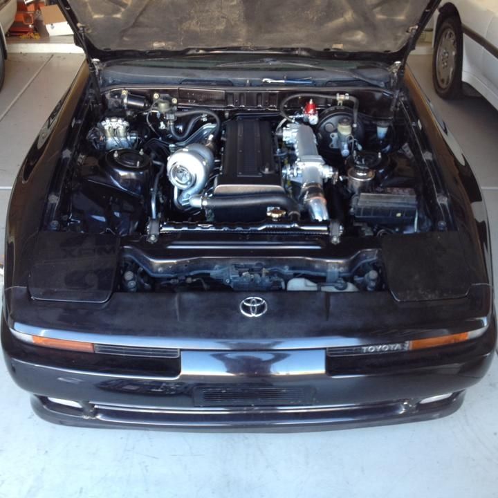

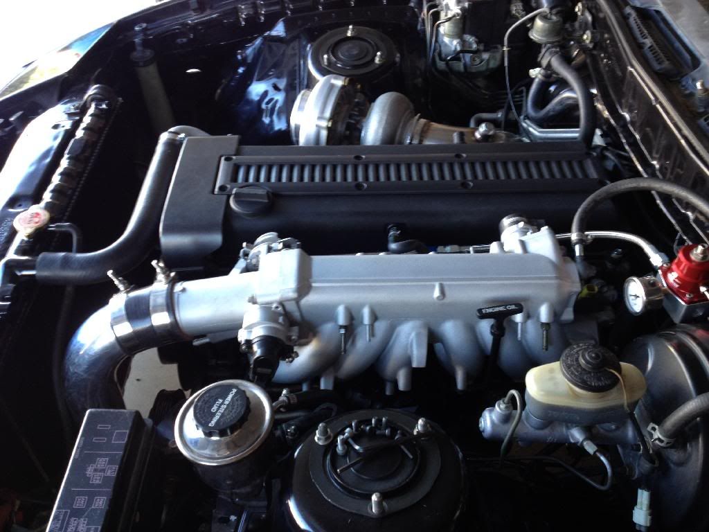

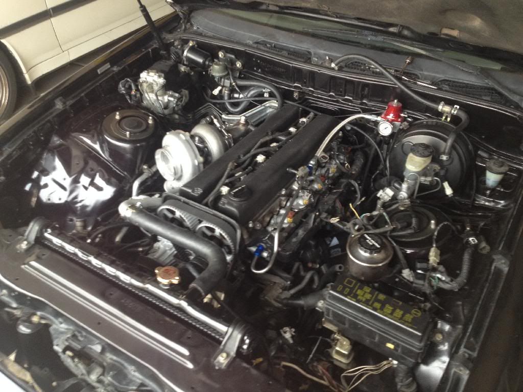

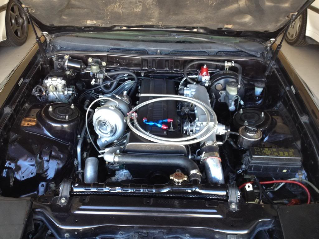

Update!!!
Picked up an uncut JZA70 harness, ECU, map sensor and intake temp.
Harness ran
Ran fuel lines for the dual walbros to a stock rail

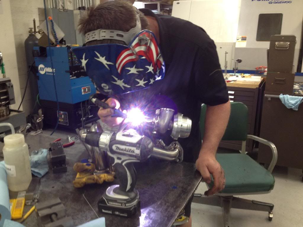

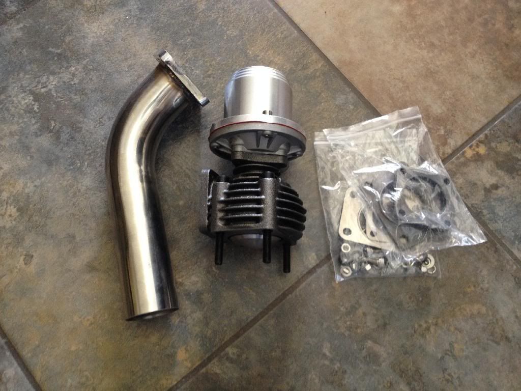

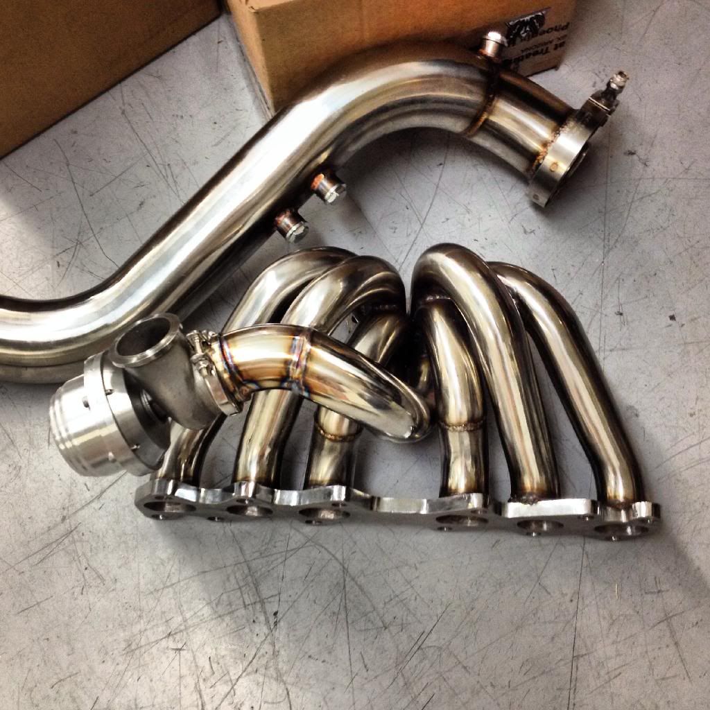

Modified the chinafold for the wastegate to fit and welded a 90 on the turbo

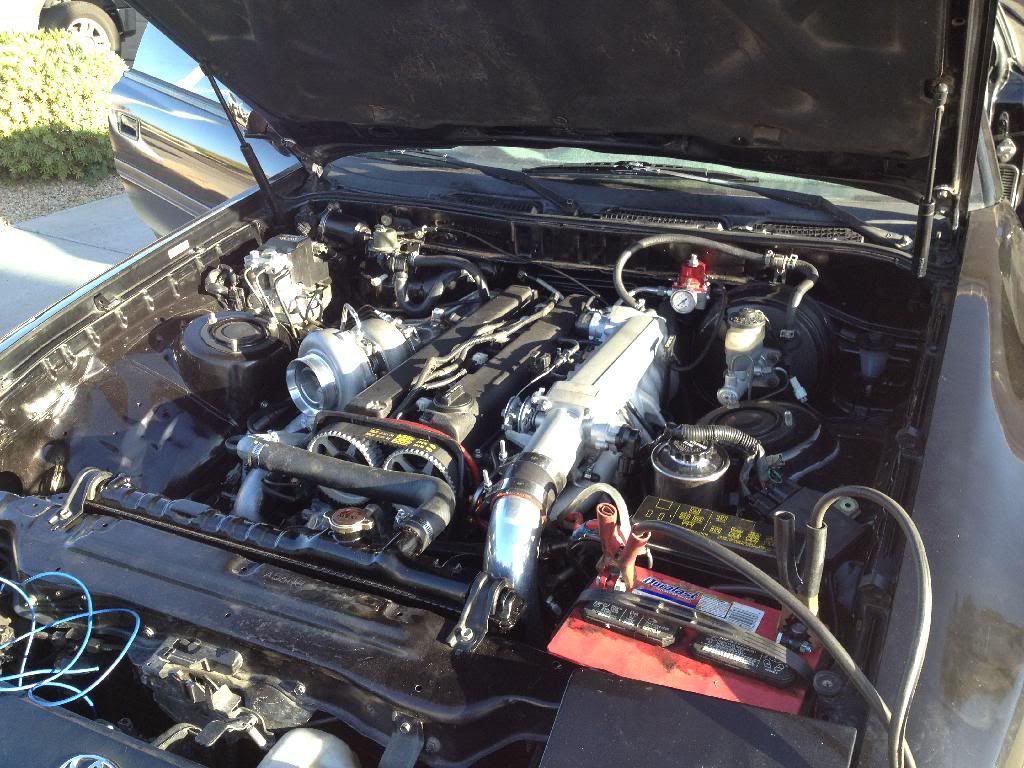

First start!!!!
http://youtu.be/KYdNGlIwn_0
As you can hear the motor isn't firing on all cylinders. The previous owner of the harness was running a 2jz ECU and had the injectors set up for sequential. He said he changed it back to batch for a stock 1j ECU. I couldn't figure out the issue so I pulled car out to run some tests on the wiring for the injectors
Spent at least an hour trying to figure it out when I noticed the check engine light was on and thought I would check codes. When I popped Open the diagnostic box there was a jumper from FP to +B... Took that out and the car ran fine
Second Start!!
