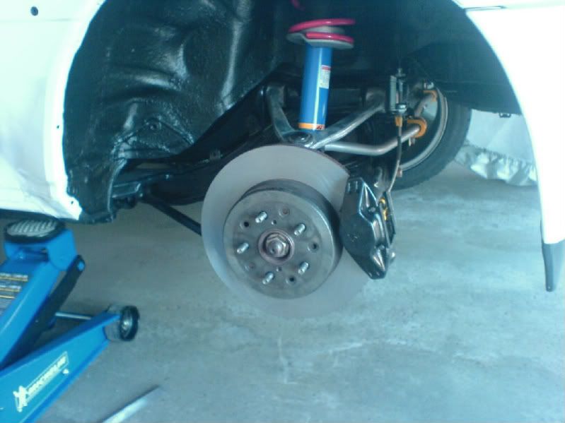

IJ.
Grumpy Old Man
38,728
61
I come from a land down under
265 front 285 rear DBA 5000 Mk4TT fronts and dba 4000 Mk4 rears AP calipers front and rear.
I generate enough Temp on the rears to colour the entire discs (this was after 55 turns averaging .7G lateral per turn and moderate braking for each corner)
