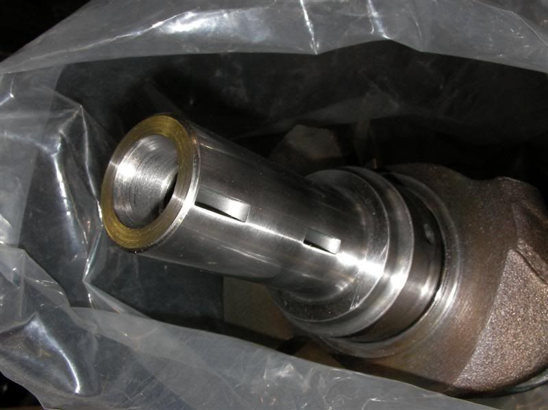

Ok ok, here's a pic. It's the custom snout on the 5m crank
gilberjj
Friend of Fast
Apr 14, 2006
661
Tacoma, WA
i don't really know what to look for cause ive never seen my crank, but it looks nice! keep on keeping on. i can't wait to see this thing in action. 8k rpms should be a blast! i think ill really get a stiffy when i hear this thing rev!

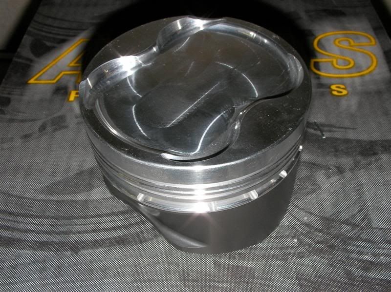

I want it to be at about 8.7:1 compression, or somewhere close. We are going to cc the pistons, head, check compression height, and then select the correct headgasket. It should be a 1.2mm mhg to do that, based on the measurements taken before the pistons were ordered.
