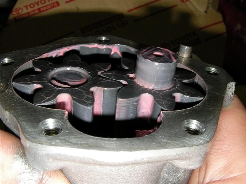

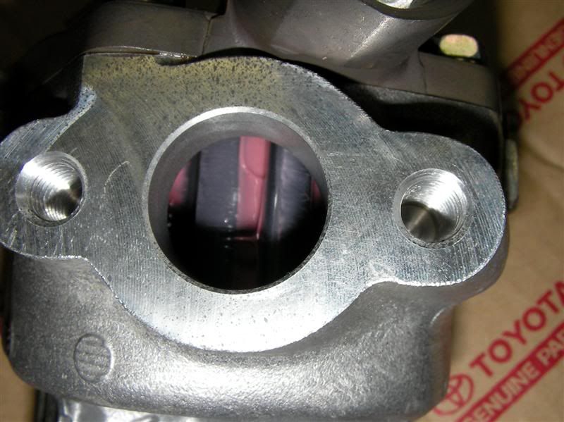

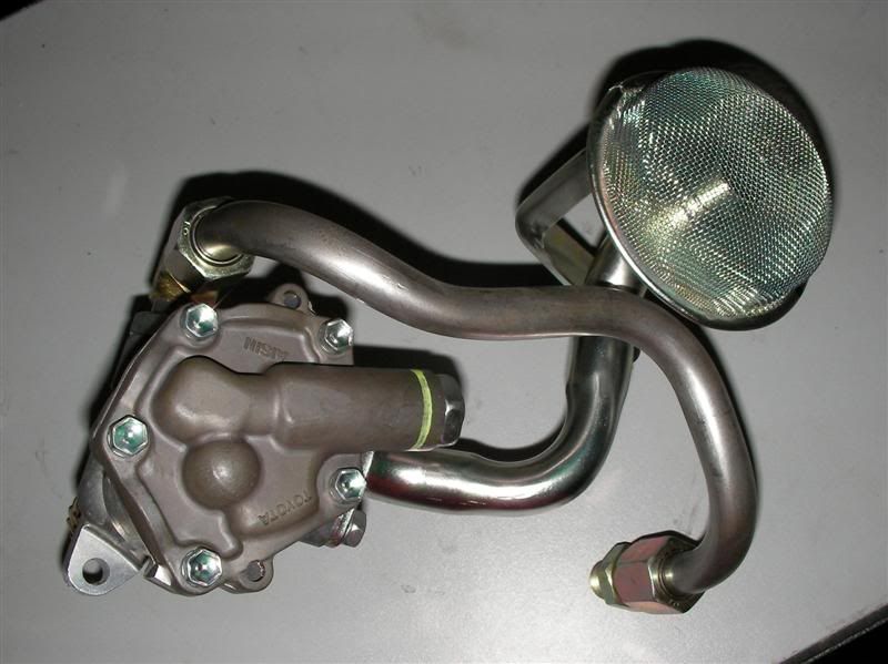

More cool stuff today! I got my oil pump back today! I dropped it off about 3 weeks ago to be blueprinted and moly coated. I had mentioned that I wanted to make a 7m oil pump flow better a few months back to the machinist, and the machinist mentioned that he had long been considering making a whole line of upgraded oil pumps for different engines. Since the beginning of this project, upgrading the entire oiling system was one of the top things on the list. I had already got the awesome ARZ oil pump hardpipe, and I'm going to go with all -10 AN lines to a nice big oil cooler and remote filter (that will eventually be the 7m oil cooler kit I have been saying I wanted to do for too long now).

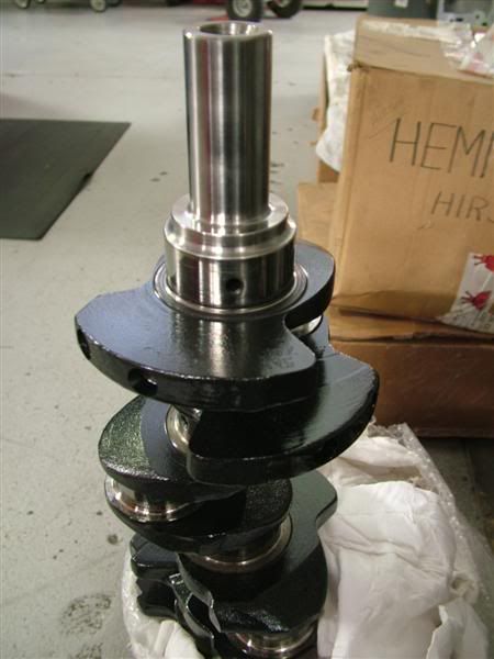

All the machine work is done on my engine now except a full balance job. Once the balance is done, the crank is going out for a oil-shed coating!

It's looking damn good, man! Remember, ATI rates that damper @ 500-550 SUSTAINED.
A quick blast to 650ish won't hurt things ;) I wouldn't do it at Duane or Nate's levels, though - that long ass crank is going to be wanting to wiggle on those mains :D
