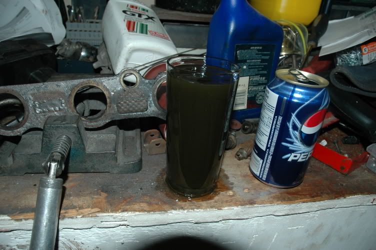

Marc: Ever made salad dressing?
Oil and vinegar shake them up and they mix let it sit and it seperates.
Oil and Coolant do the same.
If it's not seperating out I'd guess that the Mocha colour is just filth,varnish and crap from inside the engine mixing with the Oil.

ya but the cylinder 4 wasnt leaking in any.. weird.. for the oil, it dosent look like moka, but weird olor, and after a night of sitting theres no separated coolant...
and btw the head and block has been cleaned with a kind of acid.. so they r clean inside... but im in break in so it makes more shit in oil...
here is the oil in a clen recipient :p
