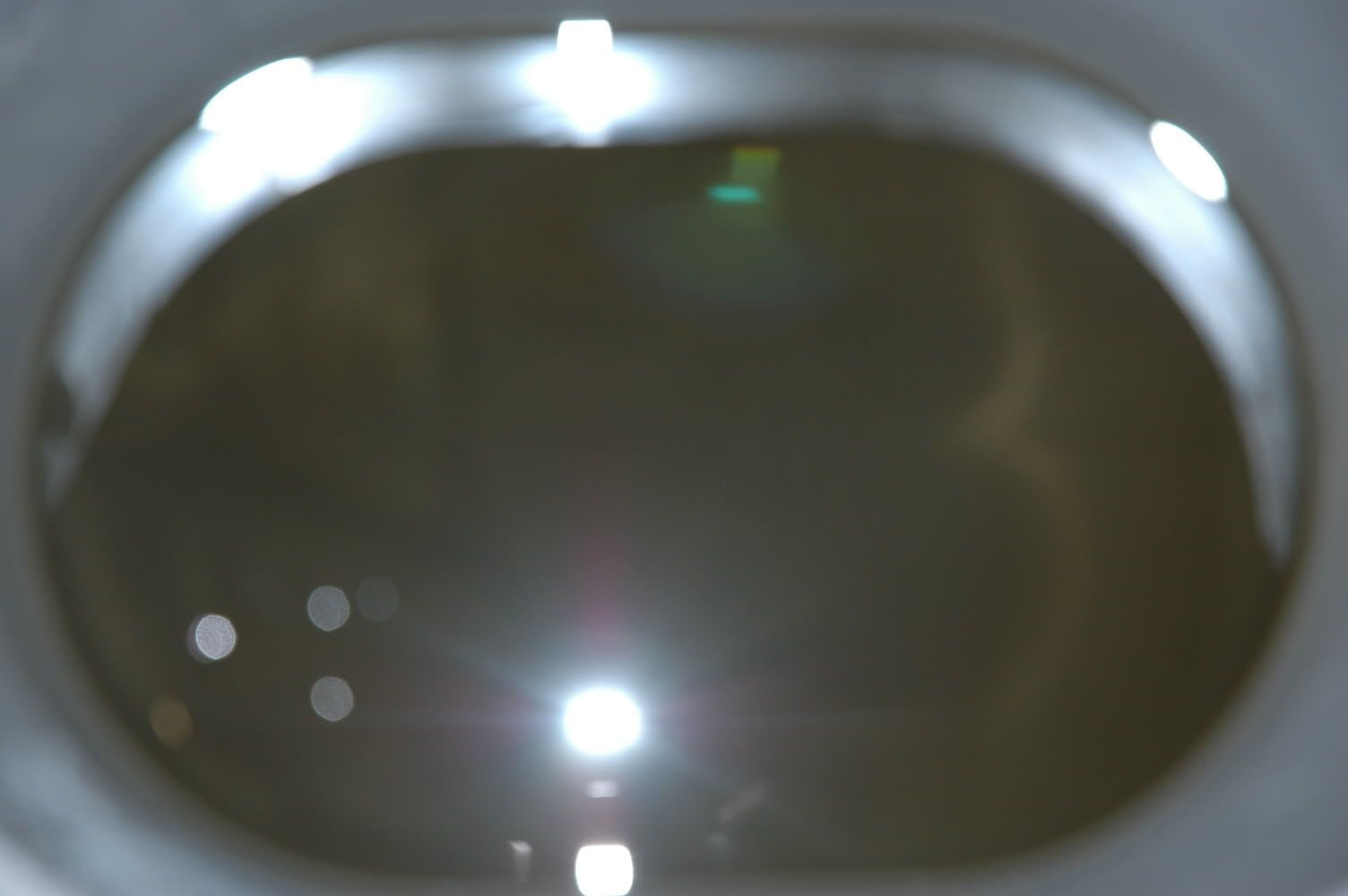

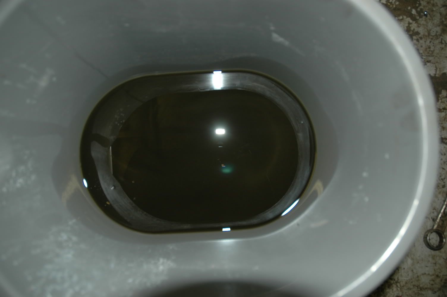

here is the 2 pictures of my oil, after 15 mins of running :O notice that im in break-in period for the engine since it has new rings...but look like moka coffe?
whats next?

Leave the oil sit overnight and see if any coolant seperates out.

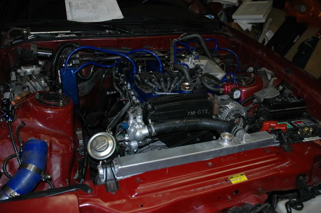

Poodles;1086074 said:
Also, it looks like your PCV system is BLOCKED...
Not good for break in of the rings...or the rings in general..
what you mean? catch can wrongly installed? ya i thought it was bad but why there is only 2 hoses in the catch can :O? 1 per valve cover hole.. but no breather? i should pierce a hold in my can, and put a breather in?

IJ: look at his photo, the catch can has two hoses and one goes to each valve cover.
You've effectively SEALED the crank case, that's very bad for the operation of the rings and can blow seals out...

Nice catch Poo!
The pic is so dark here I can't see jack on it so I saved it and brightened it up some.
Bob: With it plumbed that way as soon as it runs with the poor ring seal it's pumping the crankcase full of pressure and it has to go somewhere.
I'm a bit surprised it hasn't popped a seal or two yet.
There needs to be another line from the catch can to the accordian hose but for now remove the CC and replumb everything back to stock.
That was very observant...good job poodles!
