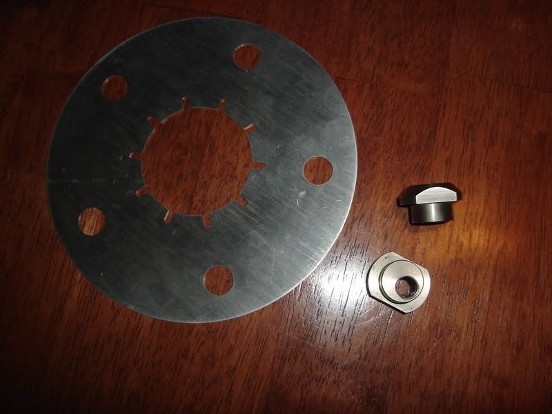

Local machine shop is the best source - in my case, I had them made by my machine shop at work. They're pretty easy to turn on a lathe - they shouldn't cost more than $50-75 bucks. 4130 is probably one of the better material choices.

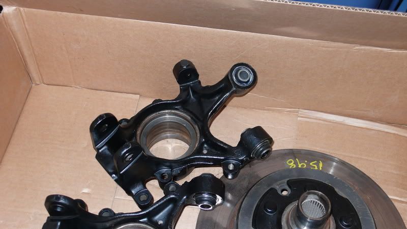

adampecush;1438190 said:
While there are people who have drilled the rear tabs with success, you are asking for problems drilling into a casting, especially when you leave less material and increase the braking force on the tabs.
Which casting Adam?
adampecush
Regular Supramaniac
May 11, 2006
2,118
Edmonton
the rear axle carrier, which contains the brake tabs.
When I disassembled and sandblasted mine, it certainly didn't look like a forging.
tsuper92
supra addict
Apr 7, 2005
1,376
54
mass
there didn't seem to be alot of meat on my hub carrier's.i would have been a little worried about drilling them
63
I was 99% sure they were forged but I'll have a close look at one of my spares when I get a chance to confirm.
I agree though the offset mounts are the way to go.
adampecush
Regular Supramaniac
May 11, 2006
2,118
Edmonton
looking closely at these pics, you can see markings consistent with the position of risers/feeders (on the strut mount and the #1 rear arm attachment boss)...thats what I based my assumption on.
