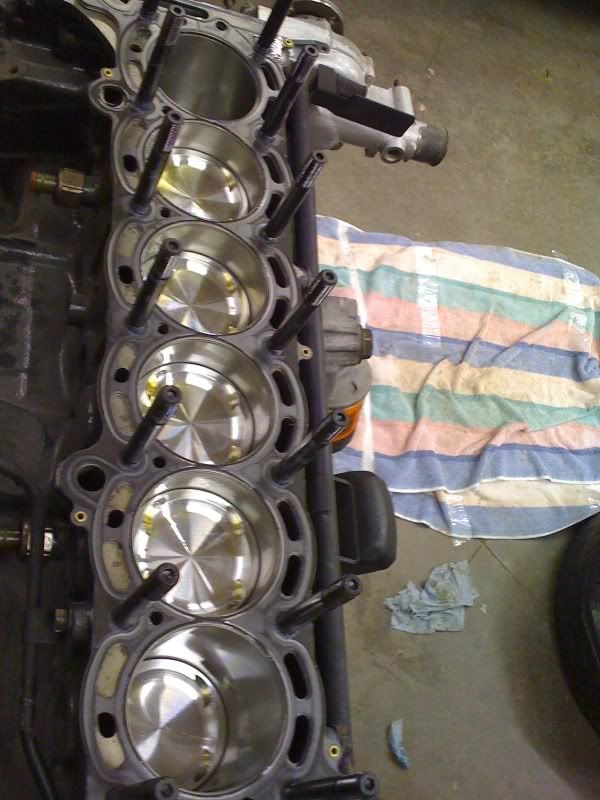

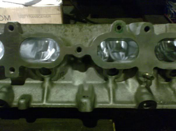

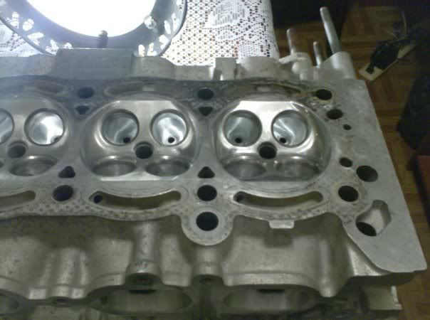

Funny built motor and head with a stock ct26.
