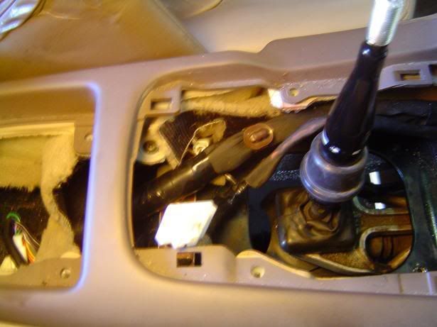

thank you for your excellent contribution...Excellent work! :love: You're motivating me to try this out with a 1JZ-GTE bellhousing and fit it into a Lexus SC300..you think it could work without shortening shift linkage assembly? (I always wanted the stock shifter to sit a little farther back)

hmm you could try jaws gear for the drive shaft solution

dejacky said:
limequat,
stock 5 speed w58 trans in a lexus sc300:
Sure, give it a try! Measure about 8 in from your stock location. That's where the shifter will be with a stock solstice trans.
