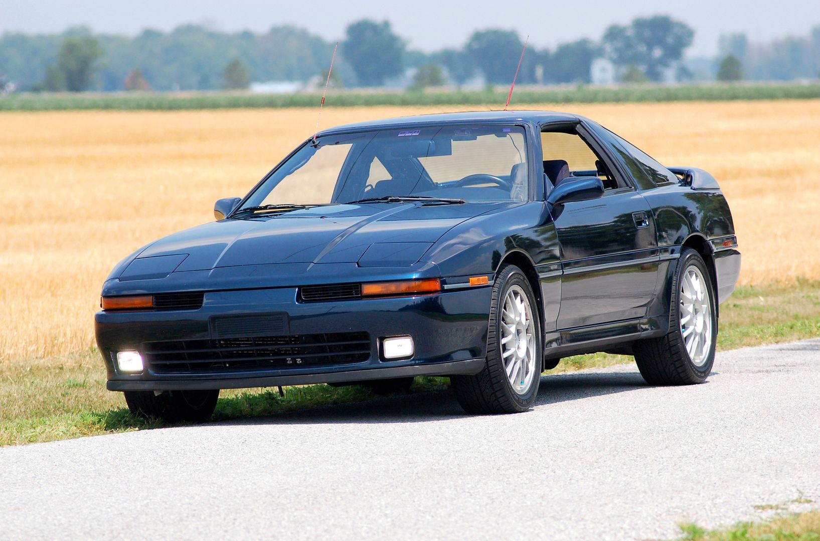

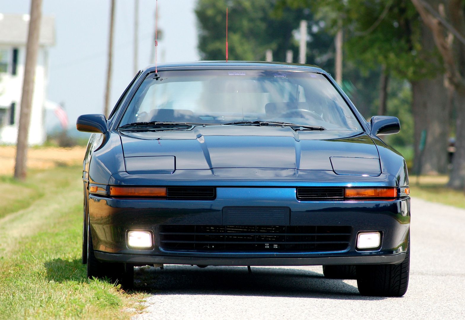

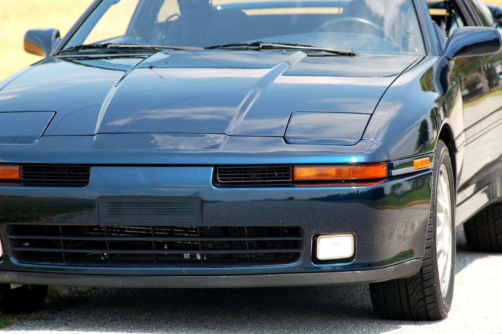

I shaved the emblam, headlight washers, antenna, door handles and smoothed the rear side bits of the "wing" so that there is no longer and seam. All in all I am happy with how it turned out and makes the car look sleeker and more up to date, IMO. Also did clear moldings with painted backs.

^^^ Also, no antennae through wing. Both body and wing filled when painted. (Maybe I'll find a pic around of the wing/antennae area later... but it looks MUCH better imho.)
NOTE: Mine is an '89...
