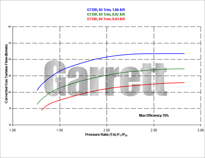

How would someone go about reading a turbine map like garrett has on there website? like how would u read this...
how do u figure out what the pressure ratio and air flow is?

These are harder to interpret than compressor maps, but what it is telling you is the flow through the turbine at a given pressure ratio.
The pressure ratio in this case is the ratio of the pressure in the exhaust manifold to the pressure in the downpipe.
The flow through the turbine is the flow of the compressor plus the flow of fuel through the injectors minus the flow out the wastegate.
That's what the chart tells you, what conclusions can be draw from it are harder to understand from a purely theoretical standpoint. If you had collected some data from say a .82 housing this would give you an idea what to expect from a 1.06 or .63 housing in the same application.

The best way to look at compressor maps are to look at the innermost oval, and where the widest part of it is would be the most efficient part. On the side will be the pressure ratio...2.0 means you are running 1.0 of ambient (14.7 at sea level) and 14.7 psi of boost. thats the basic idea
