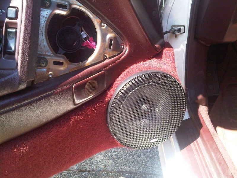

i have custom fibrglass pods on the bottom of door panels...i have 6.5 hertz high energy component speakers. Comes with the mid and tweeter and the crossover...great speakers but are a bit pricey since i think msrp is like over 500 bucks, but they sound great!...

sorry to take so long..heres the pics
