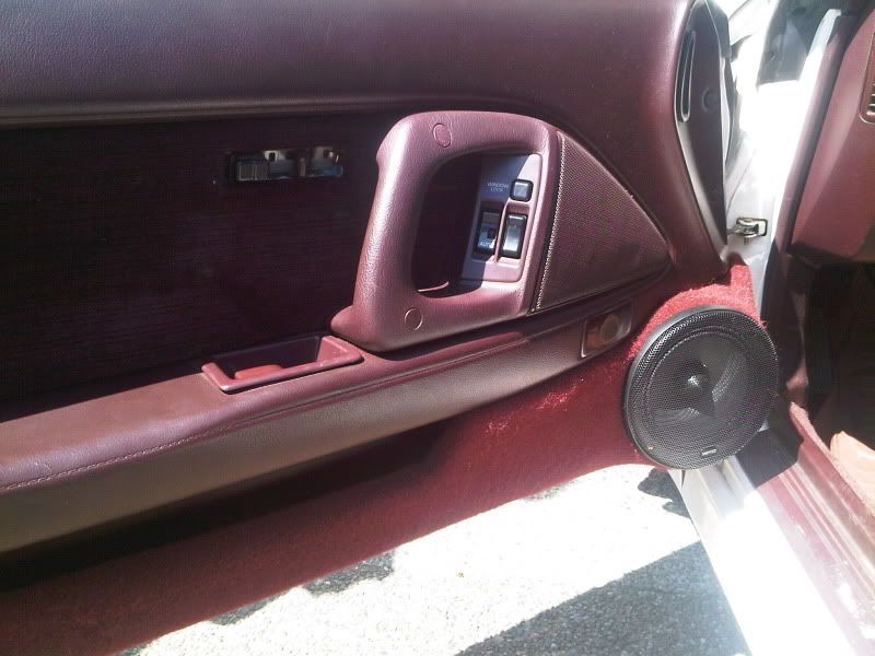

sorry to take so long..heres the pics
Bravo. thats awesome , thats acctually the second RIGHT install in a supra i've seen, besides tekdeuses install. There are lots of people that think if they can make MDF brackets and put 5 1/4 in them and use them with the pre 91 doors its a proper install. :dunno:
Heres what i came up with. I had to reinforce the panel to prevent vibration.
Fantastic! That's exactly what I was planning on doing. I have 2 sets of 6 1/2's and both are absolutely top-o'-tho-line. Some Old school Orion HCCA 6S components and the original British black cone KEF Uni-Q's (still NIB). I was thinking of going with the Orion's in the doors with 350rms going to each side (they can take it) off a HK TC600. What is the mounting depth of your speakers? How's the off-axis reponse? Did you build any enclosures behind them or are you running infinite baffle?

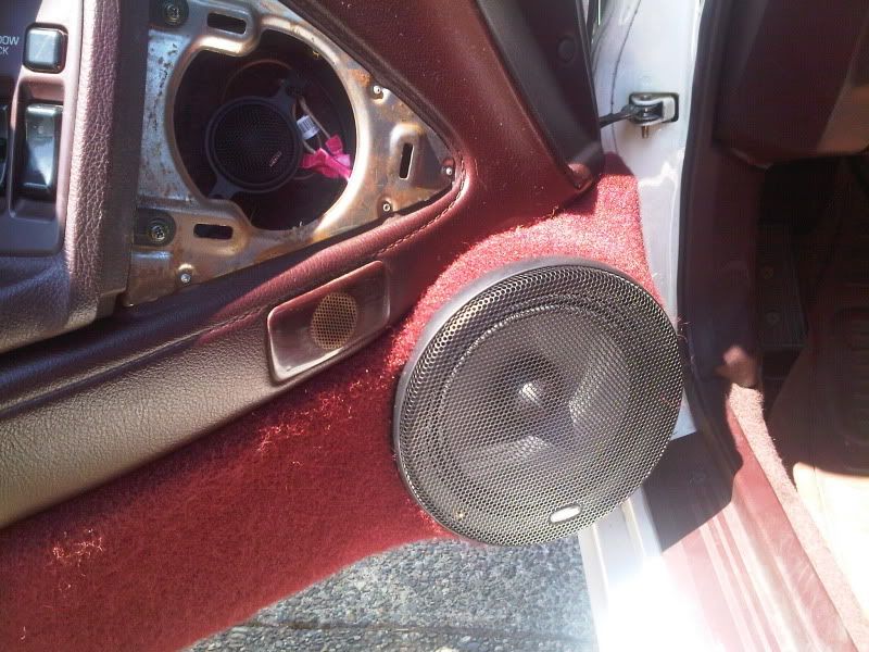

When the door is closed, does the pod hit your leg? Do you have any pics of the pods before the carpet was added? Wanna make me a set? I gotz da $$$.

umm i didnt make them...but no they dont hit my leg while im driving, but it does hit the door shims sumtimes when i try to close the doors...i dont have any pictures of before it was carpeted either...and im not sure how deep the speakers are...the whole bottom part of the door panel was made as well..but only the pod is fibreglass

i could probably get a set made though...or i could send these ones and get other ones made...probably wouldnt be cheap to ship tho..i need to paint the carpet anyways on these ones as the colour is a little off

the problem is not in the brackets, the problem is that only 40 or so % of the woofers surface has a direct path to the cars interior through the tiny opening of the stock panel for 4" driver, and the the rest of the woofer is firing in to the wall of the panel distributing sound into the space of the door, thus, mixing front and rear outputs of the woofer and defeating the purpose of free air application.

Look how Tekdeus installed his speakers, thats one proper way. And the other is this other guy in this thread with glass-fiber pods in the carpeted area. if you leave the 4" boxes and put some nice woofers there, cross them over at 200hz at 6db at the bottom and make the lower speakers (in the carpeted area) play between 4000 hz at 18db on the top and 80hz at 24db on the bottom you'll get a very nice 3 way system that does not entertain you feet or the back of your head with all the directional highs. in other words its not going to pull your attention to the floor or the back delivering the details from where they should be coming from -the front at the head level.
