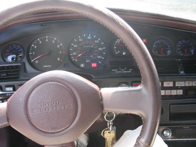

Might have been mine:
They're 60mm premiums, bezels painted black. I think I got the grommets at home depot or autozone. I may eventually replace them with the same kind of grommet around the trip reset. Can't comment on glare with the top off or anything yet as I haven't driven the car at all since the install.
:love::love:
That's what I'm frikkin talkin about right there. :icon_bigg
do you have a write up of how you did the grommets in the plexiglass?
I'd like to see what Jaguar_5 is talking about too.
The Dude
no more supra
186
Okinawa, Japan
First thing, I bought a new plexiglass/vent piece from Toyota, my a/c vent clips were all broken off and zero scratches is a beautiful thing. I practiced alignment and drilling of the holes on my old piece. I can't remember the drill bit size(3/8"?) I used, thickness of the grommets will also factor into that. You need to go slow because 1. hot melted plastic is not fun on your skin and 2. the heat from a high rpm drill can warp the plexiglass pretty easily and turn a circle into an oval. Then just put the grommets on. They have a notch along the middle so they wrap on each side of the plastic and stay in place themselves. Really simple stuff.
Making room for the gauges is another story, a lot of trimming and trial and error fitting is needed even with the premiums shallow mounting depth. Get them mounted in the black bezel first then try to mat the the two gauge pieces together and you'll see where you'll need to begin trimming. Good luck.
P.S. Of course you'll need to get the gauges situated first before attempting the push button holes in the plexiglass.
