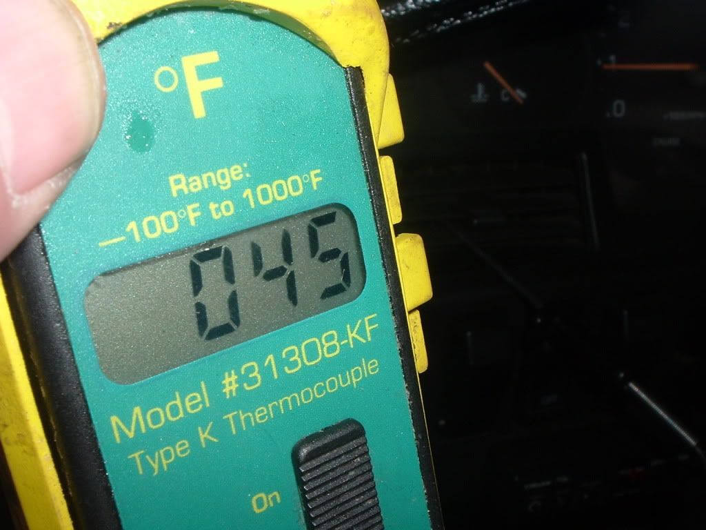

Im not sure where you guys are at in this conversation but I just had my OEM system charged up with R134 and it blows nice and cold. We first pulled a vacuum (fixed one leaking oring) then put a can of R134 oil converter stuff in then put in around 1.32-1.35 lbs of R134. Proof is in the pic ;) When I put the probe in it was at 42 degrees, by the time I turned on the camera and turned on micro, the compressor was already kicking in and out and went up to 45, still nice and cold.
I guess that is 2 of us now grim, maybe it is the air in Minnesota and we can just do it correct :biglaugh:

Ambinet was only around 75 degrees, idleing with the a/c set to 65 without recirculation on.
Edit: after reading some of the threads, The vacuum was pulled down to 26-27 in/hg if that make any differance
