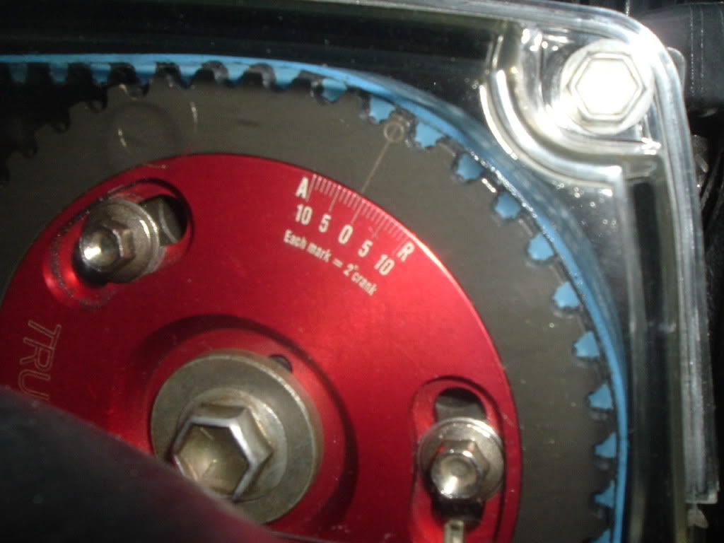

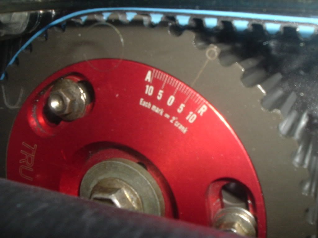

Here are pics of he cam gears, I just took them.
Intake cam
Exhaust cam

^^^ yep look to be around 8 degrees.
What would you do on adjusting the cams? Do all on one gear/cam, if so witch one, split the difference, 4 degrees each. Last option 5 on intake and 3 degrees on exhaust?
63
I tend to run 112 to 114 lobe centres on Turbo engines Rob, makes them idle much better, I split the difference between the 2 cams so you don't end up smacking a valve on a piston.

Ok so the intake would be right about the 0 mark then and the exhaust will be around the second mark on the retard side, if im understanding you correct.

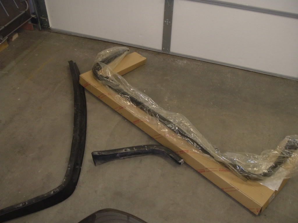

Do you know what the Toyota part number is for that lip? Thanks.
Not off hand it is listed a couple times some where in this thread. I will have to look threw the posts to find it. IIRC there are 2 or 3 left in the U.S
