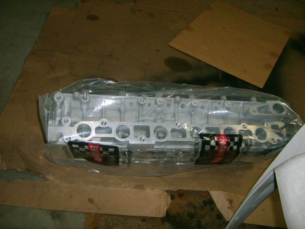

Got pictures of the combustion chamber? You know, the bowl blend? I would like to see how it was redone, and the bigger valves. :)
92nsx
Sep 30, 2005
2,957
Clearwater, MN
I do some where. But I just searched my memorie card and those pics are not on it. This means it is on another SD card that is somewhere, let me do some searching for it.
EDIT: I found the card and no pic of the bottom:( I only took pics of the runners)
This is the only pic I have that sort of shows the bottom of the head. I know not any help
