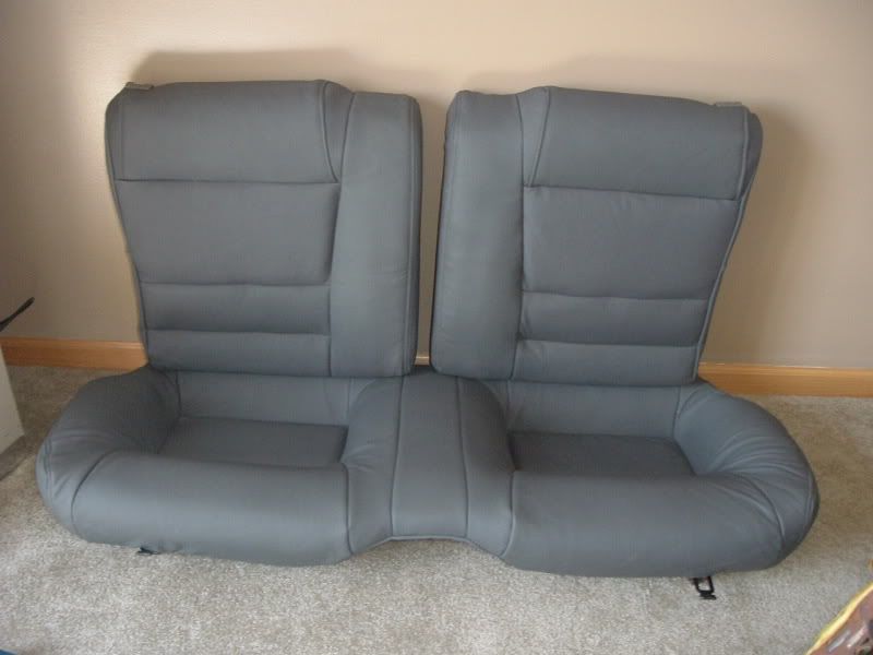

Well this morning I got the new skins on the rear seats and they are looking good. The leather is a little darker then OEM but I like it darker. We will see what it looks like once installed in the car next to little leather piece on the rear trim area for the back rest.
Time to give my hands a rest from all the hog rings, then on to the front seats. They should be done yet today :)

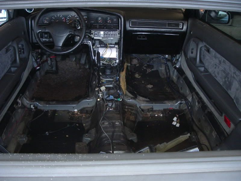

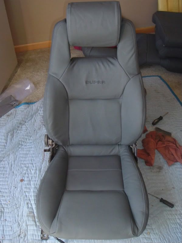

Well all seats are done and time to let tem sit in the sun for a wile, and put the interior back together. I also took out the carpet and took it down to the local laundry mat for a little cleaning. It is not perfect but it came out a lot cleaner. Now time to bust out the vacuum and do a lilttle cleaning, tie up RCA and video cables, and run a new switched 12V for the heated seats. Any one know if the OEM amp under the passenger seat had a switched 12V, that I can use for power on the seats?

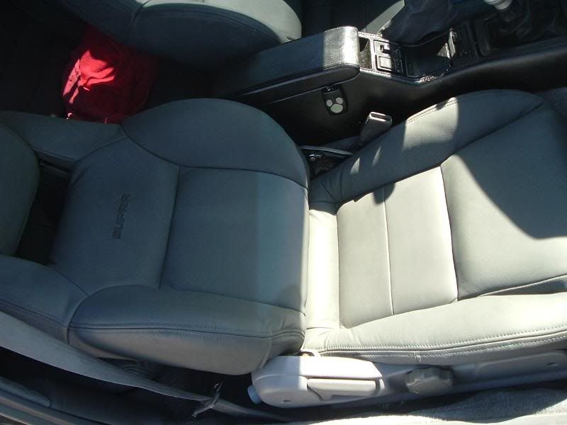

You guys are ROFL. Advans are coming close to the end, since funky's supra is getting close to being back on the road. Then the sawblades go back on and those are full of more fail :cry:. Never the less the interior is all back together and seats are in with the butt heaters working pretty nice ( had to test them out wile in the garage last night) . The switchs for the seats I put behind the shifter. pic later.
Then I noticed my ACC wire going to the amp and inverter wasen't working. So I took out the sat/nav unit ( again ) and turns out one of the wires from my switch came off. And due to the placment of the switch ( so I can turn them off when the engine is not running) I can not put it back on. So now I will either install a new switch in the coin holder next to the fog light switch or just have it like a normal car and have turn on with the key. We'll see what I come up with once I get back out there today.
Here is a quick pic. The wrinkles in the leather are not that bad just the shadows make it look worse. I will get me photos up later

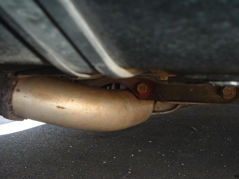

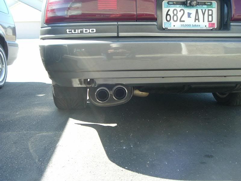

Ok well I have been lazy on getting some pics up so here we go. The exhaust was looked at and re done. First hanging the muffler and tip with the 4 round rings first ( 2 on front and 2 on rear), then bolting up the mid pipe. Well it is better but not straight yet :cry:. I wonder if the downpipe I have has the flange a little off??? any other Ideas on it?

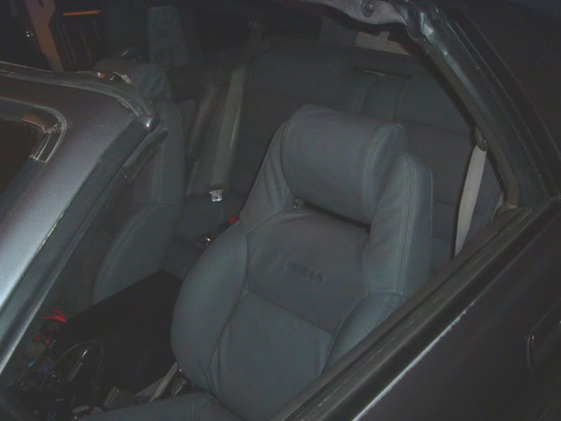

And here are some pics of the leather, and where the heated seat switch is placed. I tapped into the 30A power CB fuse for the lumbar switch for the switched 12 v for them. They work pretty dam nice!! nice warm butt on these cool nights.

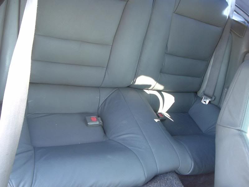

The rear seat was awesome untell it was time to install them. I had to press down on the front of the seat to snap them in and bam! wrinkles on the front of them :( Never the less they look nice, and the supra has a new car smell now.
