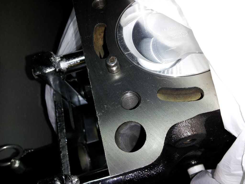

That's a Metal head gasket. I wouldnt be too worried about the hg sealing with that deck surface. It looks smooth enough to me.
Sent from my HTC Droid DNA
They are listing 4 different HG for the MKIII. 3 of them are described as "Metal HG". I guess I will have to call and find out.
(See product screenshot below)
Backlash2032
Sep 20, 2010
1,823
Nebraska
supraguy@aol;1956581 said:
Look at pic #5, post 15.
That's about how mine looked. I'm going to go out on a limb here and say that the picture being taken from top down makes it look worse than it is.
And the titan motorsports headgaskets are metal. Hks gaskets on titan motorsports are also metal.

Well, if you can run the edge of your fingernail over the surface and not hear/feel it, then id say you're ok.
JDMMA70
Dec 4, 2006
2,550
Houston
My deck surface looked similar and it sealed a stopper hg I think its just the lighting because mine was super smooth didn't catch a nail or anything.

Personally, I'd get the RA (roughness average) measured by a machine shop. If they don't have the tool to measure it, I'd be seriously concerned they can make it smooth enough. I'd also do this because I'd be putting in a thick metal head gasket to make up for the material machined off. A composite will increase compression, which will give you more power out of boost, but it'll also be more sensitive to how much boost it'll take before self destructing. I like to stick with lots of safety margin.

Lastly, Titan metal head gaskets are simply Cometic units rebadged. HKS and Greddy are independent manufacturers. Any of them should hold anything a 57 trim can possibly put out. I've popped a Cometic MHG, however, it certainly wasn't with something as small as a 57 trim CT. IMO if you want the best, buy an HKS stopper, but keep in mind it has the toughest smoothness requirements to seal properly.
