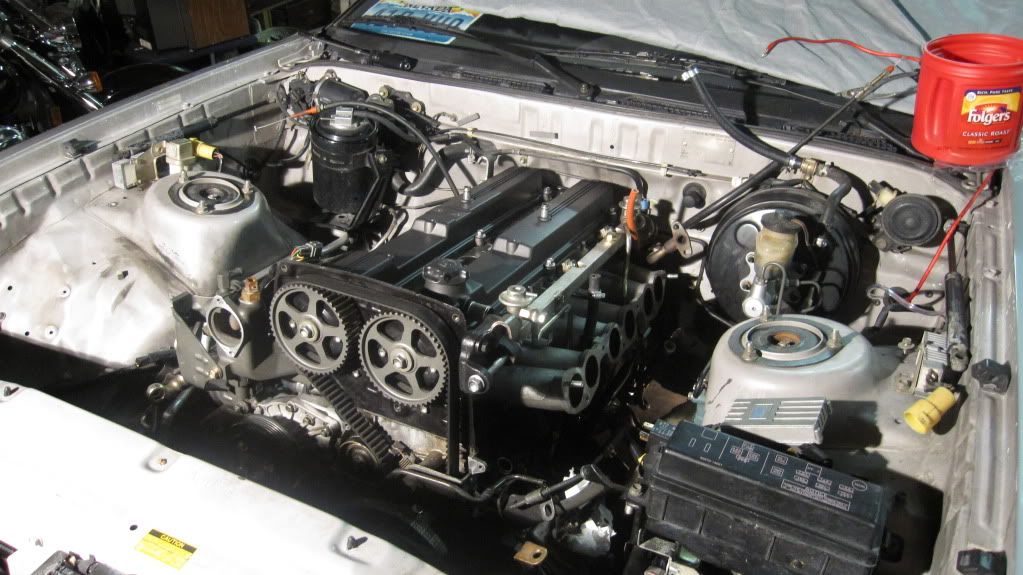

Well got quite a few things done today.. Installed new Thermostat housing, Modified timing cover (half cut and painted Black) Installed new Coolant block/head tube....
Going to take the oil pan to my brothers shop to have the -10 AN bung welded in for the turbo drain I will start bolting on the intake manifold next, fuel rail, wiring harness throttle body, ICS, and then last but not least do the oil drain and feed lines to the turbo and mount up the intercooler/piping! Its getting close :)
Will have pics of it all tomorrow.. Just finished, tired its 2:30 am lol

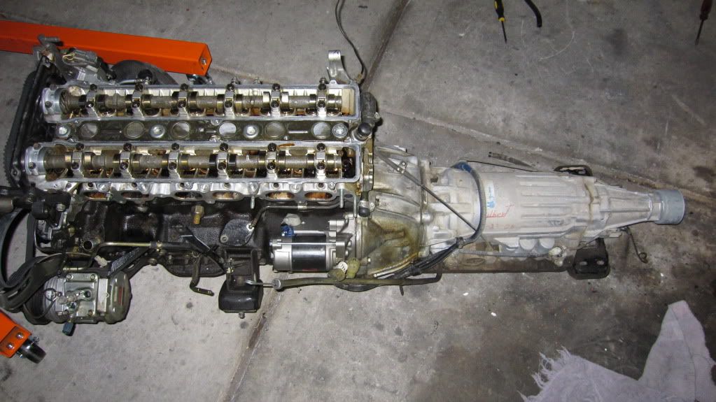

Well tried removing the oil pan in the car and failed miserably.. Tried everything from lowering transmission to jacking the engine up with cross support bar, Couldn't get it to clear the subframe and get passed the oil pick up tube..
Here is the plan!

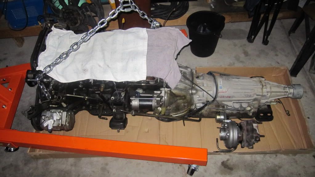

Here are some pics! The intercooler kit is not in stock at drift motion so it didn't ship today! So much for getting it done thursday.. Oh well

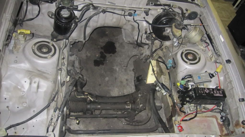

---------- Post added at 08:41 PM ---------- Previous post was at 08:34 PM ----------

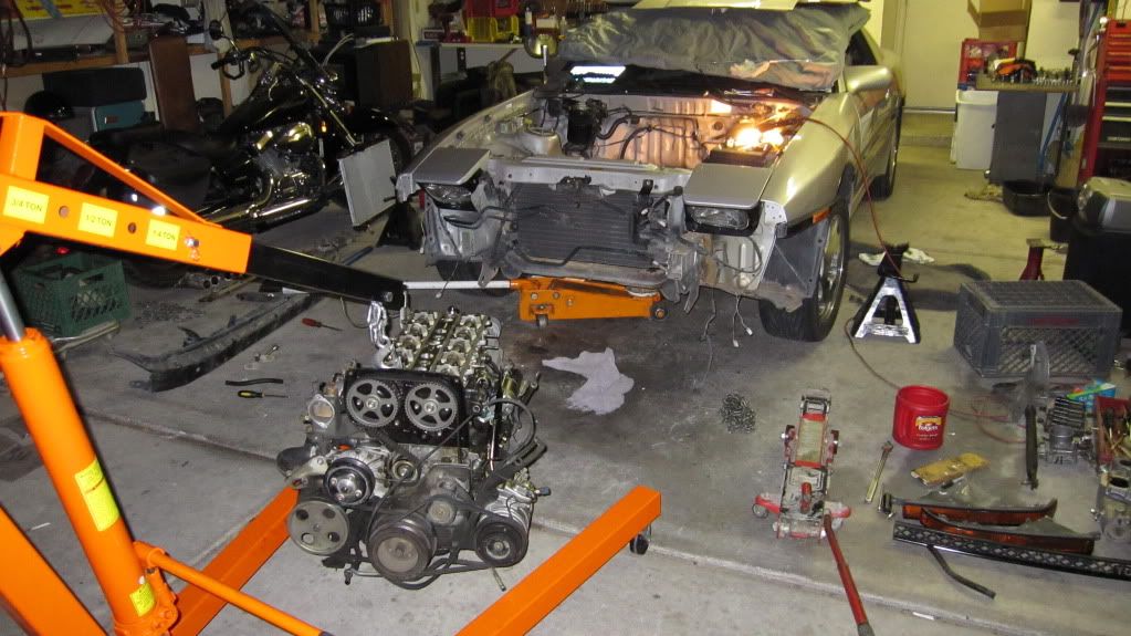

Final resting place for the night...
Engine bay is pretty clean seeing that the engine has never been removed before, Still going to get a cleaning

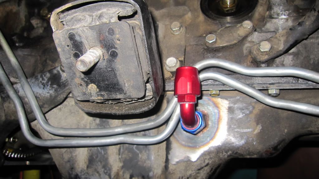

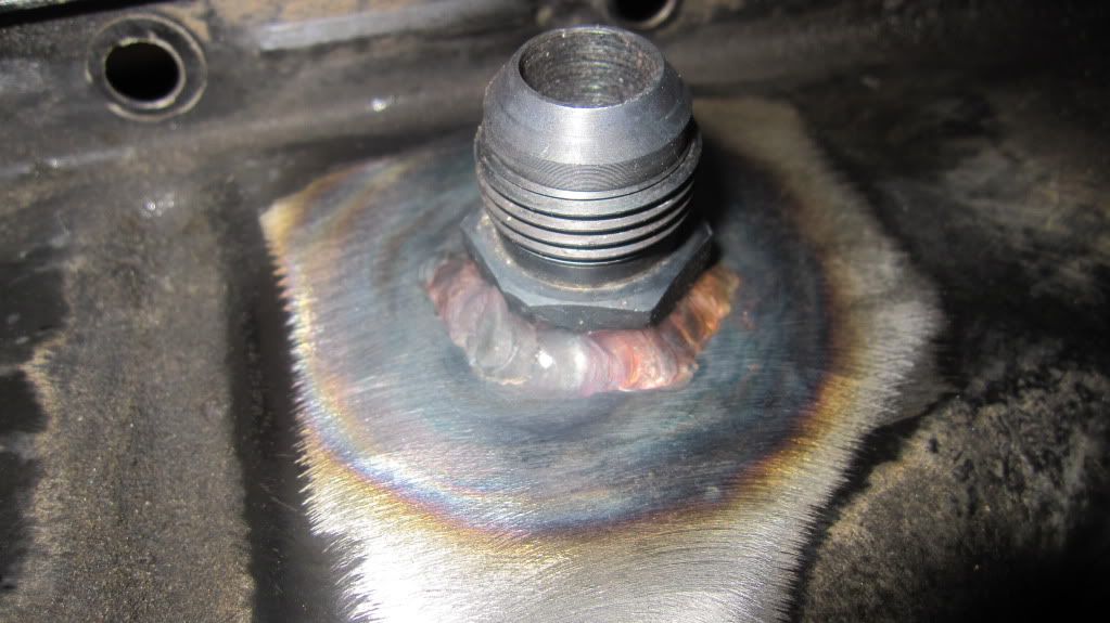

Had my brother tig weld in the oil drain bung into the oil pan.. Put oil pan back up and sealed , letting RTV dry before torquing it down.. Spent about 2 hours re bending the transmission cooler lines to clear the oil drain AN fitting.. Anyways its ready just have to go make the line tomorrow.. Bolted up lower intake manifold and EGR valve, Need to go get Exhaust manifold nuts tomorrow and will bolt the turbo on and do the drain and feed then put the motor back in the car.. I might be temped to bolt on the stock intercooler for now.. Driftmotion doesn't have an intercooler yet so i wont be getting it by this weekend.. Oh well stock will do for now
Also Driftmotion sent a NPT T for the oil feed.. But it needs to be BSPT.. Im going to have to try and see if someone local has a BSPT-NPT adaptor..
TIG FTMFW

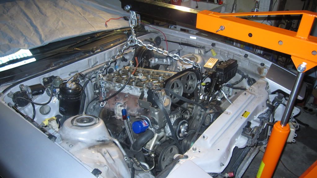

Progress! Got the oil lines all done and made up today, Exhaust manifold on, Engine back in and all tightened down.. Just have to put the driveshaft back in but waiting to see if I can get a center bearing for it first! Mine is really bad...
Driftmotion was able to ship my Intercooler, piping and BOV today so I will have it tomorrow! Planning on having it running tomorrow night hopefully!
