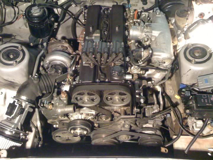

Here is where it stands now.. Was up till 4:30 am and woke up at 9 am.. Working again... Need to get the wiring harness in next

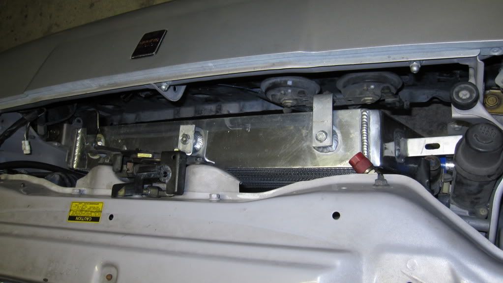

Its 4:25 am and I have had about 3 hours sleep been working since 9 am yesterday.. Waking up at 8 am in 4 hours to finish up and dyno tune! Just have to put the hood and bumper on tomorrow but Im going to get everything tweaked before hand.. Going to rock no bumper cover to show off the front mount for a day or so :p

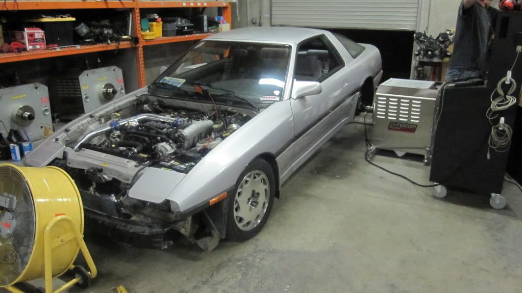

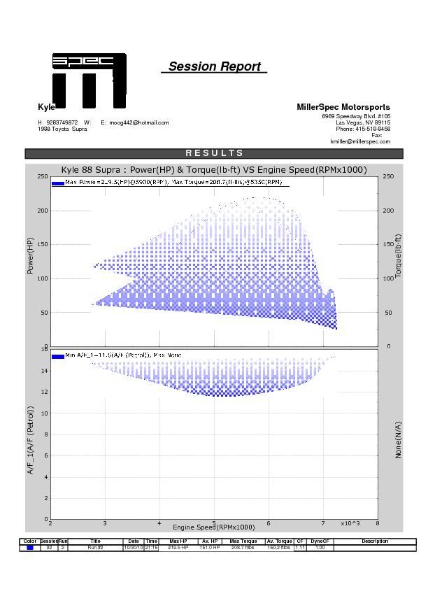

Well its done! There is one leak at the power steering banjo hose that needs to be fixed but thats it.. I dyno'd it today at 9 lbs boost, pump gas, 10 degree's timing and made 219 WHP 208WTQ
AFR's were tuned to be in the mid 11's under full boost.. Car pulls hard, Real hard.. No detonation at all and is running awesome!

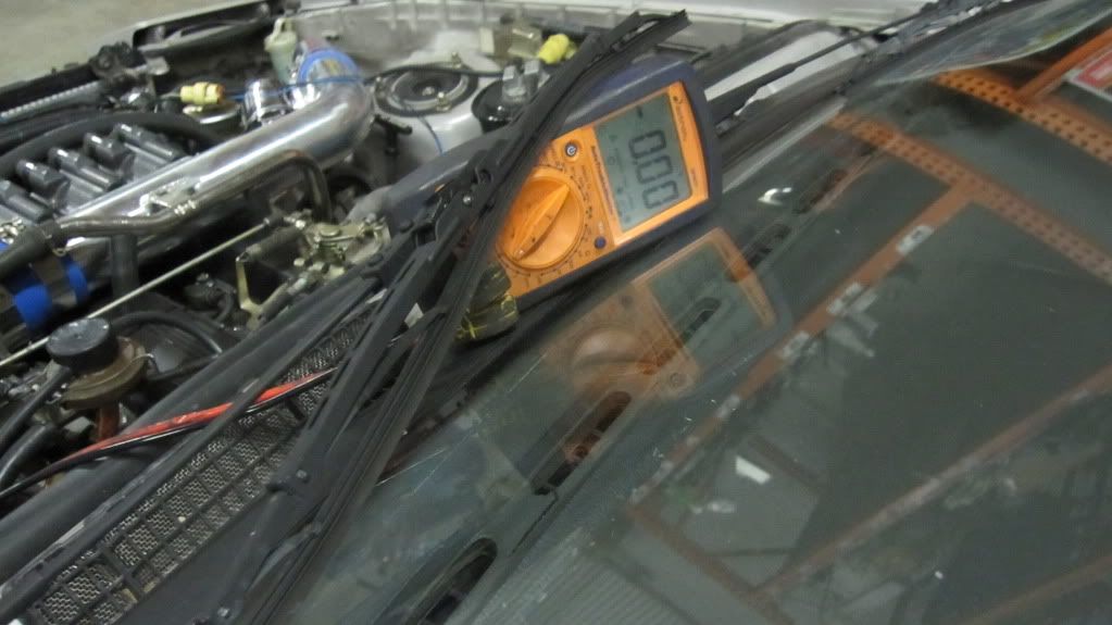

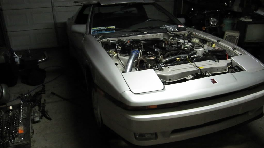

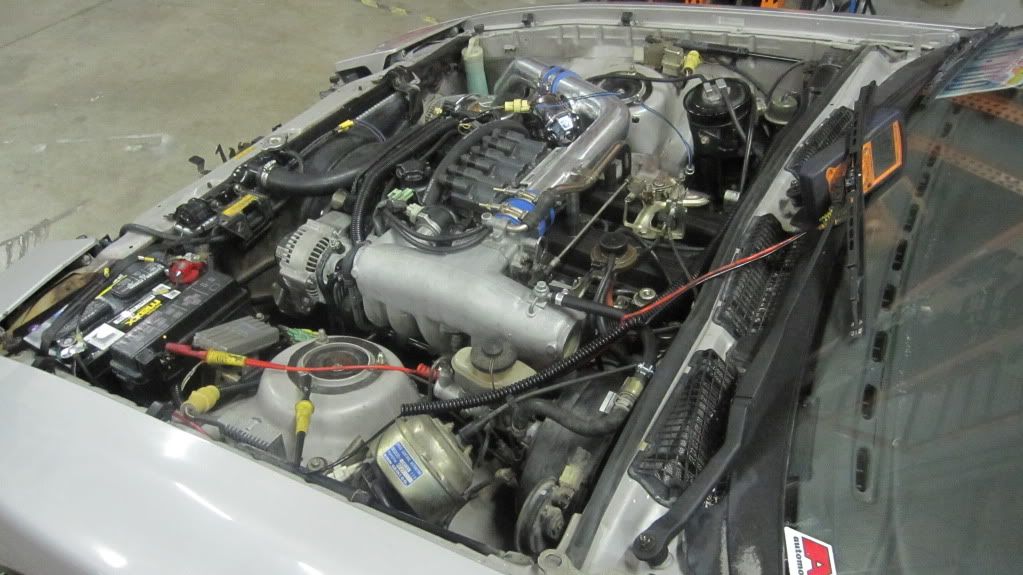

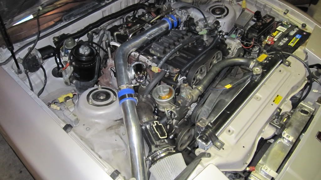

Engine bay
Hooked up to read VF fuel trim correction, make sure running happy
On the Dyno

Ok, So dyno numbers are WAY off due to three things.. Doing the run in 2nd gear (not 1:1 ratio).. Not having enough load to build boost before the run was over.. And the torque converter not being locked up..
What I have done to fix this (Unplug the automatic transmission ECT computer, This allows us to run it in 3rd gear with no kick down when we go WOT
I have also found the pin out on the transmission connector that goes to the torque converter lock up solenoid and wired a external switch to it so we can lock the torque converter at 2500 rpms when the dyno test starts
I also changed my fuel filter today and hooked up the fuel pressure VSV, Going to do the 12V mod so the fuel pump runs at that all the time.. Numbers should be close to 280+ tomorrow

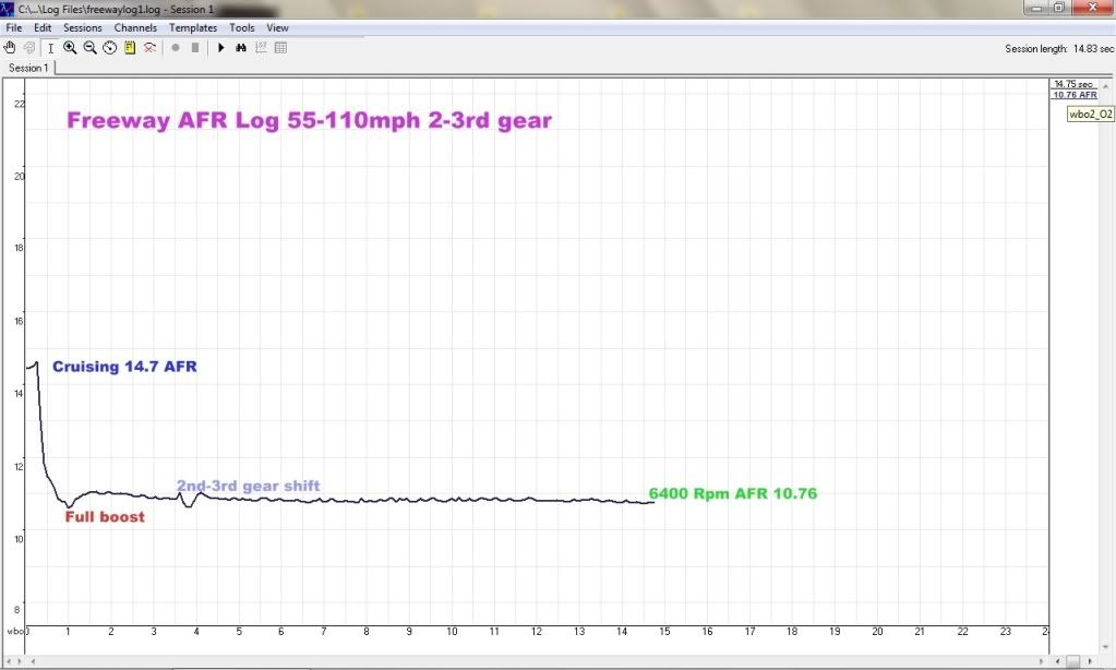

Boobies!=WIN :) So I have most of my info on the turbo stuff in the 7MGE section.. But here are a few pics to update to my build thread! :) Haven't had a chance to redo the dyno due to sema taking place last week but now that it is over should have time to do it this week...
Here is my rich ass AFR's Time to fix that, Once I get my new neo from Apexi!

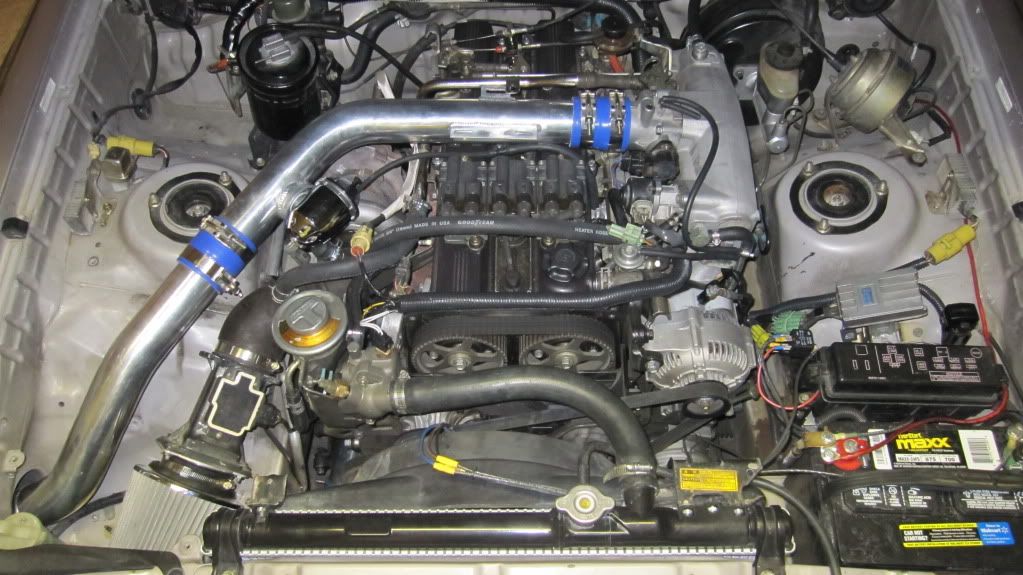

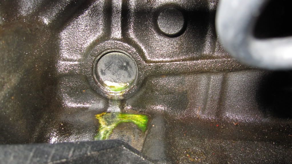

The leak was the freeze plug, rusted through.. I replaced the freeze plug today was able to get it in by just pulling the battery and alternator out.. The seals in my turbo decided to go (225,000 miles on it) So the car is all apart again..

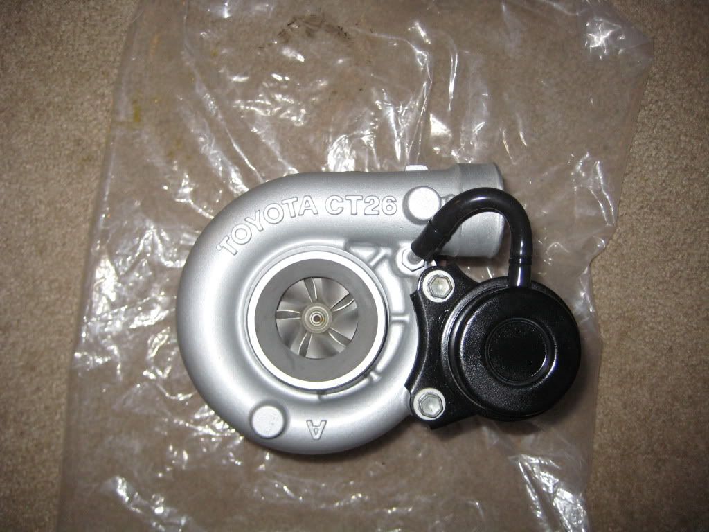

I picked up a Automatic GTE throttle body and bracket so I can hook my line pressure cable up how its supposed to be.. I was having problems with the valve covers leaking so ordered new gaskets and rubber bolt washers. Got all new turbo gaskets on the way as well as a new CT26 that was recently rebuilt that I bought off another member on here..

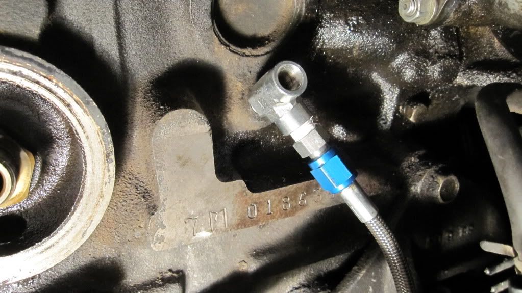

Re did the turbo oil feed line as it has a small leak.. Waiting on the new pressure sending unit for my new gauge's..

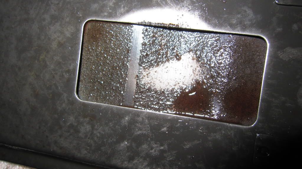

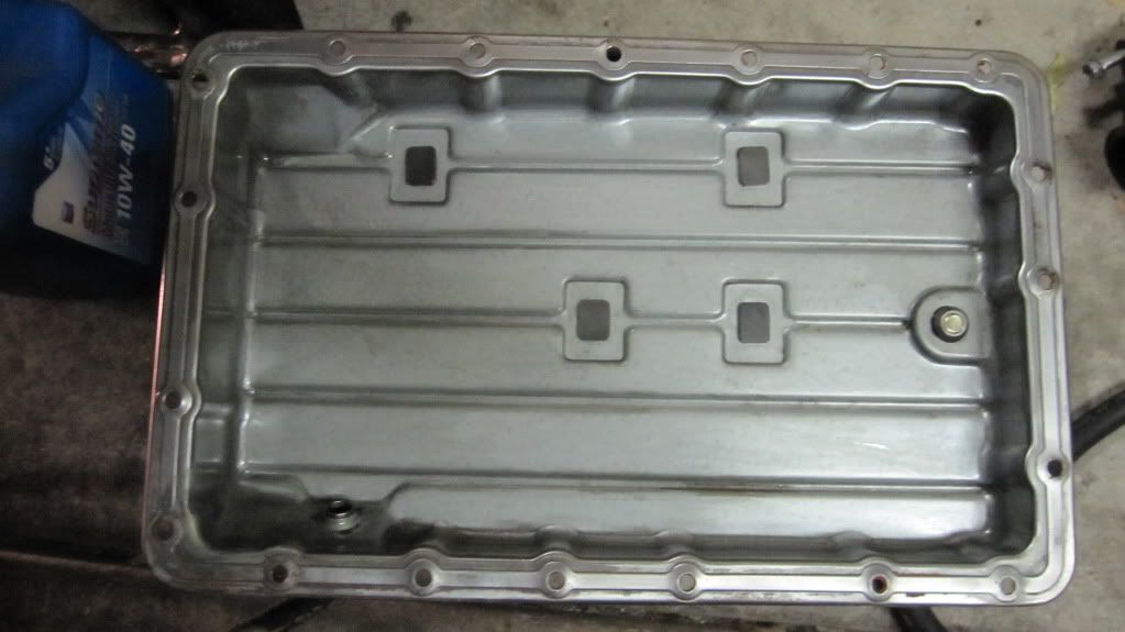

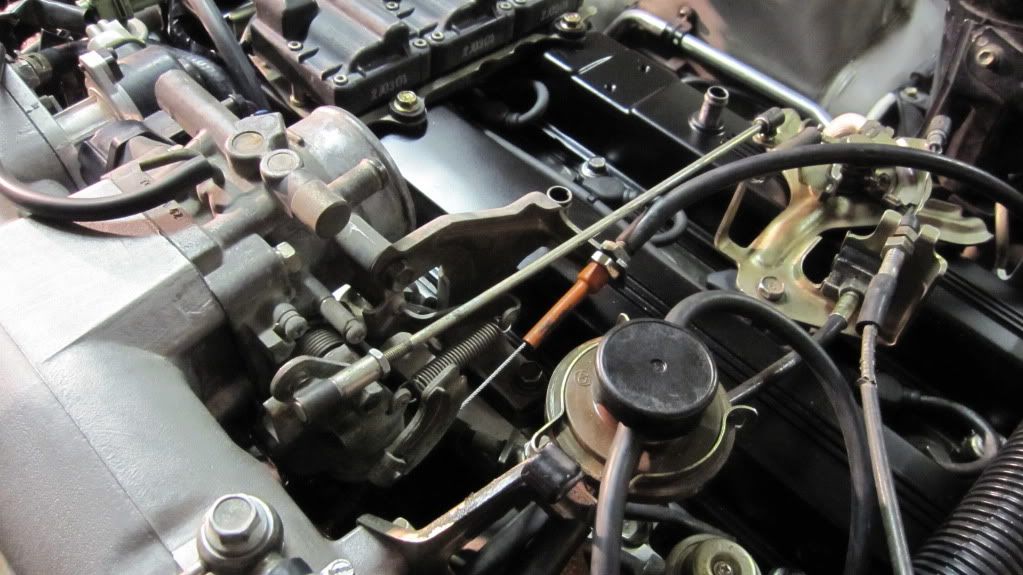

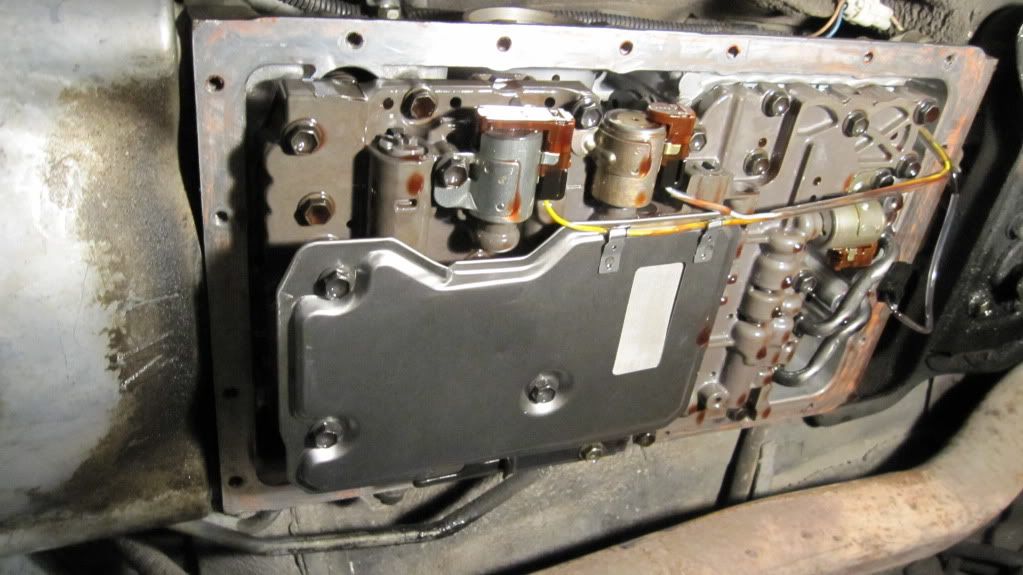

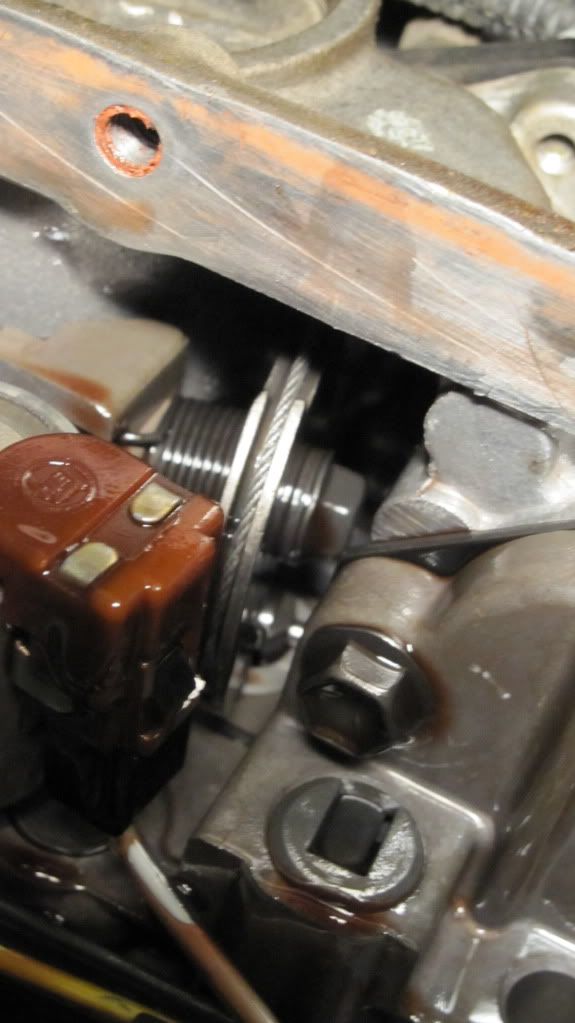

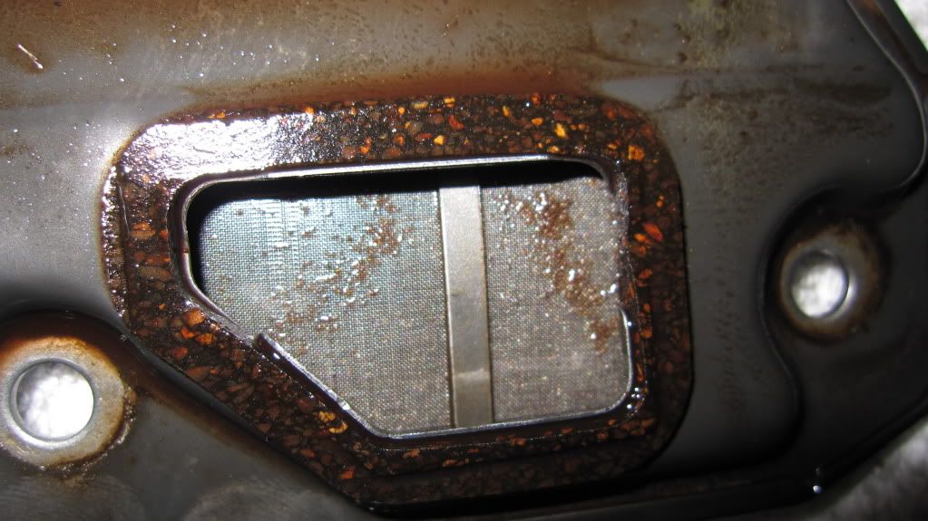

Today I was installing the new throttle body and adjusting the line pressure cable for the A/T's when it got stuck in the full position.. I started to wiggle it and push slightly on it and it popped off the cam inside the transmission.. fuck.. So I pulled the pan off the transmission and sure enough the cable came out of place, so I put it back in, I replaced the filter and gasket as the filter was quite dirty.. :/ Cleaned the pan and magnets and put it all back together
Line that popped off the cam
New filter, Also pulled out the lock up solenoid and cleaned it and checked it to make sure it was functioning properly
Nice and clean
New linkage setup..

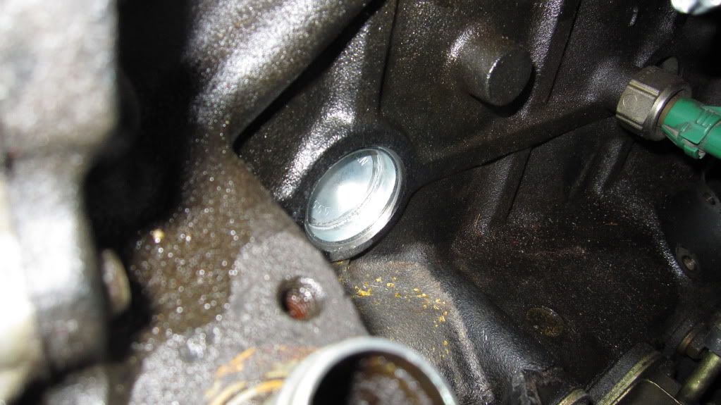

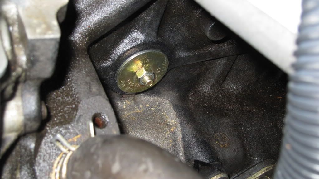

Got the turbo today and installed it, Finished up everything pertaining to the engine, Started it up and test drove it.. 5 min into the test drive I was going around a corner and punched it, spun in 1st as normal and a little in 2nd then started getting sideways and poring smoke out in 2nd.. I let off, My dad was in the car with me and said there was fluid on the ground and I was making a trail.. Already 40 feet long.. lol I killed the motor right away because the first thing I though was oil, pulled over and got out to find coolant everywhere.. That freeze plug I just put in had blown out.. After reading up on here, dorman freeze plugs are a big nono and common for them to blow out due to their slightly smaller size.. So I pulled the alternator off and battery out and replaced it with a rubber expandable one which will be fine.. In vegas it doesn't get that cold often lol
End of the day 4:20 am car drives good and I notice it takes a lot less time for it to engage into gear and shifts are firmer! That filter really made a big difference! Pulls hard with the new turbo and cant wait to up the boost a little and tune it.. I don't know maybe ill just tune it on what its at now.. 8-9lbs
The freeze plug I put in
It blew out so put this in.. I like it, I don't know why lol works good
The new turbo

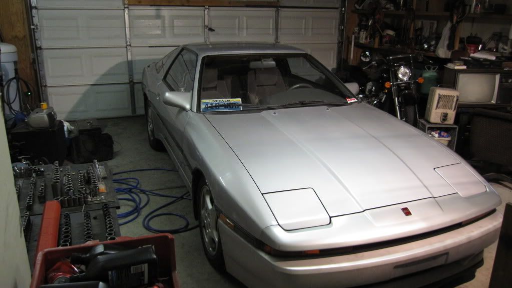

All finished for the night 4:20 am I am to into my supra, oh well I love it :)
