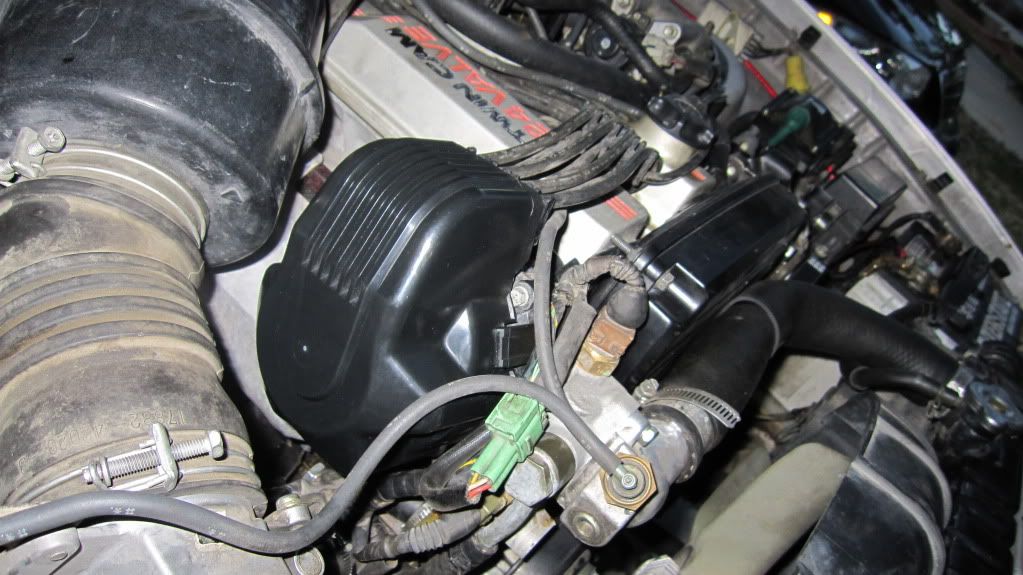

Well today I put a new radiator cap on. The original ones seals were cracked and not holding enough to keep coolant in the upper radiator hose. Now everything is good! I also put on my original Distributor cover! Un-cracked and un-painted! Its in mint condition!

lol some cleaning of the surrounding engine wouldnt hurt :) :rofl:
Devin LeBlanc
Apr 7, 2010
1,830
33
Las Vegas NV.
Yeah, I got to do the intake pipe! But I have a cold air intake im going to put on for shits and giggles! Just need to pick up a new cone filter. I have a spare AFM and the adaptor plate already!

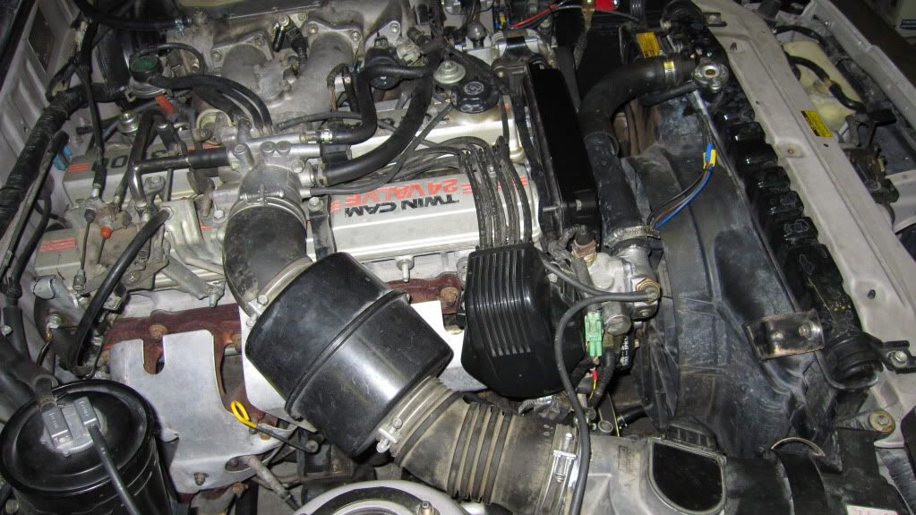

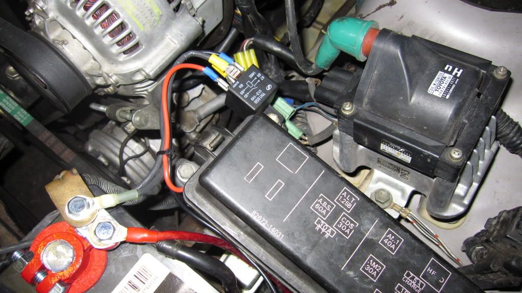

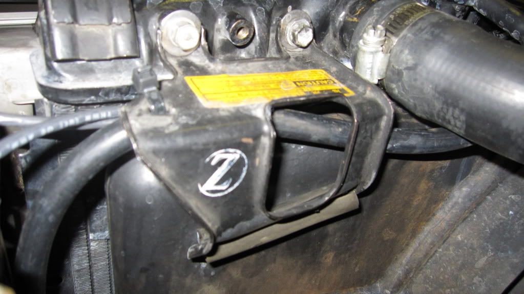

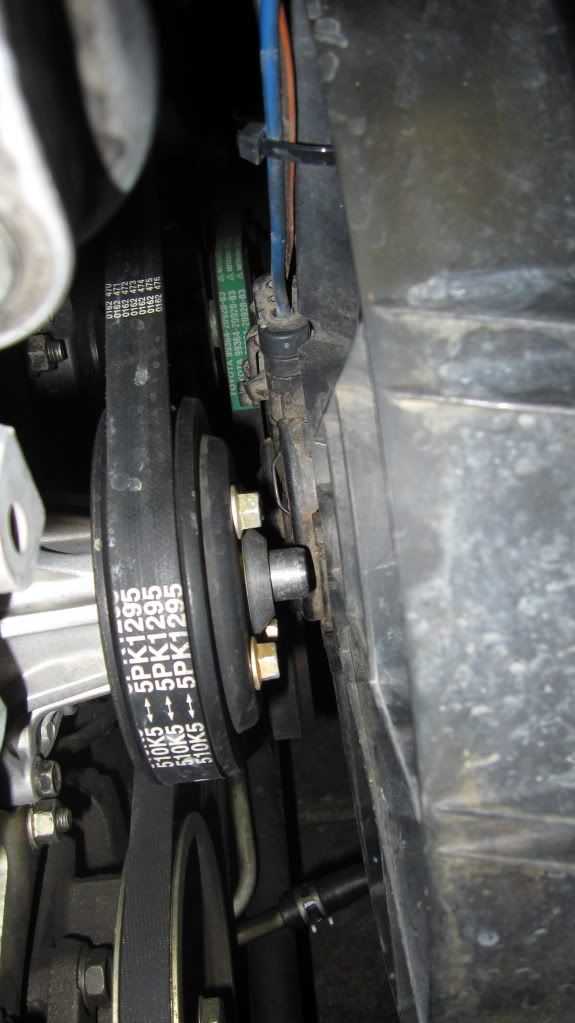

Small update guys, Nothing big really going on. I changed the water pump, back flushed the block due to having some over heating issues. Its not another BHG lol.. I have sourced it to the radiator I think.. I can drive around all day around the city with the AC on and its fine, The minute I get on the freeway it starts to overheat weather the AC is on or off. Anyways, Got a new radiator on the way from rockauto. I have installed a Ford Taurus fan, Which works great while at stop lights becuase it keeps the air moving through the condenser.
Perfect Fit
Water pump Clearance to Fan Motor
Relay setup, Using 10 guage wire, 60 Amp Relay, and got the signal from the Charging system fuse in the fuse box. Even with the key on, wont give 12V untill the engine is running
Modified the Stock A/C Fan bracket to hold the taurus fan/Shroud
Finished product

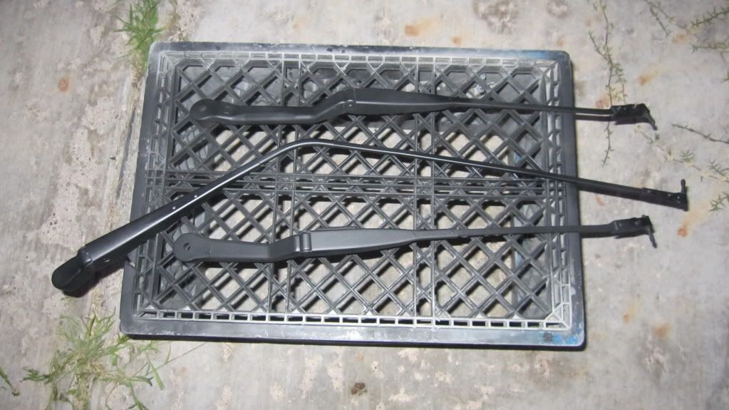

how is that paint holding up on the hatch trim? i want to do it to mine and i was curious how you got off the top piece of trim on the hatch? your help would much be appreciated. also i almost forgot, your car is coming along good man it looks awesome Devin!!
Devin LeBlanc
Apr 7, 2010
1,830
33
Las Vegas NV.
The Trim is holding up great! Looks as good as it did the first day I did it! I have washed the car about 5 times and its sitting out in the vegas heat! Still looking great! For the top peice I did not bother to take it off.. I just masked the surrounding areas off around the car and the window and stuck stick pins in the window squirter for the whiper and painted over it.. Small light coats with satin black matches perfect! :) Thanks for the kind words :)

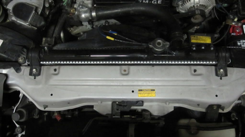

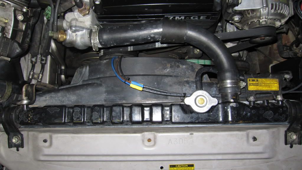

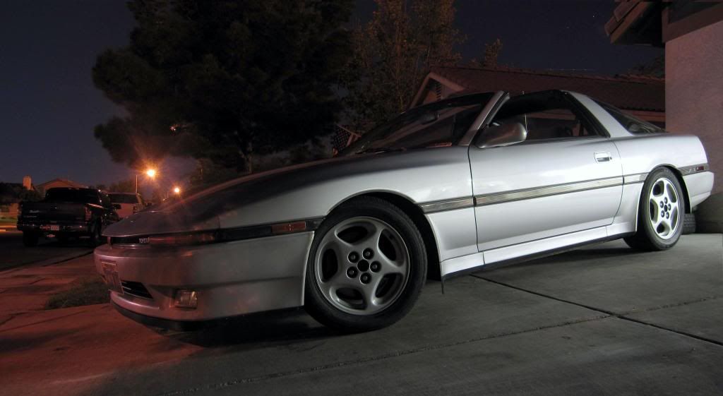

Just a small update, I pulled my radiator out tonight, It is definitly plugged bad.. Finally the source of my over heating problems. My new one from rock auto will be here tomorrow. OEM type, copper core, brass top/bottom tanks with tranny cooler. Can't wait to see the results!
Devin LeBlanc
Apr 7, 2010
1,830
33
Las Vegas NV.

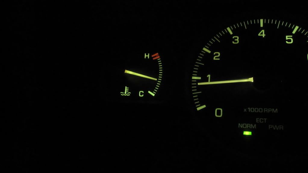

Well I got my radiator today, Not copper core, brass tanks.. Instead Plastic tanks and aluminum core. Aluminum dissipates heat batter anyways! :D Drove it to state line and back, 75 miles on the freeway with the AC on 105F out and no overheating.. Always ran right below half way.
New radiator in
Temp at night with AC on (99F out)

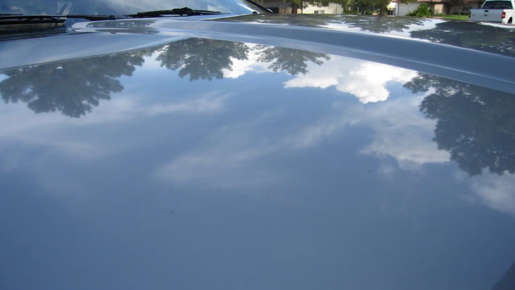

Well not much of an update, Been working on cosmetics lately.. Use of a Daul action polisher and some meguiars products gets you this in about 10 minutes!

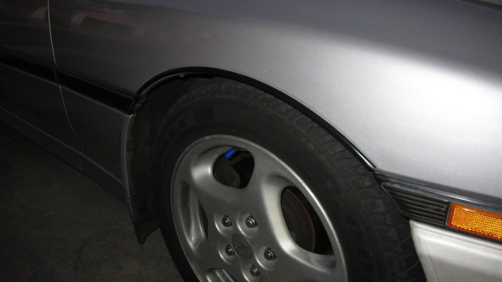

Well remember that perfect paint match on the front lip.. Well lets just say it was an accident with some UV dye.. Did you know that shit eats right through paint like brake fluid? :mad: F*#K

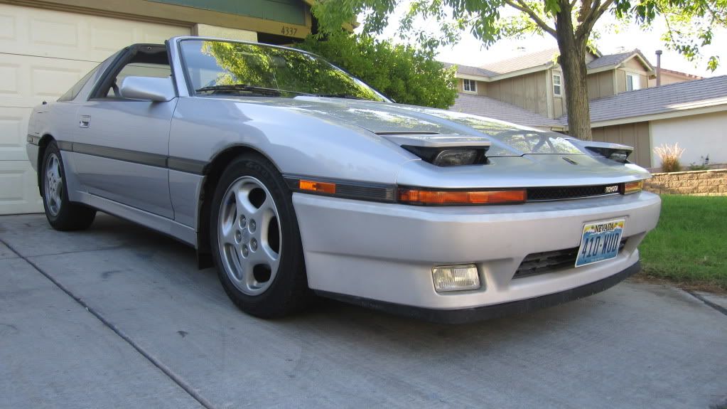

Installed springs today! Im loving it! The above pic was photo shopped.. This is the current unedited status!
Need to get the ballon tires off the rear now...
