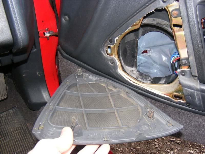

Toyota took 89/90 door panels and they actually cut out the door panel, and affixed (and this is the hard part to replace), new metal brackets to hold the speaker grilles on.
While handles and switch bezels were changed, you can swap them over with no problem...

I have 91-92 speaker pods in my car now behind my 88 panels and sure they work but like whats been said they cover about half the speaker. I think i'm going to investigate putting the 91-92 grills onto my 88 panels

Here you can see how the metal bracket is different, and how the door panel is cut. You could probably cut and fit a 91/92 speaker cover, but the lower parts will not be secured. If anyone wants to try it, I have a spare 91/92 shadow gray speaker cover for sale.
