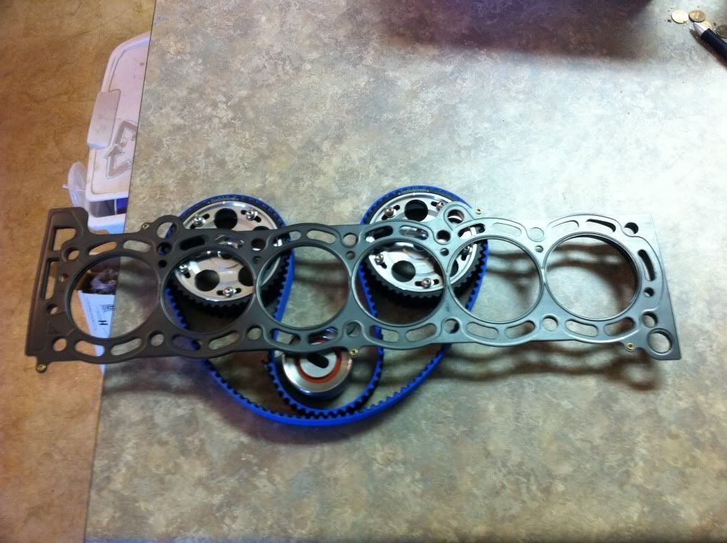

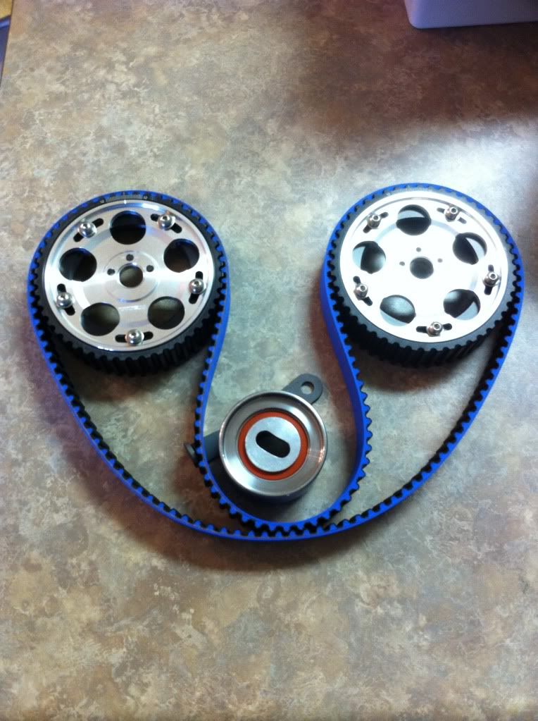

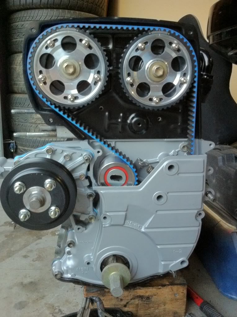

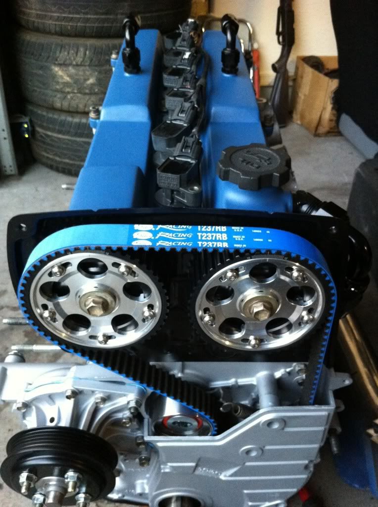

stevenr816;1741170 said:
New parts came in today.
SIP Solid Timing Tensioner
SIP 1.3mm MLS HG
Gates Blue Racing Belt
TMS Adjustable Cam Gears
The solid tensioner looks a million times better then the stock one, any 7m I build will definitely have this on it.

Grandavi;1741338 said:
This is going to be a car to see after... (excuse me while I go hide my huge envy problems)
NICE!!! LOL
Albert;1741287 said:
Andy, You dont need Cam gears reguardless of what brand. The technologly now a days on tuning, you can get more out of a timing tune than trying to adjust Gears in.
Soul Purpose to get Adj Cam gears IMHO is for looks, and looks only.
Thats the only reason I got mine, and only reason steven said he got his. They look 100000000x better tha nthe stockers
I mainly got them for looks yes, but I'm also degreeing my cams in which is what you usually do anyway.......... This is why I installed your cams lol
